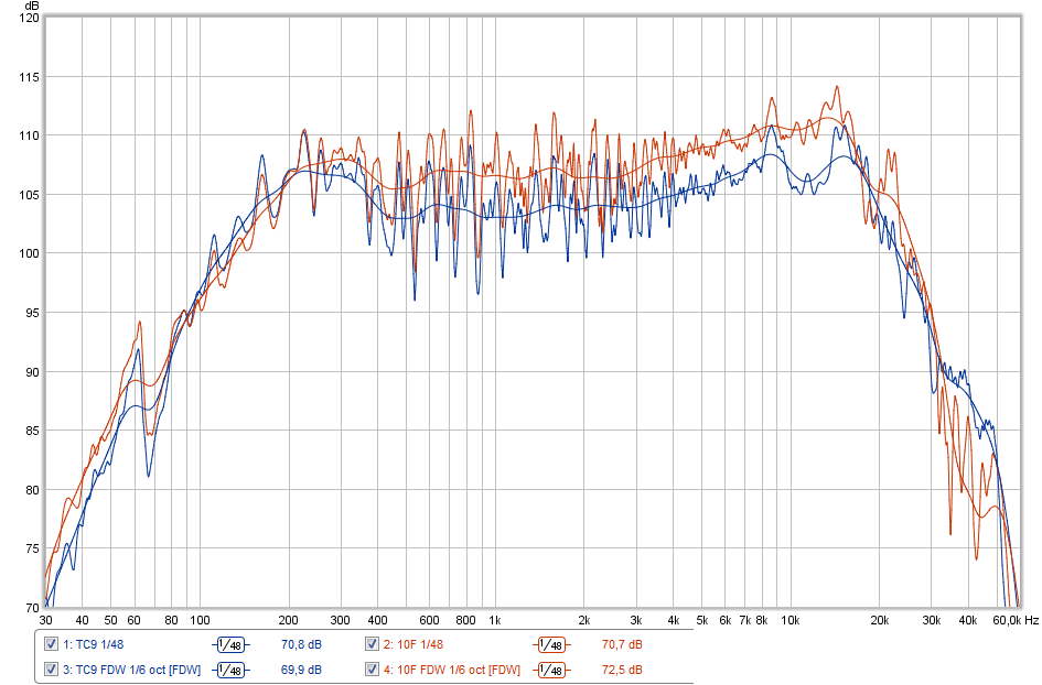

Two reasons posting this data info here, first is because Pano welcome any info for TC9FD18-08, and second is because stumbled over wesayso calling TC9 for 13 years old lady in a PM some time ago and think old lady : ) deserve some praise from time to time, side by side a 6-7 times more expensive 10F/8424 the old lady simply sound and perform great. Both drivers think can do better response and HD than below when their enclosure is more solid and clever constructed in below they were simply non flush mounted on a 160x120cm double layer cardboard baffle, but in conditions were exactly the same think they should be comparable. Had more 2 and 3 incher drivers on that baffle but these two without any correction be it passive or active out of box are the overall best on paper.
They are definitely related. Marvellous to see how that TC9 keeps up!
Not to talk about how acoustic curves looks and sound in your couch.

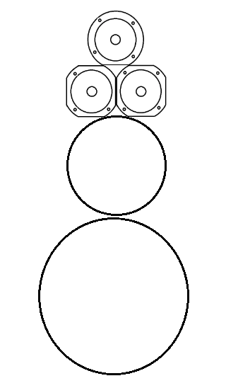

Also had it not be for complicated setup of multiple DAC and numbers of amps guess we could use TC9 in diy mini Beolab 90 clone, below wishful paintbrush is just forward drivers, horizontal arrays are missing

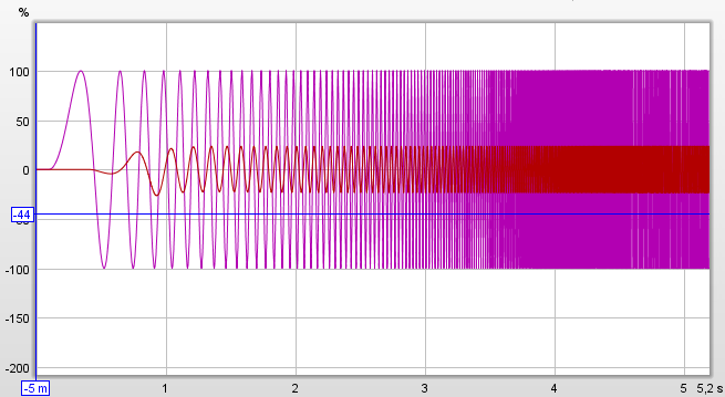

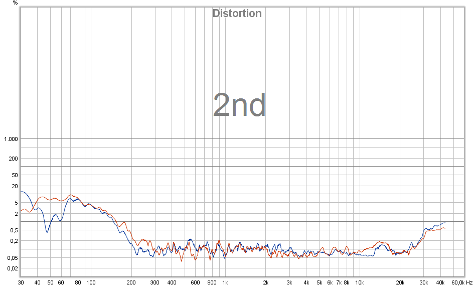

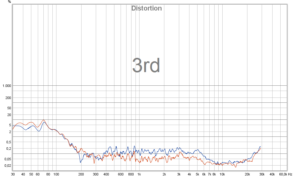

How are those distortion plots generated? Are they close to the max power rating? I wonder if the performance of the TC9 would be even closer to the 10F at lower power, which would be more likely in line array applications. Maybe this is common knowledge that distortion doesn't change with SPL as a percentage of the test signal?
Think of this, whatever level was used in the example from BYRTT, to reach the same level of SPL you'd only need a fraction of that power per driver.
Remember my plots were taken at the listening position, not up close and personal like most people do these charts. They show the results at the spot that matters (to me) and include everything. Even the outside traffic!
Agree in array they probably hardly move, its another story that low distortion clean sound will get foot to move some.
Test was early in the morning last weekend and had to work fast measure 8x devices before people upstairs got out of bed and distort measurments, so never had the time to calibrate real spl, but can say it was very uncomfortable levels wearing industrial earmuffs and REW also show curves up higher than i use to see, but for own internal assessment the same condition was the biggest point for test and should be valid comparable.
