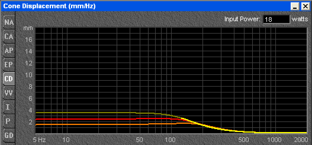

A quick question from a complete audio novice: If the enclosure volume behind each Vifa unit was increased from 2 litres to 4 litres what measurable effect would this have on the very bottom of the frequency response?
In other words would the -3dB point be extended or would there be less frequency response boost needed for the lower end?
Thanks.
You'd need a bit less power on the bottom end to reach the same numbers. Even though I say a bit less, look at the link Perceval added, these numbers rise fast.
I use a liberal amount of stuffing making my enclosure "seem" bigger than it is, confirmed with impedance measurements, but that's not going to make 2 litres turn into into 4 🙂.
Bigger would be better from a bottom end perspective, but the net gain is only marginal once you pass 2 litres. A good simulator software can show you this.

I found that some of the simulators do not seem to like the TS parameters of the TC9 and give some strange results. I had to go up to 400 litres for a single driver to get the Q to be anywhere near 0.8 with Jeff Bagby's woofer simulator. That is in no way to run that spreadsheet down as I have found it to be very accurate in comparison to others with bigger woofers.
The Bassboxx Pro sims I ran seem right to me so I am fairly confident in them at least from a comparative point of view. A 2L effective chamber shows a Q of 0.8 and an F3 of 139Hz which matches pretty well to your actual measurements.
This is the excursion plot to go with the graph I posted on the other thread, as you can see the yellow trace (10 litres) exceeds xmax with a lot less than 18 watts below resonance as there is very little cone control. The box is bigger and more efficient but not well controlled. 4 litres would go somewhere in between the yellow and red.
attachment.php
To me the Qt is too high to go any higher than 2.5L. Maybe if you were trying to use a flea powered SET amp there might be a valid reason but with a solid state amp of 100W or more I don't see the point.
