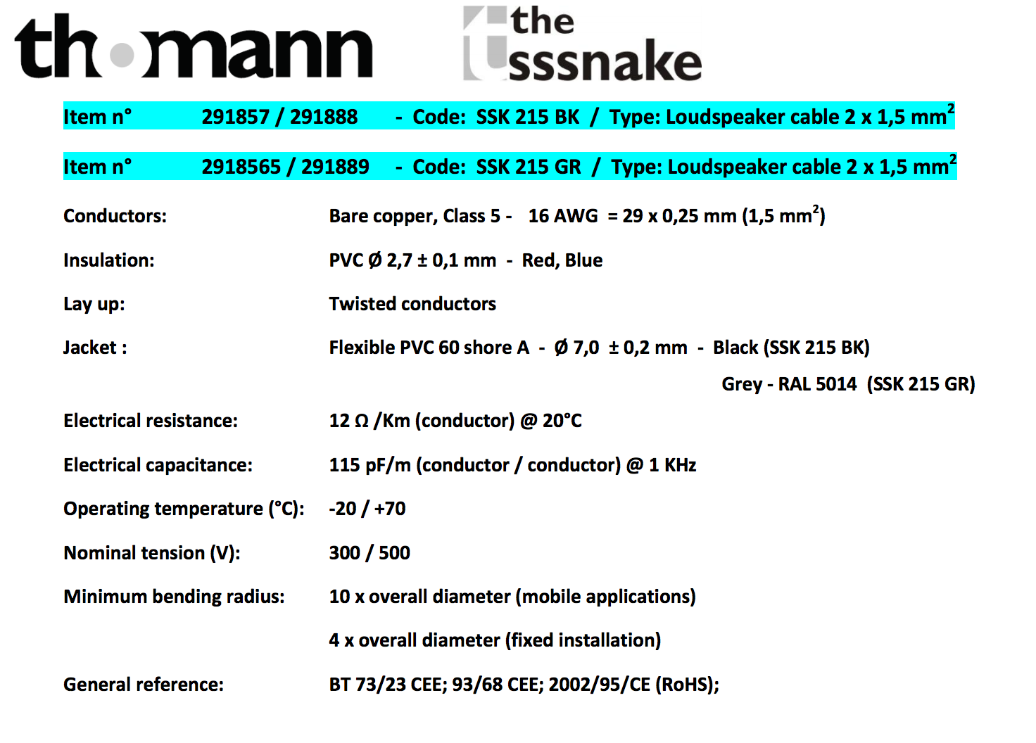

I liked what I saw from the thomann "the sssnake" wire, and may opt for the one step larger size (spk225) as speaker wire and also use it as the main wire leads inside the enclosure. That leaves me to choose the smaller leads to the drivers. So far it seems I'm still choosing 0.25 mm (in multiples) wherever I look. Solid core not being practical in my application.

Both wires I linked were the few that actually show a bit more actual data in the datasheet. Most wires datasheets only show their size.
