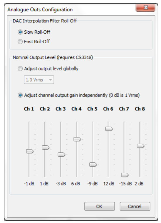

Is that inter channel balance in the digital or analog domain? If it's in the digital domain than it isn't any different from what JRiver has to offer, right?
I can adjust each channel individually and use the overall volume to adjust while keeping the inter channel differences. As I have up till now. Thoug I chose an arbitrary max volume level, made sure to use the dac just below clipping and adjust the analog volume from the amp to set it's max SPL level desired for each pair of channels. Fine tuning and left/right balance happens within JRiver.

It can be digital or analogue, analogue is in 1 dB steps so a combination of both may be required to set an exact level. So it is a bit different.Is that inter channel balance in the digital or analog domain? If it's in the digital domain than it isn't any different from what JRiver has to offer, right?
On the amp I just set it and forget it. In other words I never touch those dials afterwards.
This is what the analogue control panel looks like

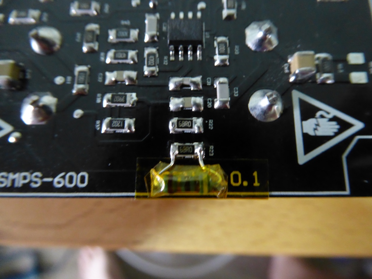

If you use the Hypex power supplies then they have auxiliary regulated supplies on headers that you could use to power the opamp.
Yes, I noticed it being a SMD part. I guess I'll make the amplifier first and check out if and how much attenuation I really need.
The linear cermet pot still sounds like a viable option too as it's a set it and forget it kind of thing. I'll rebalance the line arrays too at that time when I introduce the subs. Maybe it's wise to just build the sub amp first, I've been checking the second hand Pioneer adverts to see if I can find a good case at a reasonable price without having to sacrifice my working ambient amp. That way I can steadily grow into an amp replacement strategy.
