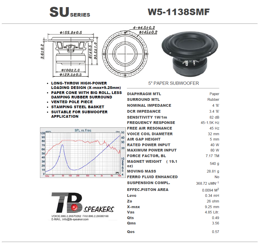

It might make that Tang Band I mentioned earlier more interesting.
For about the price of the 25 Visatons, You'd get 10 of those.
https://www.parts-express.com/tang-band-w6-1139sif-6-1-2-paper-cone-subwoofer-speaker--264-919
Specs:
https://www.parts-express.com/pedocs/specs/264-919-tang-band-w6-1139sif-specifications.pdf
Let's do the math again:
140 x 10 x 11.5 = 16100 (now we're talking!)
Blows the 30w out of the water.... and it features a surround that looks like it could take it .

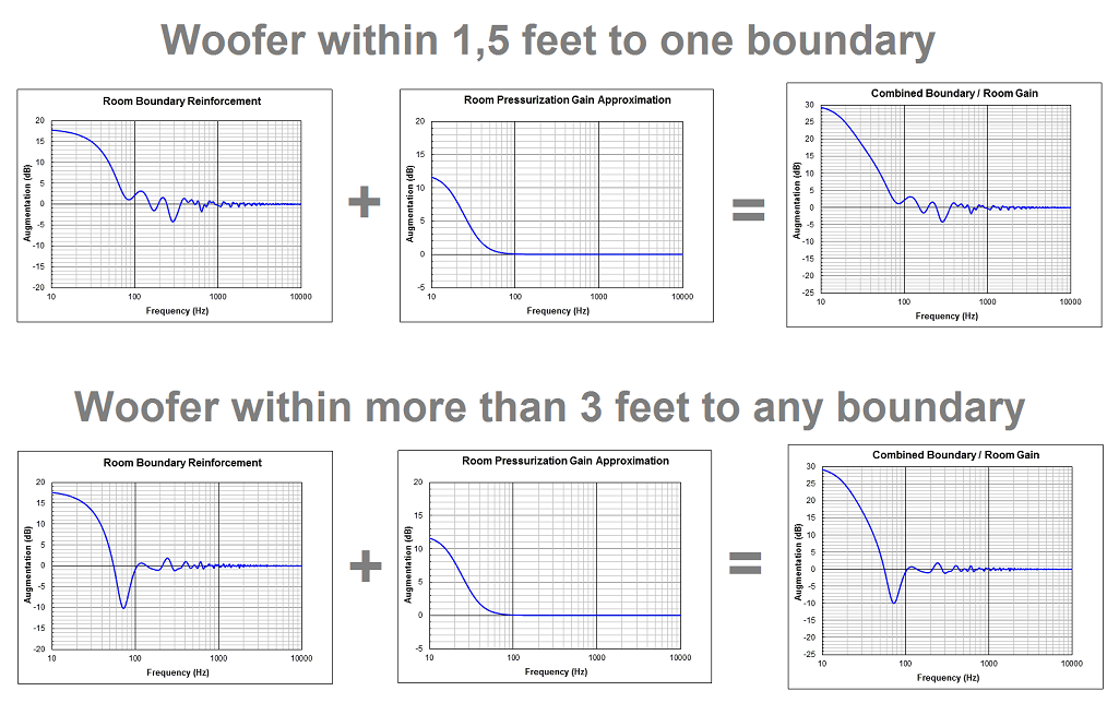

Those little Tang Bands are freaks of nature . I didn't check if they can handle the boost though, thermally.
I assume you want to have these arrays stand freely. My arrays get help from the close boundaries of my room. The pair of 30w's will have that help too.
With free standing speakers you'd need about all the help you can get down low. Would be interesting to see a sim of 10 of these compared to the 30w sub.

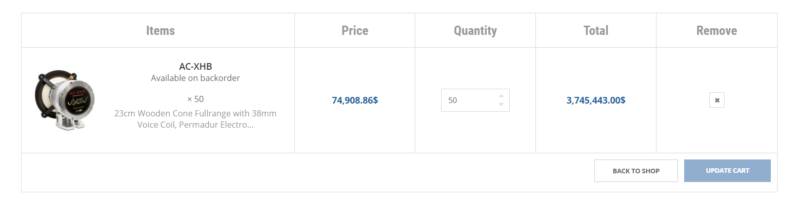

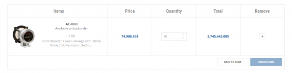

Well you only live once. Just go with 25 of these per side
https://solen.ca/products/speakers/home-speakers/fullranges/ac-xhb/
I just added 50 to cart

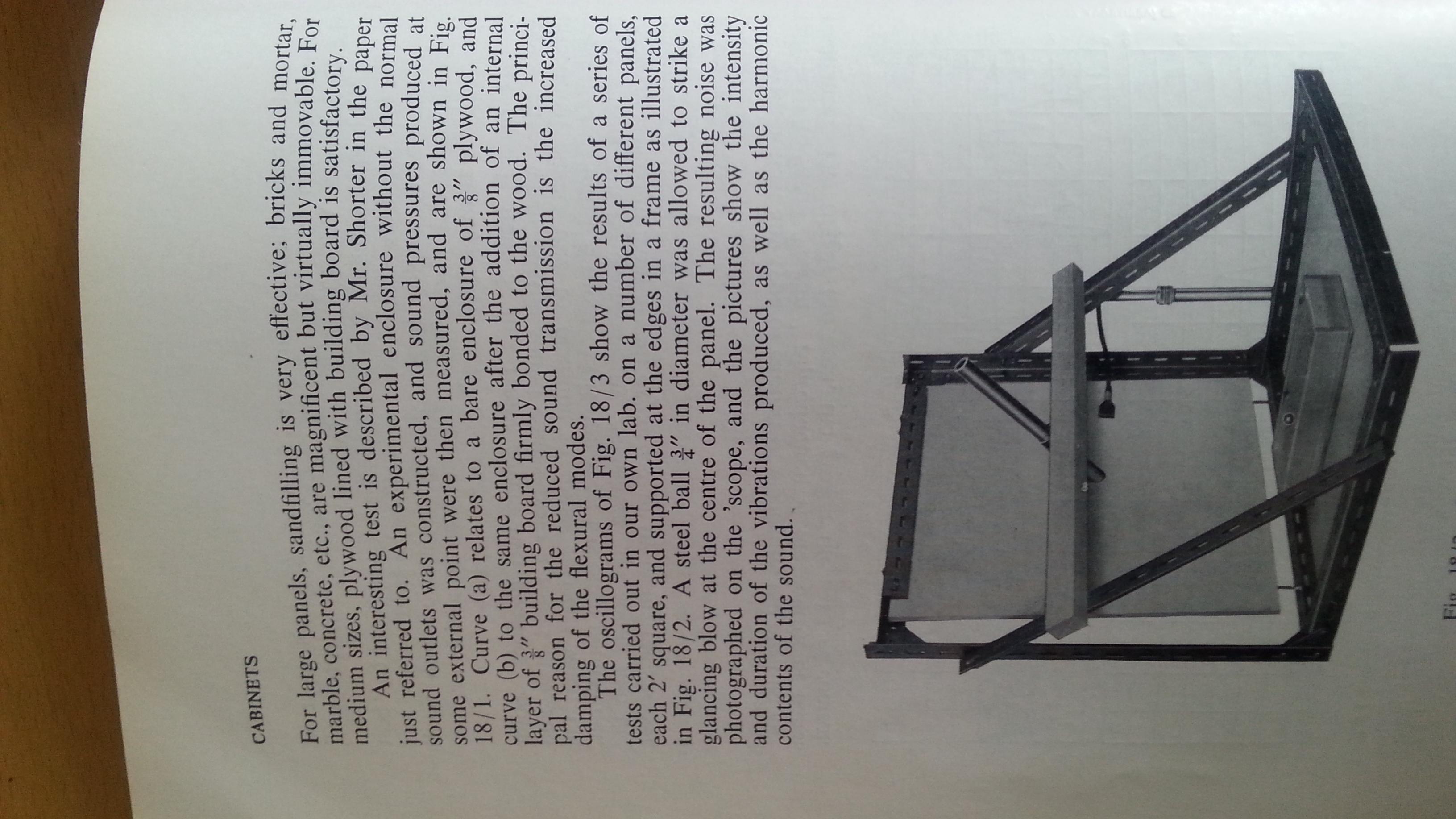

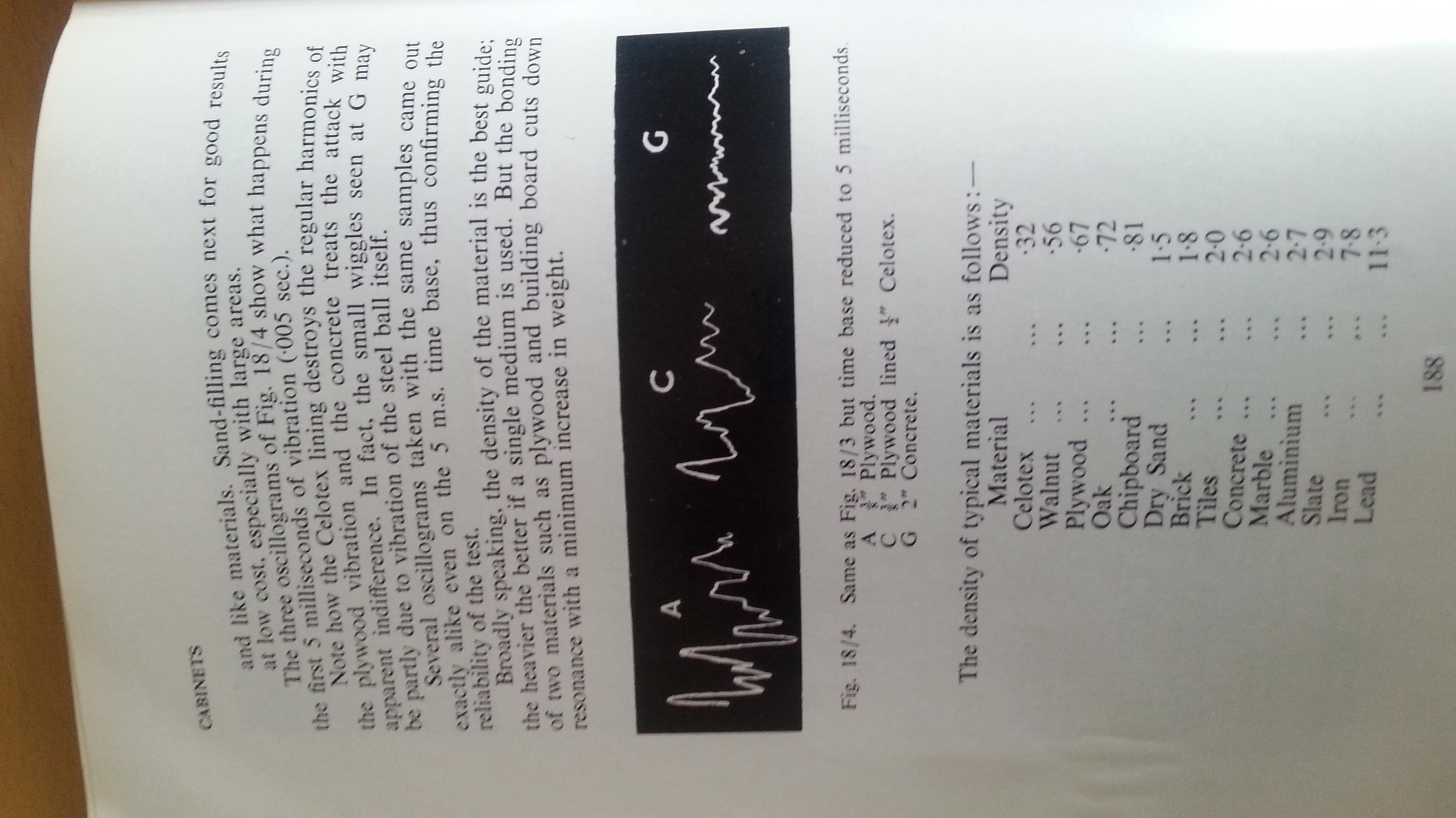

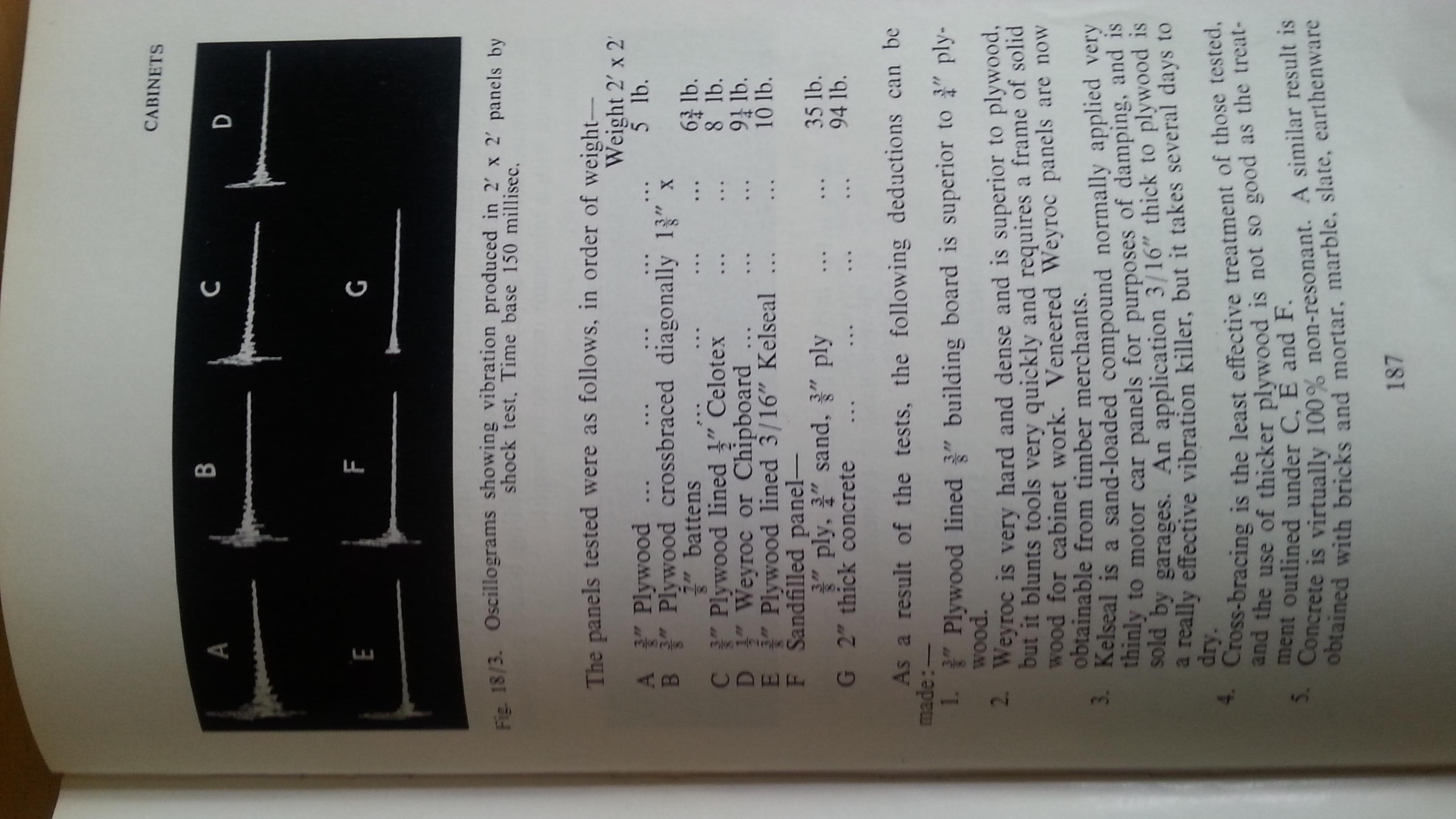

While thinking of how to construct an enclosure sturdy and heavy enough to withstand the forces from the SONIC MK III units, I remembered reading the old book from founder of Wharfedale G.A. Briggs, simply called "loudspeakers "(originally from 1958).
Here he describes different materials and made measurements of them, and one thing I remembered was the next best way to make non- resonant panels , was two thin plywood sides with dry sand in between.
In my case I was thinking about two cardboard moulding tubes , 400mm and 360 mm with sand in between and in each end a SONIC so they are working push pull...
But maybe you could use that technique in your subs , Wesayso?
I have attached the pages from the fine old (almost as old as me) book , hoping I don´t violate any copyrights thereby
