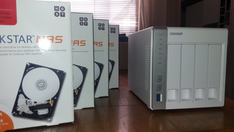

On other related news, the HGST drives are on their way, the WD drives are send back. If I can get more quality for the same dollar/euro I'm all for it.
This data set was convincing, but ultimately it was the specs of the HGST drives that made me switch.
Good to go...

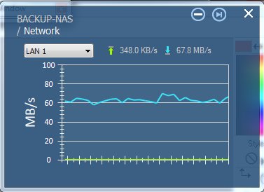

What real world sustained transfer rate can the QNAP (RAID5 ??) manage over your network.
To early to tell yet, at least in a true back-up situation. I'm running one now (full Backup), while using the system. They are connected trough a gigabyte switch, the NAS running Raid5.
While using my PC for work it gets between 60 to 70 Mb/second.
I did get higher numbers when moving (big) files around (moving my movies to the storage). I do not expect wonders though from the cheapest 4 bay NAS.
I'm just trying to get a feel for the length of the back-up process, running a backup every day would require me to run the workstation 24/7.
Still trying to decide what would be reasonable for me. I don't want to have it running when playing movies or music, so I'm opting for a weekly backup each Friday. To be more precise, a monthly full backup with a weekly incremental.
Maybe run a smaller backup (files only) on a daily base for important files.
Yes, I'm not displeased with it. It's more than reasonable for the cheap solution I opted for (the QNAP being cheap, the 7200 RPM drives less so).
File moving (big files) got me a little higher on average, at least when I looked.
Moving files from and to my USB external is way slower.

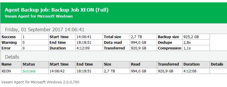

Backup is finished. One of these full backups takes just over 4 hours.
Email showing backup status...
Currently, there's more data on the PC than needed, but over time it will become as full as this again, I'm sure. Still need to transfer a few files like the backup of the OS from a couple of months ago that I used as a virtual drive to get back on track and some movies that I haven't moved yet.
Rather than waiting for me to clean up all of the disks I wanted to have the automatic backup scheme in place and running.
Taking up most of the space is the music collection and photo's. Both of those categories important enough to keep save.

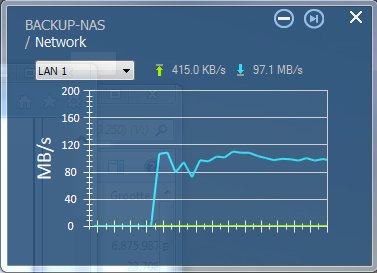

I had to move some large files, the speed:
Not bad for Raid 5 . Also tested the backup by restoring a single directory stored in one drive to a different drive on the PC. Works like a charm and it was a very familiar feel for me. Easy and fast. I've found my Backup program it seems. Always loved the ease of use of Veeam Backup.
It mounts the backup virtually and you browse trough it as if it were just another set of disks.

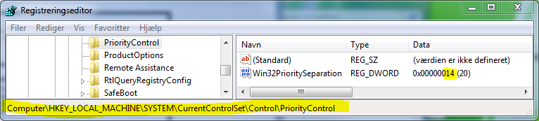

Have used tons of hours last ten days to get a new CPU/motherboard/memory to perform great sound stream you know the "eyebrows" and based on that study and to be constructive your situation have some settings to share you could try out to see if it can help also your platform, settings should make no harm simply just change them back if Zappa don't agree.
1. In "regedit" set below string to "14", role for that number is to set "Foreground and bag ground applications equally responsive" (where Win7 default is really "18" if one via GUI button set it for bag ground services and 26 if one set it to best foreground application response time which is default, but sometimes after a fresh install it starts as a older OS setting of 2 instead of 26 until one accidently over time hit ok button in the GUI).

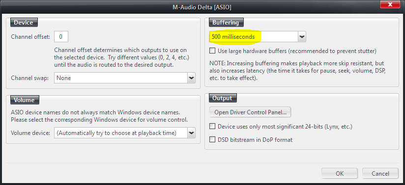

3. Set JRiver ASIO buffer to 500mS as below.

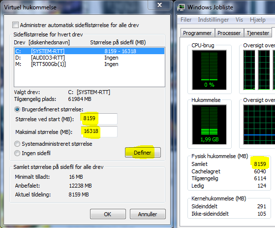

4. Set virtual memory as below where first number is taken from "Taskmgr" and second number is first x2, in study tried in general three different settings where one was default as Win7 set it and another one was ala Win10 to set it to very low numbers including the lowest possible but below was champ soundwise.
In general the four above tweaks was convincing in they worked on three different platforms one was E3-1270/C206/8Gb and new one was I7-6700K/Z170/16Gb and the old one to exchange is AMD APU A8-3870/A75/8Gb, but below point five was a bit surprising compared to old studys in the two Intel platforms had to have HPE timer turned off to get a Zappa smile. Especially the new Skylake platform was surprising in with HPE timer turned on DPC Latency raised to sky high where in past studies it used to help on latency, but a reason can be MS has modded kernel behavior down the road and ported their experience from Win8/8.1/10. By the way the new platform have stunning DPC lantency numbers with out HPE timer, with no task loaded it hovers gladly around lowish 3-12uS numbers.

Thanks for this post, BYRTT. I went over it one by one (still need to check the timer, though the Asio card did always have good numbers) and I'm getting that sweet sound again. My Asio setting were off and I forgot all about the Windows memory settings (16 GB in my case).
It's hard to tell what's different, but it's getting to sound like (for lack of a better word) "analog" again.
I reverted back to my DSP setting from before the average experiment and I thoroughly enjoyed the listening session.
Still some work to do, though I'm glad with this difference.

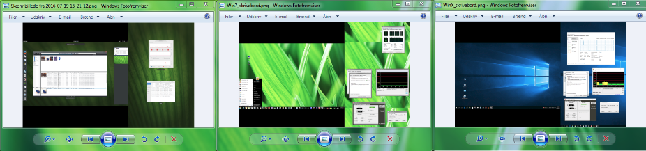

Great to hear about experience thanks but one point make also my head spin and that's when talking about a veil in front of the music using JRiver compared to Audirvana, loopback tests between the two as wesayso suggest would certainly be interesting then. Say this because last September had three different OS up running on each their SSD on same platform testing with JRiver and the build in players and even they sounded not exactly the same difference was not a veil but something much smaller that probably could be tweaked in OS or player settings so they start sound close to exactly same.
Dual screen captures the three tested OS was "Ubuntu GNOME 16.04 LTS" verse "Win7" and "Win10".

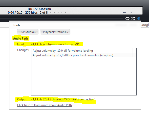

On Windows it's probably known knowledge but to get JRiver be real Audiophile most important first thing to do is setup "Output Format" container so settings there cover exactly the rates that used DAC's can perform and to be able to get exclusive access to soundcard set "Audio Device" to use either WASAPI or ASIO, to monitor settings work right when playing tracks is viewable in "Audio Path".
