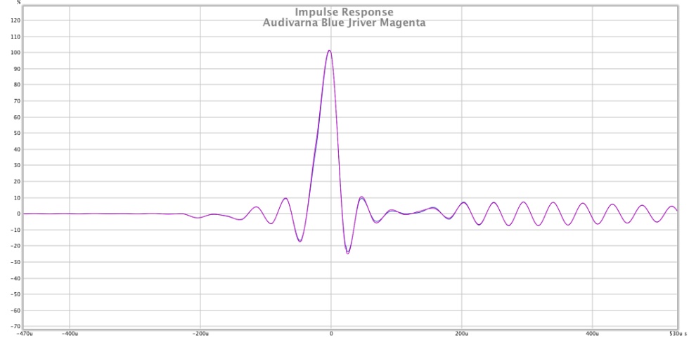

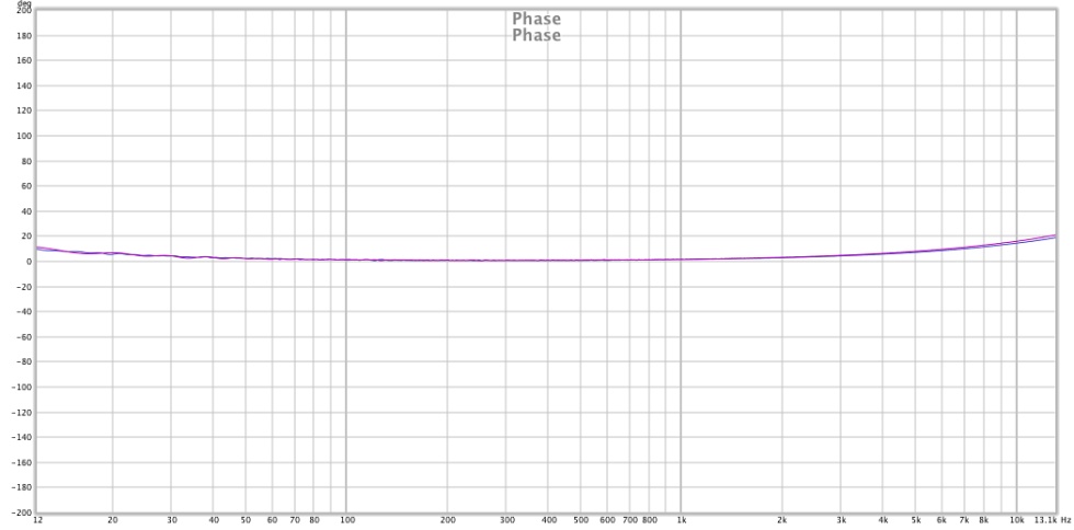

I did a test by playing a Dirac Pulse at 44.1K in both Audivarna on Mac and Jriver on PC and recording the output in Audacity by loopback cable.
There are some very slight differences but I think that can be put down to test variability and the fact that recording an impulse like this is not as clean as doing a pure loopback in REW.

Phase
attachment.php
Impulse, I did my best to line them up but there is still a very slight difference that is hard to overcome when recorded on two different systems. The overall shape is due to the ADC and DAC filters of the Focusrite.
attachment.php
I don't see anything that would make them sound different so if they do then it might be time to start checking the settings or digging deeper to find what is going on.

Interesting test, thanks. Have you ever heard differences between the two when playing music like Perceval observed?
And could you run a sweep in REW trough the JRiver chain? That would give more data to look at. For a DAC to have 10% swings after the main peak I always wonder why. It's probably high frequency filters we are looking at around 22 KHz, but that should show up in an early waterfall plot.
I realize we are looking at a zoom of half a millisecond. But these are the things we change within Windows with our timing tweaks. I had always heard a difference between Wasapi and Asio within my own system. Untill I tweaked the Asio buffers to get both measured IR sweeps more similar in loopback tests. I needed the Asio driver as using Wasapi would not give me the surround channels. For the longest time I was using Wasapi because it sounded superior.
I'll never make the mistake again thinking that there are no differences to be observed, though in your plots I'd doubt we could hear any. They are real close, even the IR.
I'd be real interested in a similar comparison from perceval's system.

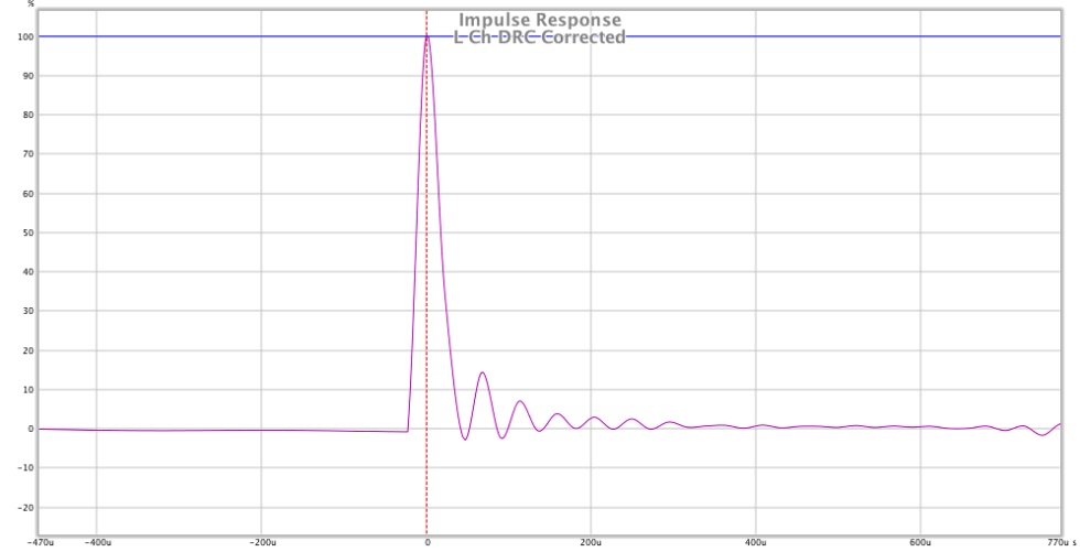

What's interesting is this is my Left Channel corrected impulse when run through DRC 😀
attachment.php

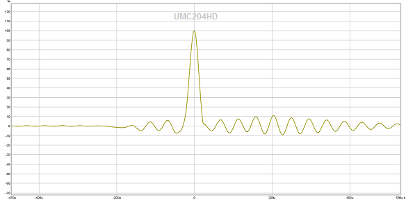

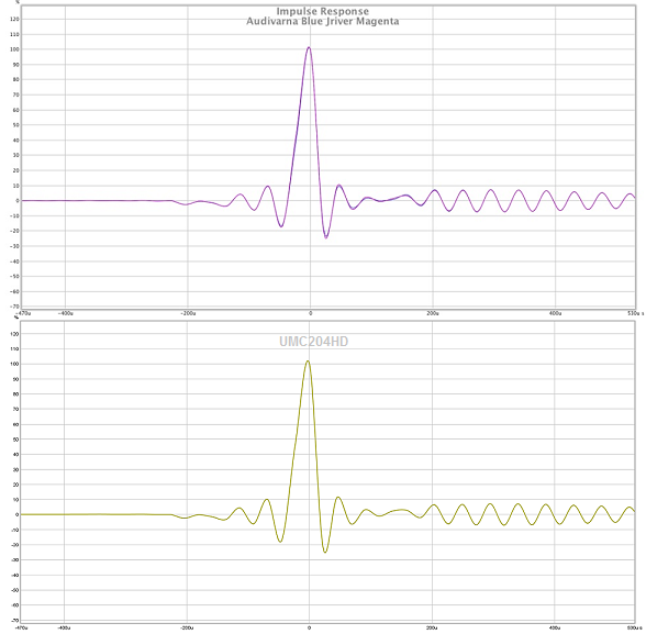

By the way i have Behringer UMC204HD and a loop back at 44,1kHz against fluid's Scarlett 18i20, can anybody tell the difference : )
attachment.php
Aligned with "Estimate IR delay":
attachment.php

Agree the wondering for those swings and some guesses would be they cut development cost not implement filters by the book and as silicon manufacture suggest implemented
Those filters are the digital ones baked into the ADC and DAC chips. Behringer and Focusrite have used the same chip by the look of the signature. I don't think it is cost cutting in the implementation more in the chip itself. I have got a couple of DAC's with selectable filters and the differences are quite subtle even when the impulse looks completely different.
Not me 🙂

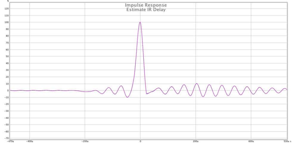

I always wonder what is the correct point for the impulse to be aligned to as the estimate function can be a bit unreliable and it makes a huge difference to the look of the IR by removing/changing the time delay.

This the comparison impulse with estimate IR delay used on both. Now it's virtually identical (you can just make out that there are two colours) and more similar to the straight loopback in REW with Est IR delay.
