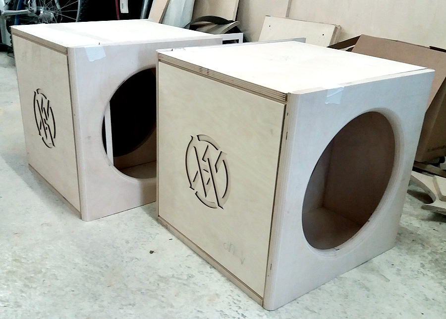

I did not get as far as I wanted, working on the subs, but glued up all the side panels with the logo's.
I'm pretty satisfied with that look. Time is hard to come by, as life continuously gets in the way. I'll get there eventually, got some big clamps for gluing and other small stuff...

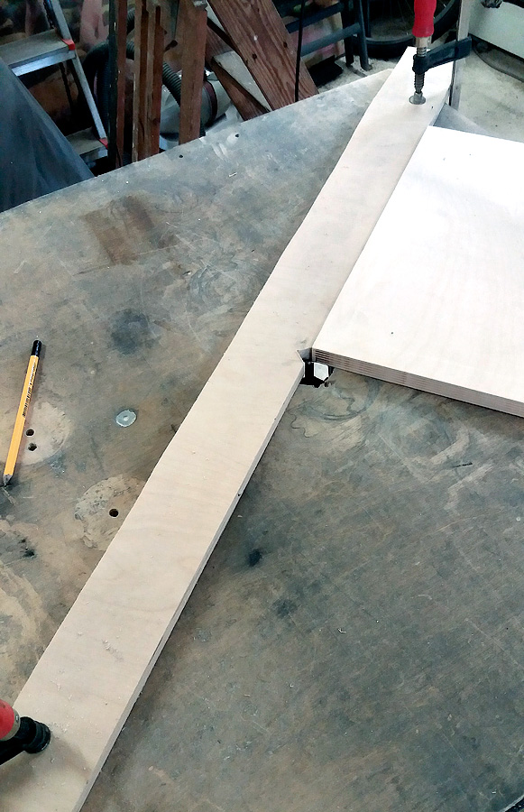

Using everything on hand as tooling:
(it is good to save everything
Cutting the sides for a brace:
(not showing the actual brace)
Test fit:
More testing:
(yes I know the logo is upside down
Good progress, but not nearly done yet! Lots of material on its way to complete things, hopefully more to come soon!
P.S. Yes, the 30W is an excellent fit into the cut-out. I did try that to be sure. The baffle will be 48mm thick in total with the woofer in-between the panels. I think it's going to work out nicely.
P.P.S. I know I said no pictures, but I decided to just take my time instead of racing to the finish. I was in a hurry to be able to get paint on before the winter sets in. I guess a layer of colored epoxy will have to do though.

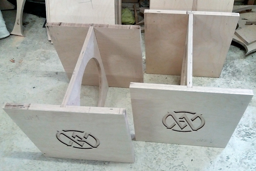

Ronald, I'm curious about something. I noticed your brace panel appears to be bisecting the side and top walls. I'm sure this will raise the "excitement frequency" of each panel high enough so the frequency range covered by the subwoofer won't excite the panels and cause a vibrational node but my practice has been to apply bracing at off-center points to avoid a double excitation at a higher frequency. Is this something you (or others) normally practice as well or does it simply depend on the design? Your Two Towers have more than adequate bracing between drivers even though they are evenly spaced, and your brace holes were alternately offset as well, although I believe that was more for damping purposes than anything else. Continued thanks for all of your knowledge sharing in this thread and on DIYAudio in general. The subs are coming together nicely!
Looking really nice!
Did you ever decide on the power amp for the subs?
Thanks, sanford1
Yes I did. I decided to get two of the Hypex NC500MP OEM modules. Member koldby mentioned the 250 watt amp as a possibility, I wanted to have slightly more reserve. It felt wrong to have 250 watt for each sub, with each array having 350 watt available. Each sub has double the volume displacement of a single line of 25 TC9's.
Hi Craig,
Nothing wrong with your reasoning here. After looking at sub enclosures from both Troels Gravesen and Siegfried Linkwitz (may he rest in peace) I figured Linkwitz had no worries about non-braced lengths of panels that were longer than mine. So I looked up the corresponding wave length of my top/side panels. It's about 942 Hz. Gravesen went wild with bracing but also had passive radiators in his design (and the smaller 10" sub). I wanted to maximize my internal volume, so less internal bracing would help, but I did decide to do one (because otherwise both the length and the width of a side or top panel would be identical, so that would mean all dimensions would be the same).
But I did stress a little less about having to place the brace out of the center (which was my original plan), due to the non-braced panel being this high up in frequency already.
Further more, there will be 8x M8 rods all the way through the enclosure, holding the baffle and end plate in place. They could, in theory, be used to tune the enclosure by tightening them. In contrast of both the above example sub enclosures, I do intend to add internal damping materials, both real wool felt on all walls as well as fiberglass insulation. As my external dimensions were as good as fixed from the start, I want to use this damping material to 'fool' the driver into 'thinking' the volume is larger than it actually is.
So, yes, because we're only talking about sub frequencies here, I stepped away from the need to place the brace off-center. In a mid enclosure I would have done the off-center thing though. This placement was an easier way for me to make the cuts with a 8mm router bit. Just 2 cuts just by flipping the panel.
