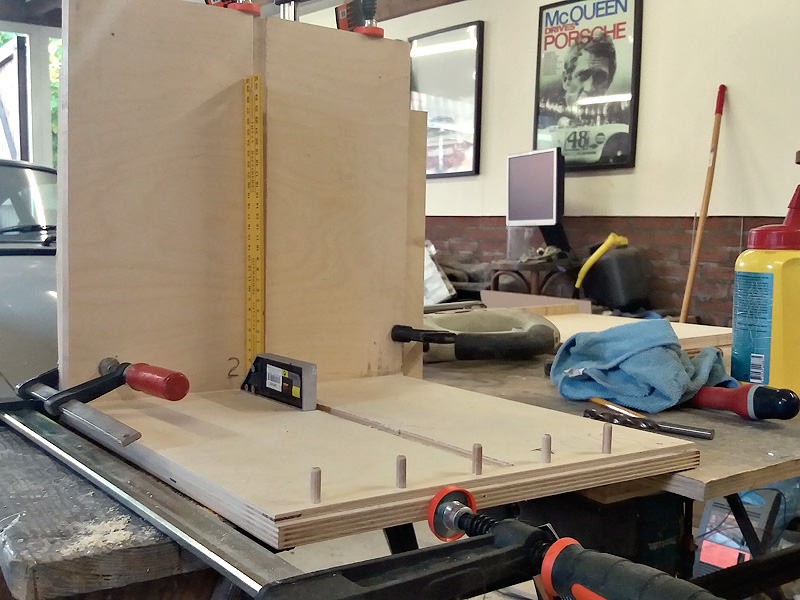

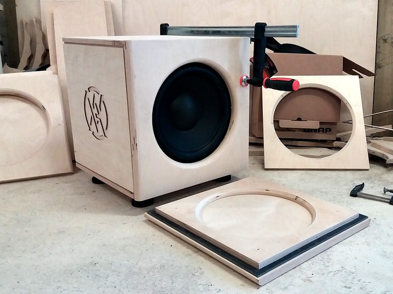

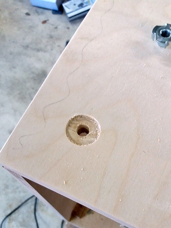

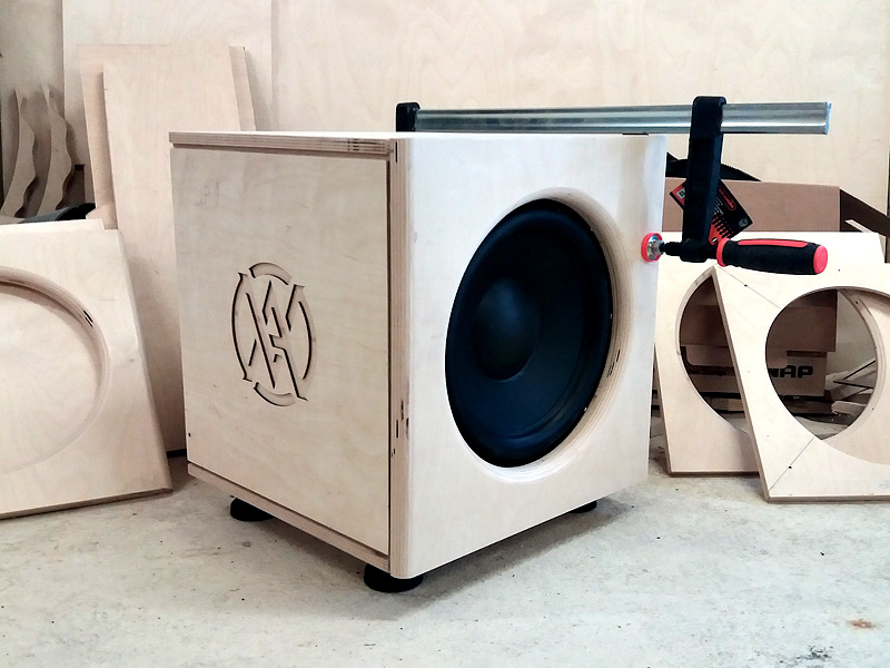

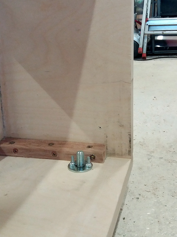

Baffle fit test:
Adding dowel pins:

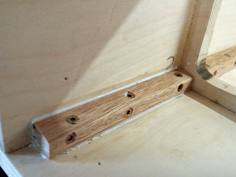

But also bolted and glued:
Clearly seen here I didn't take the time to make the inner brace as neat as the outside (lol). Just a quick jig-saw job, as long as the outer dimensions were up to spec.
Baffle fit test:
Adding dowel pins:

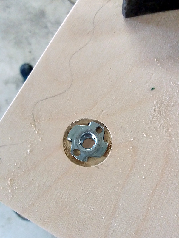

Those look fantastic! Nice job on the t-nuts, very belt-and-suspenders of you to do.

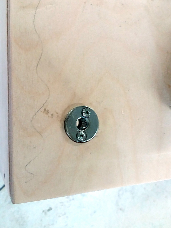

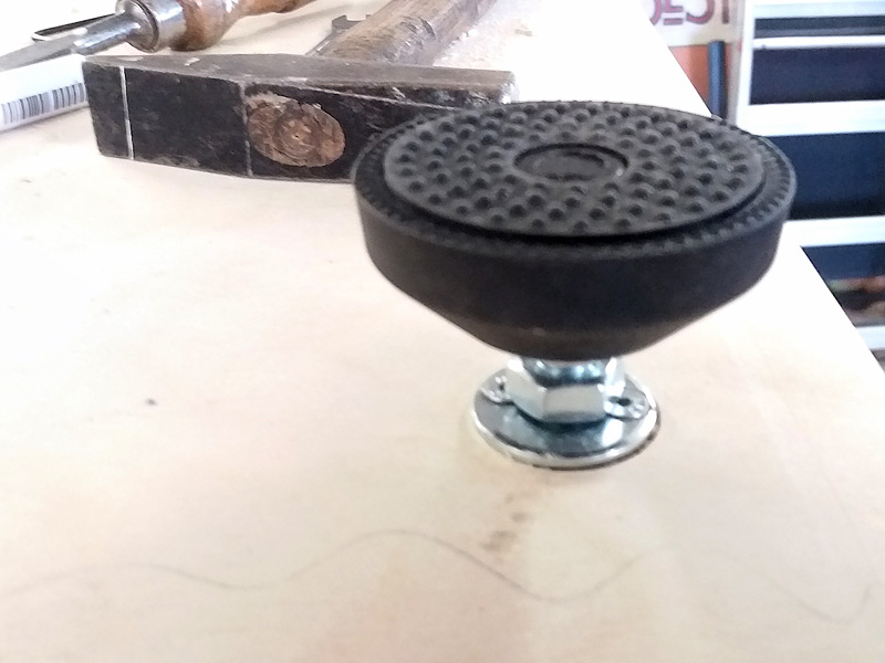

Got any details on those feet? I wonder if they would be easily available here in the states? I'm going to build cabs soon and they look perfect.
![feet.jpg](https://www.rsr-concepts.com/diyma/feet.jpg)
I had ordered some machine type feet for the arrays quite a while back. Before using those I started out with "poor man spikes" (cap nut on a bolt) and this damped foot was quite an improvement! It still has a sphere shape into a cup, but this time the cup is on a damping rubber layer before contacting the floor.
That specific model was discontinued so I started looking around and found an alternative here: Leveling feet nylon swiveling with ball joint
(sorry no brand and model numbers)
They were quite a bit cheaper and very similar to my original feet. Only this time I ordered the bigger 60 mm feet to give them some body to look at. I used M10 threads x 50 mm, model d60. Meaning it has a ball in a socket type construction with a rubber damping inlay. Very neat for such a small price. One of them can carry 350+ Kg.

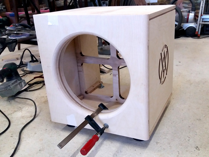

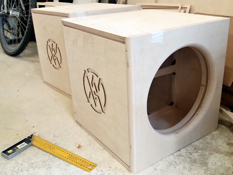

Ronald, how are you planning to attach the woofer beauty panel? Exposed or hidden fasteners? Magnets?
Edit: I’m assuming you plan to allow access for servicing the woofer should that be necessary.
The plan is a hidden solution. The beauty panel is 1x 18mm Birch Ply external and 1x 15 mm internal. The plan is to weld some T-nuts to threaded rods and fix that (8x) to the 15 mm panel. Add some space on the inside of the outer panel for the T-nuts to (just) sink in and glue both together. So now I have a 23 mm outer baffle with about 8 threaded rods sticking out.
Next the threaded rods run trough the enclosure and will be fix with external nuts at the back panel. So they will hold the internal woofer baffle in place too, with separate nuts there. They are mounted with MLV rubber gaskets on both sides of the enclosure. Sort of a floating baffle.
I've been up and down with this idea, but yes, I want to have full access if needed for maintenance. I could easily do it a hundred other ways, but this seemed like a simple enough solution as I have an electric welder.
All other things I came up with had a need for even more internal panels etc.
I must have stared at the sub as pictured for about 15 minutes, trying to come up with a clever solution not involving the threaded rods (I have them already though). But that still means exposed nuts or bolts at the back side.
The rods is a (one rod) fit(s)-all solution, clean from the front and the back nuts can sport some mounting brackets to mount the amplifier on the back or at the (rear) side (hidden behind the array).
