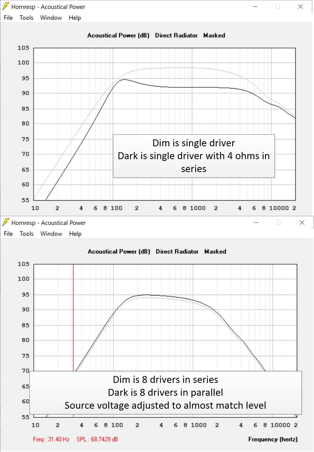

I looked to HornResp for an answer. Top sim compares a single SB65 driver to same driver and box with 4 ohms in series with driver. The series R definitely causes peaking and thus raises the QTC.
The lower sim compares 8 SB65s in series with 8 in parallel, with source voltage adjusted to nearly match the levels. THe curvers are identical except for the level offset. There is no apparent change in Qtc due to multiple drivers in series.

The reason why there is no change in damping for the series case is that back EMF for the drivers is in phase and so adds. With N drivers you have N times as much voltage driving unitary current through N times as much impedance. Same current, same force exerted on the cones, same damping.

Not to be nitpicking and still remembering I was the first to make a fundamental flaw, it is not a back emf voltage that produces the current. The movement of the coil in a magnetic field produces a current, and as this is flowing through an impedance (voice coil) there is produced a voltage...
