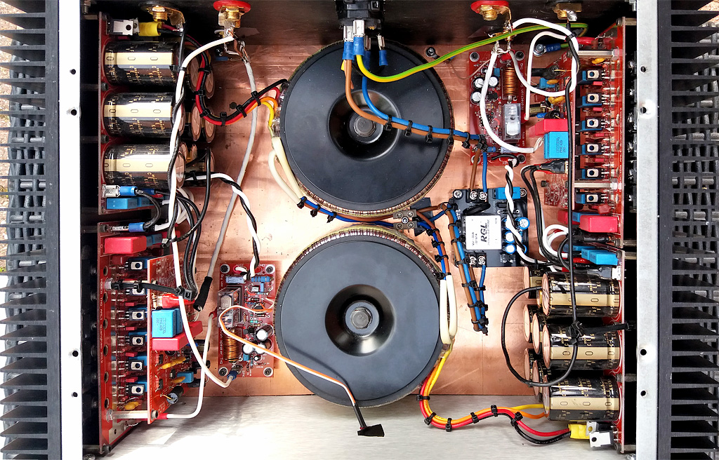

I'd look at the speaker and amp as a system. What one amp can handle easily another cannot. Hard to point a finger at whos at "fault". The speaker or the amp?
I don't think the amplifier I use right now would have a problem driving the arrays without impedance correction.
Circuits are modeled after the Goldmund Telos 400.
6 pairs of Mosfets per channel making 350 watt into 8 ohm/channel.
My preference was determined when I was still using my trusty (but old) Pioneer A757 MKII which was about 100 watt into 8 ohm.
I've had that one since the early 90's when I bought it new. I still use a Pioneer A-447 for my ambient channels.
The bigger question is: is it beneficial to use impedance compensation? The arrays don't have an unusual or straining curve.
It would not be considered a difficult load.
