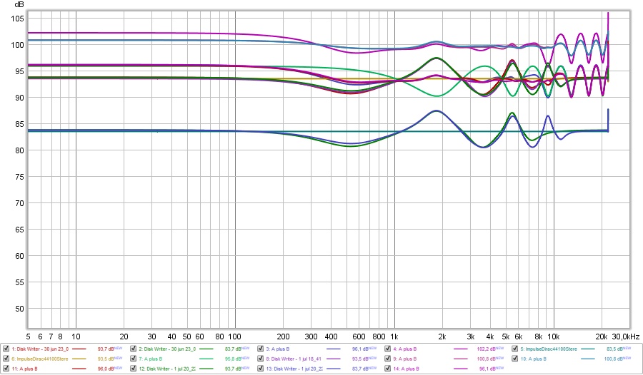

I'm running tests like these:
attachment.php
In the graph above, you see the mid/side EQ and it's effects on each ear.
Going with a 10 dB head shading, and the assumption that the delay between sound of the left side speaker arriving at the opposite right ear will take about 0.27 ms.
So I look at the left ear, the left ear with a bleed of the right channel and the right ear and the bleed of the left channel.
I do this for the phantom part (L+R) and L or R by itself. The EQ is meant to reconstruct what the sound at each ear would be as if the source was from straight forward, or the left by itself/right by itself.
With this type of EQ there are consequences, like I said before. I've gone into great length explaining that earlier in this thread, as it is a vital part of it's function.
Anyone willing can do these exercises themselves. Just figure out what the sound should be for sounds from straight forward, compared to the 2 sources coming from the front. The Fixing the Phantom Center thread has a lot of useful information on these principles.
The difference between min phase EQ and linear phase EQ lies in the content of the right channel for a left channel signal in the situation of using mid/side EQ. This can be seen in the Fr curve, the Spectogram/Wavelet view, but not in the sum of the signals at the ear. So the content of that opposed channel with only Left or only Right content playing differs.

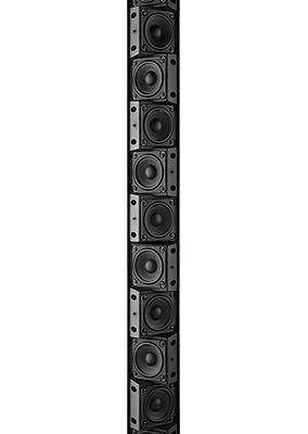

Have you seen the Bose array?
attachment.php
You want to create something like this, but on steroids? Meaning even more diversity between driver aiming? 😱
In all honesty I do believe something like what you propose would still benefit from software correction. Even if you solve the summing of the drivers, the top end on something like this is pretty hard to predict... I don't think there are many programs around that can sim something like that.
There have been enough passively controlled arrays. So that's not the issue... What do you think the benefits will be?

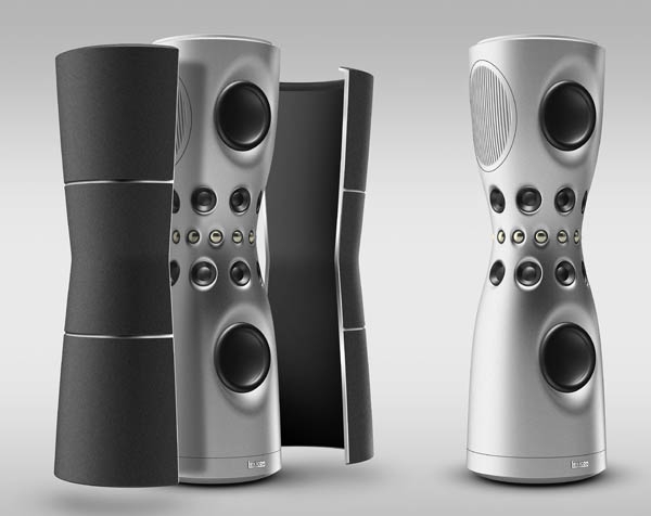

Personally I really like the direction we saw on the Lexicon speakers:
attachment.php
Something like that with a bit of software would be a ball to play with! 😀

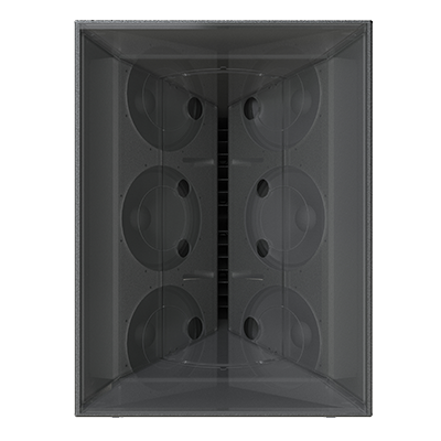

I may have had dreams of a 3 rows of full range driver array, outlined on a cilinder like surface and enough channels to play with 🙂.
On the other hand, a wave guide shaped array with unity/synergy like packed drivers would be fun too, a row of tweeters at the apex of the wave guide and the mid/low feeding trough the ports like a unity/synergy.
That way you could mimic an ultimate line of drivers actually acting as a seamless line over a very wide frequency range.
It would take a rather large budget to make though, lots of drivers needed.
The wave guide would look something like this:
attachment.php
But picture the wings closer together, with a row of tweeters at the apex, with mids and lows feeding the wave guide trough bandpass holes following the rules of the unity/synergy in spacing. A bit more care at the mouth for diffraction (folded back with large radius).
Ah... dreams... 😀
