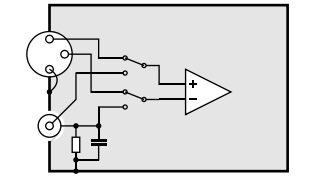

Thinking about the RCA input inside my enclosure, it's more like the first drawing in chapter 4.5:
Where the left side is my RCA input connector, the right will be connected to the Hypex J4.2 (positive center), J4.1 (outer part of RCA) and the shield J4.3 (with the resistor/cap) as seen here top to bottom. (RCA input mounted insulated from the enclosure obviously, where the cable shield and outer ring of the RCA are connected together)

You also make a rca->xlr cable. In that way you can keep the balanced input on your amp.

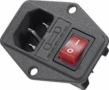

This is how I would do it from reading the datasheet.
Wire your main power switch to the two prong connector J3, (switching this on will activate the standby supply) connect the Standby output J6.3 to the PS Enable Pin J6.9, this will then switch on and off the whole thing by using the main power switch.

Use a balanced input connector to the amp on an XLR and wire it as a pseudo balanced cable by connecting the shield and cold (differential negative) together on the RCA ground pin as shown in the diagram. This still gives up to 40dB of common mode rejection on the input. Better than a straight RCA connection.

I think I'll use an RCA input connector this time and wire it like that pseudo balanced cable. I can always open up the sub enclosure to change to balanced input at a later stage, I always keep my constructions serviceable for reasons like that.
I have thought about skipping the extra on/off extra switch like that. But as I mount the complete assembly on the back of the enclosures I'd envision a seperate switch might be easier to get to to switch on/off. I've already ordered a 90 degree power cable to save space.
If I wire the RCA input like I mentioned to the Hypex amp, it would be exactly the same as putting the balanced input connector on the sub enclosure with an altered RCA cable like in the picture, right? I would hate to have to wait on more parts, I only want to be sure I have the right idea here. As said, if I ever change my mind it will be possible to switch things out.
I figure a balanced input would have 3 straight wires to the J4.1, J4.2 and J4.3 inputs anyway.
What I do sometimes is to use a separately switched powerboard so I can turn everything on and off from a central point but still control the power sequence.
You can switch the standby and psenable but where will you put the switch to make it easier to use?
You can use the three wires only inside the chassis and do the pseudo balanced connection at the input RCA. I prefer to use an XLR as it is a much better connector and then any common mode interference from the cable is cancelled by the amp input. If the cables are short it probably won't matter anyway.If I wire the RCA input like I mentioned to the Hypex amp, it would be exactly the same as putting the balanced input connector on the sub enclosure with an altered RCA cable like in the picture, right? I would hate to have to wait on more parts, I only want to be sure I have the right idea here. As said, if I ever change my mind it will be possible to switch things out.

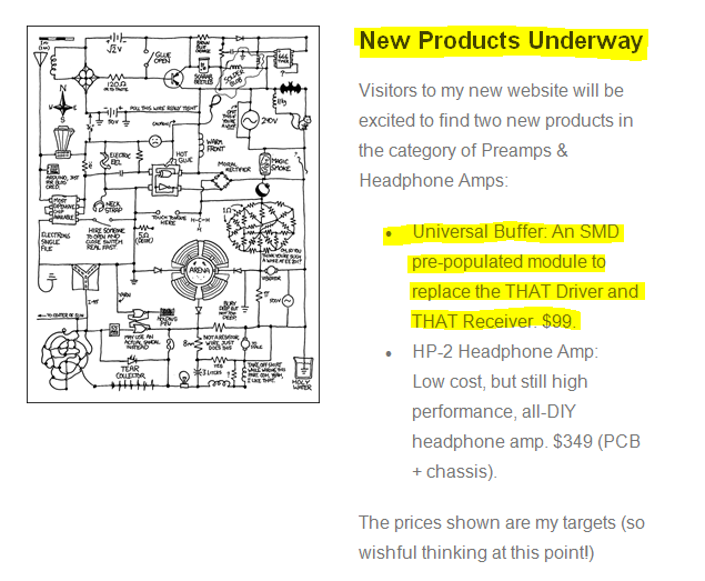

If you need to balance an unbalanced out you can use a That 1646/1606 line driver. It is usualy very simple to implement and does have very interesting properties( it simulate some behavior from transformers and was designed by B. Whitlock from Jensen transformers).
You should be able to find easily pcb for this or use perfboard to implement it. One thing to keep in mind is that they have a gain of 6db ( as other opamp answer to this kind of issues).

To lessen the probability of ground loop be sure all your gear share the same ground reference and go starground principle.
An other answer could be to change your soundcard to something from pro world, they usually have better immunity to this kind of things.
I seem to recall Tomchr used to have something like That (pun intended
But I can't find it in his current webshop.
I'll go with what I have first, and will remember this solution. I've often thought about going with Pro gear to go towards the all balanced route. But it can wait, the GM clone isn't balanced, so there would be more involved to get it all worked out etc.

New ballanced driver and receiver line stages from Tom is underway, below was announced in his latest news letter of 25 October ...
I thought I remembered reading it would be replaced.... thanks BYRTT.
