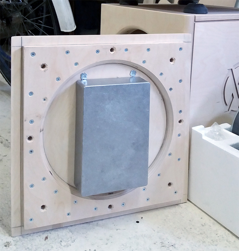

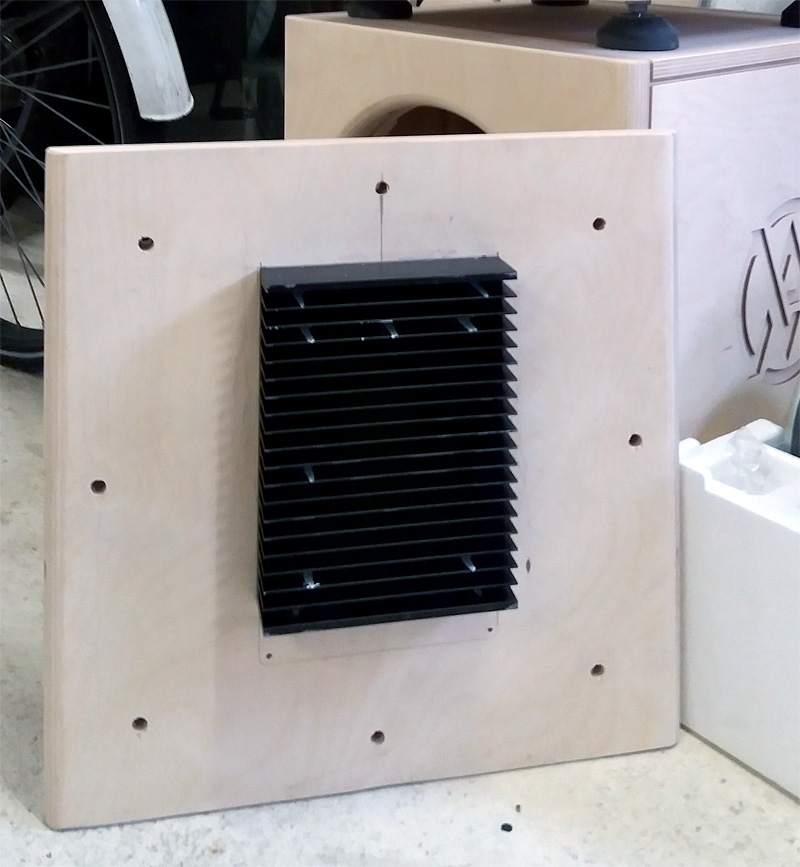

Slowly but surely making some progress:
attachment.php
(don't worry, I will touch up the paint before I'm finished...
I did not want to tap multiple M3 holes so I went for holes between the cooling ribs)

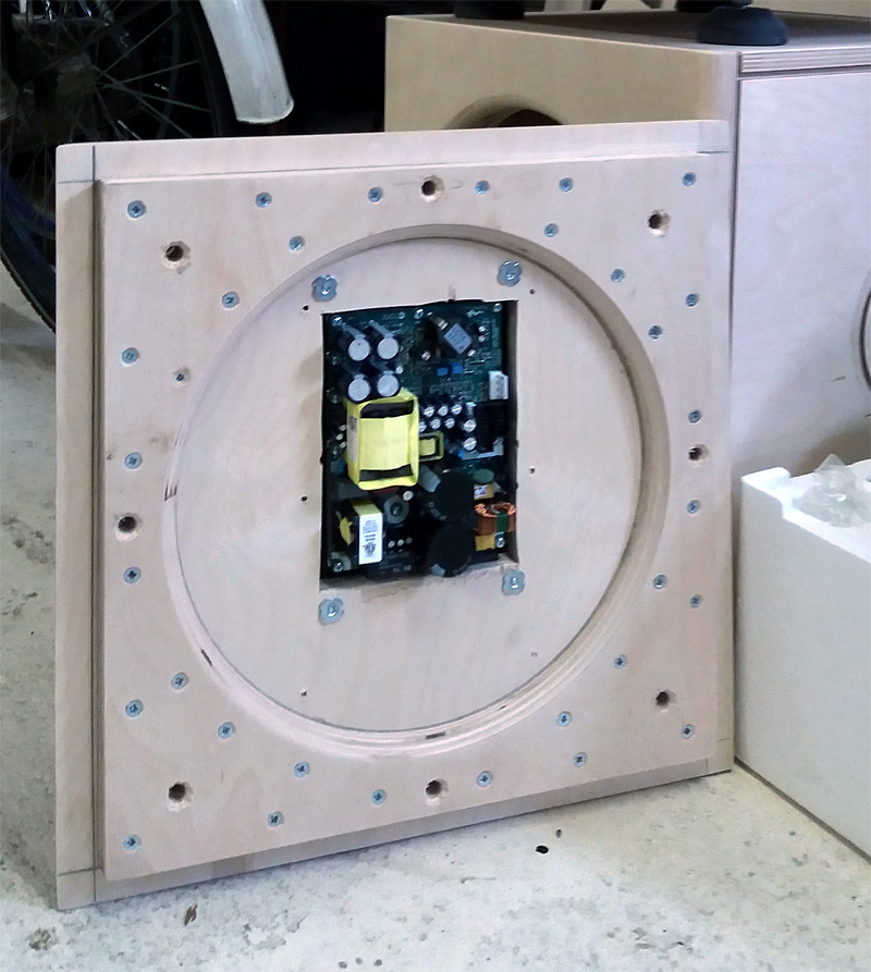

Inner side of the panel:
attachment.php

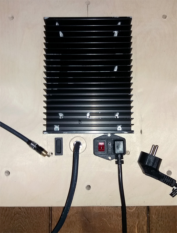

The power cable connector, RCA and on/off switch will be mounted
beneath the heat sink. It will fit inside the inner casing. A pair of loudspeaker
cable connectors still need a place somewhere.
I'll create a left and right version to make it easy to reach the switch.
I guess I have the amplifier mounted upside down right now. It might be
preferable to have it the other way around (power supply up top). This was
just a test mount. The inner casing will be fixed and sealed and probably some
mass loaded vinyl glued on it. Heatsink will remain removable.

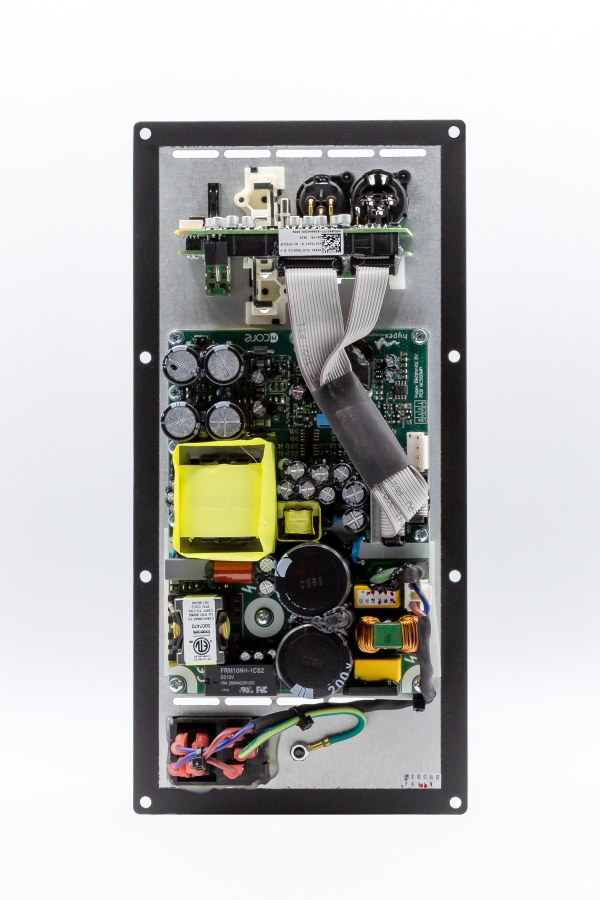

Wesayso is using an OEM module, when Hypex sells that as a plate amp they put it on an aluminium plate with vents top and bottom to aid convection. The amp doesn't need a huge heatsink but some airflow is a good idea.

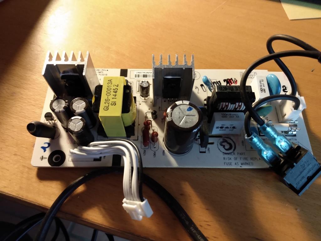

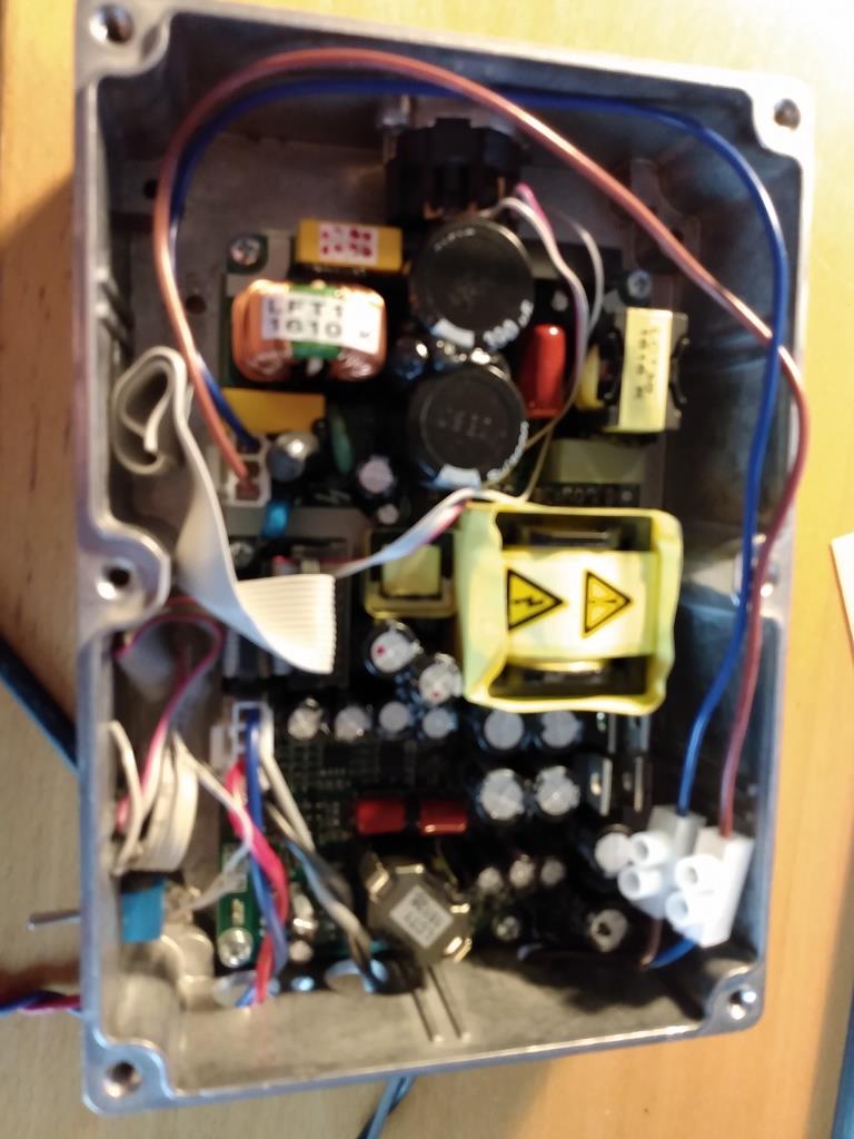

I think that all the comments about convection cooling inside the box , is based on experience with SMPS designed as the one in photo1.
The heat producing elements in a SMPS are the switching FET´s and in the design in photo 1 they are mounted on top of the PCB with heatsinks on. Therfore they need convection cooling inside the enclosure. But , as can be seen in photo 2, the switching FET´s in the SMPS part of the Hypex module, are all bolted to the back plate (not visible on the photo, but they are. The TO220 on top of the PCB are rectifier diodes) just like the ouput FET´s in the amp section. Therefore all the heat from the SMPS as well as the amp is dissipated into the back plate and with the big heatsink Wesayso are using, there is no need for extra cooling.
I have been running the 250 W version , as shown in photo 2, with the lid on and with no other cooling (no heatsink) fullrange on my towers and they only get lukewarm after several hours.
IMHO Wesayso is on very safe grounds the way he is planning his subs.

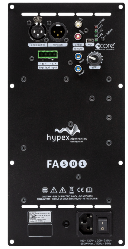

I looked up the Hypex fa501 and sure enough it is the same module as the OEM module I have and has slits for air:
attachment.php
(kind of surprised to see they mounted it upside down with the SMPS below the amp section, heat rises right?)
My heatsink is way bigger though than this simple aluminium plate.

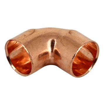

I might be able to create something simple up top with standard copper piping like these solder couplings and some copper pipe (12 mm):
attachment.php
The inner case is mounted lower than the outside heatsink so I need to run chimneys to get above it (lol). On the bottom end I could put in two slits between the different connectors. Those would already be sealed by the case on the inside.

Here's the connectors on the back side:
attachment.php
The RCA plug is somewhat sunk into the back panel to save space (15 mm). This way I can still get it close enough to the back wall, to have the front about ~ 50 cm from that wall (just like the arrays).
I still need to make a couple of ground connections, one to the inner case and one to the heatsink that run combined to the grounded power plug. I still have to find a good spot for the speaker outs on the inner case. Make some decent airflow grooves behind the heatsink on top and bottom.
But I think this is it as far as mods to the enclosure itself.
