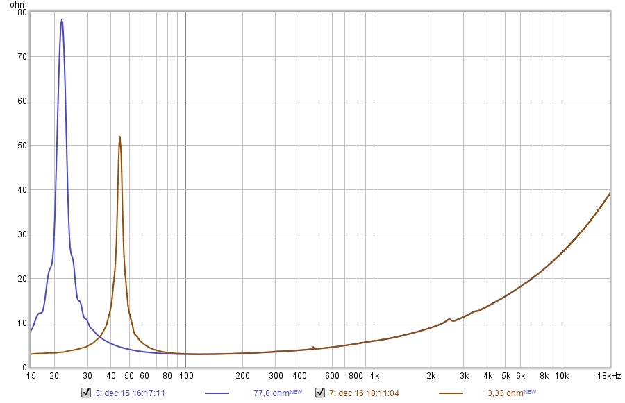

First impedance tests (sadly ran out of time to try some damping/filling)
attachment.php
Note that this is a new driver measured at ~11 degree temperature in the garage. Driver has never been powered up before.
Yet these plots do align with the WinISD predictions. Damping will bring down the peak some and shift it to a lower frequency. After all, the net volume of the box will be about 35 liters. I expect some run hours on the sub to bring down it's free air peak closer to spec (19 Hz) as I've seen samples from a friend tested new and after 100 hours (specs did not alter anymore after about 90 hours) come down to that 19 Hz value.
We'll have to wait for another bit to see what I can do with damping. It looks clean aside from some small stuff that I expect to be able to solve with damping. It's already out of band (see ~400 Hz). With a bit of luck it will go down even further after playing enough hours for break in to settle.
Mounting the driver baffle was a joy (not). I decided to use nyloc nuts to fix the baffle together (with some ~1mm neoprene inbetween) and it wasn't fun bolting it down 8 times along the threaded rods. Bought me a ring rattle key wrench to avoid going nuts :D.
I ran each plot about 4 times, they all look alike, no surprises. I'm pretty happy about being spot on with the predicted peak at ~44 Hz, as damping will bring it down to about 40 Hz (or so I hope).

Nice looks good :p
I assume that any standing waves issues within the box itself will be non-issues as the cabinet is so small That any standing waves easily will be out of the passband of the woofer, I guess that is also what the impedance curve shows :D
is there something at 55 Hz though?

55 Hz, hmmm... for taking a more critical plot I must remember unplugging the laptop and use it on its battery.
Yes, could easily be measurements anomalies, I guess that frequency is not a coincidence :p
