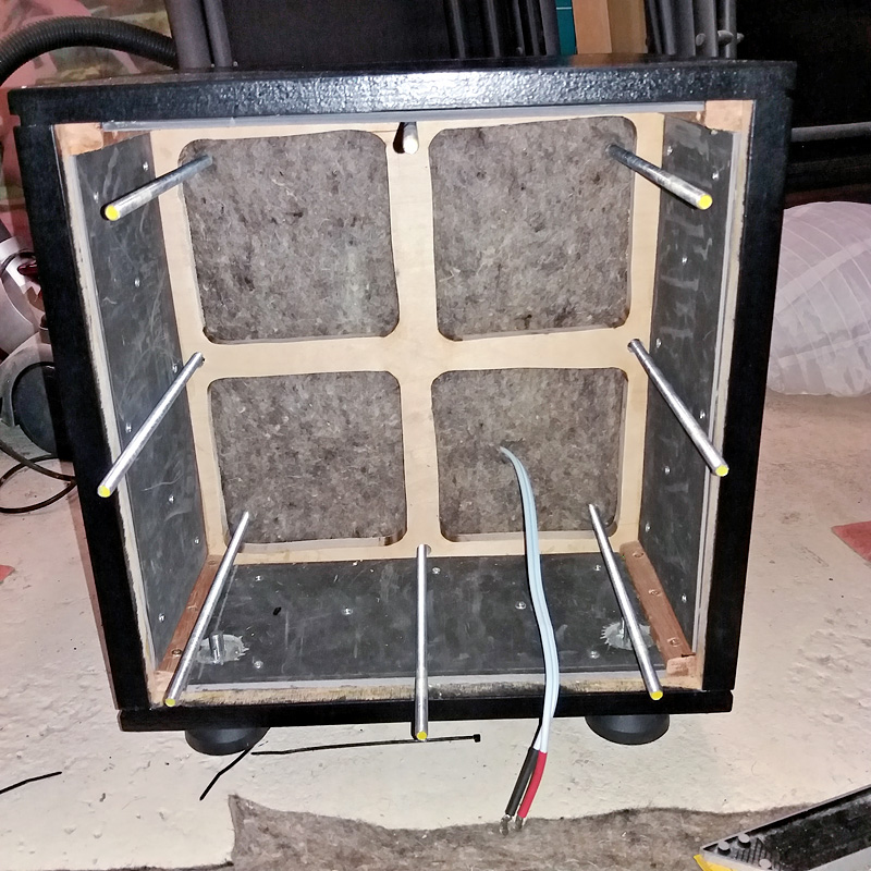

Not much time to write this down so I'll try and make it quick...

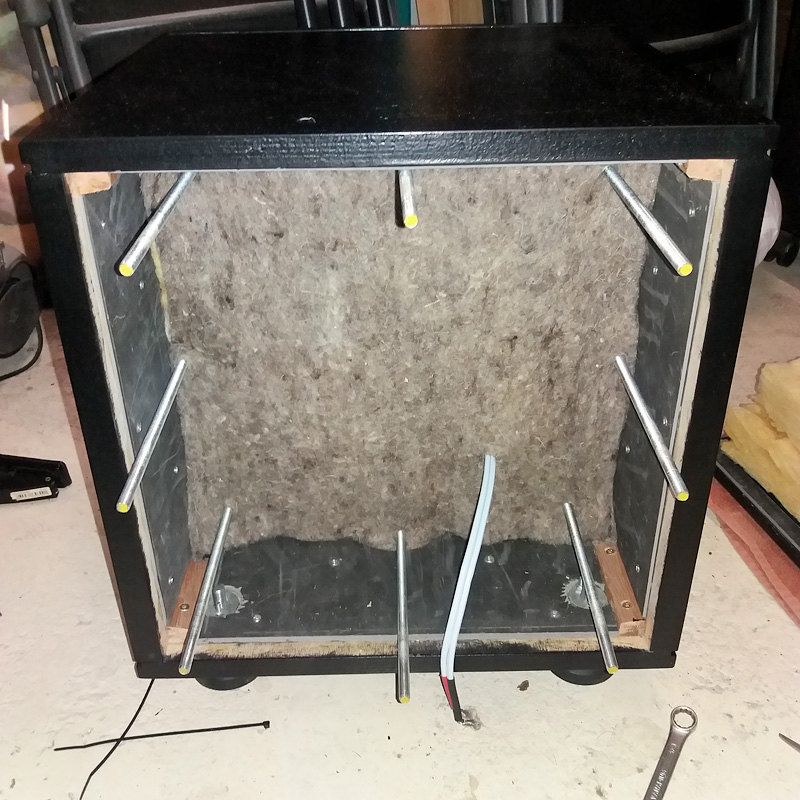

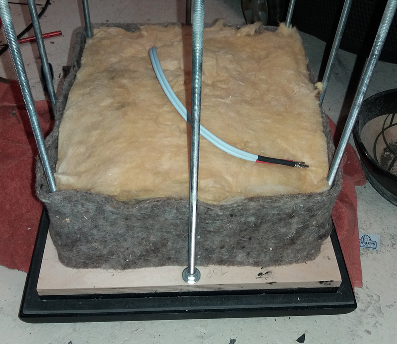

Stuffing the subwoofer enclosure, first I've build a wool felt cage around the driver:

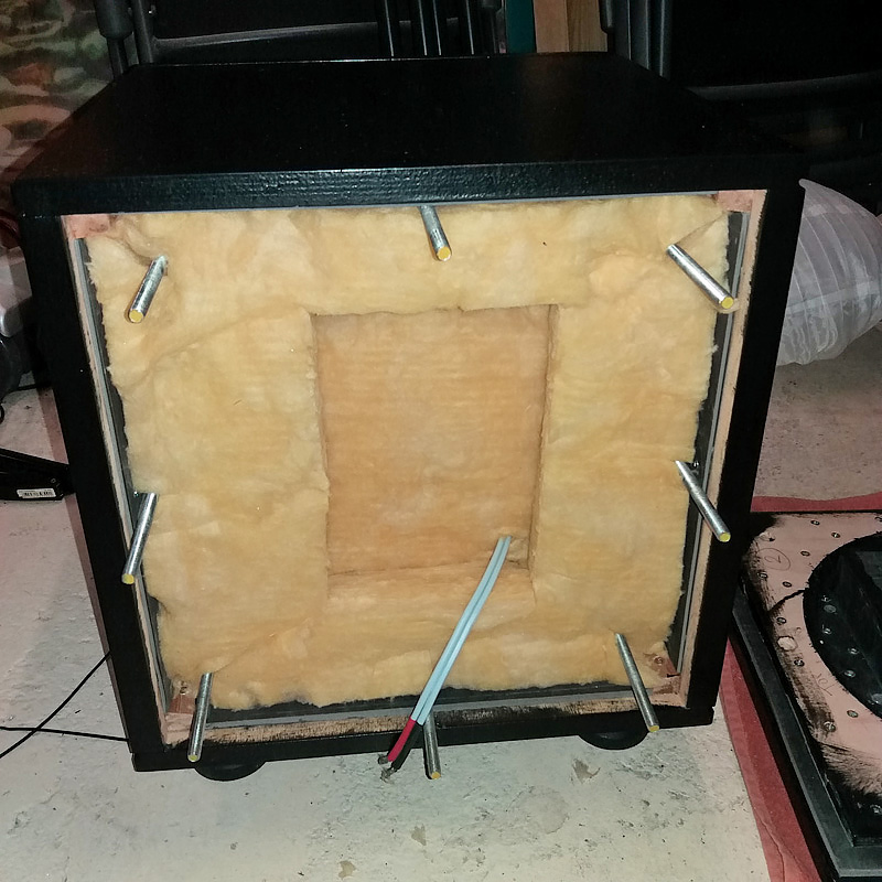

Next I filled that space with fiberglass insulation wool:
The other side of the brace was filled with the itchy fiberglass alone:

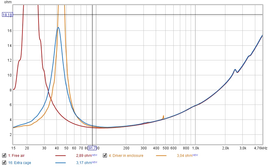

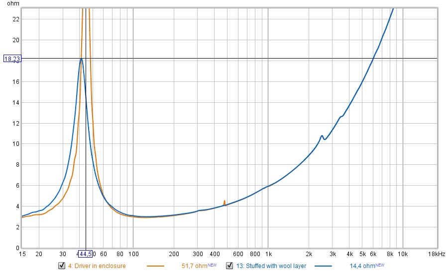

So what did this do? Let's see the impedance measurements:
Easy to see things have changed a lot. The impedance peak has been reduced and moved to the left. Not quite as much as I hoped for, but we have to remember this driver is new, unused and will come down a few Hz after proper break in. The stuffing was quite successful to lower the peak value and there's still quite a gain in 'virtual volume increase' noticeable.

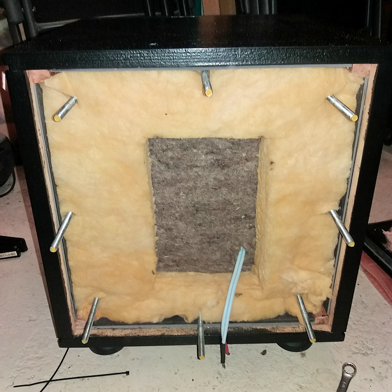

I wanted to try one other thing, instead of packing the fiberglass fill more tight I decided to try adding a couple of real wool felt layers.
So I put in 3 extra layers of wool felt in between the fiberglass fill at the non driver side.
Between each layer of fiberglass there's a layer of wool felt, about 7mm thickness. So it won't compress the fiberglass, instead it will just be a dissimilar material for the sound wave to travel trough.

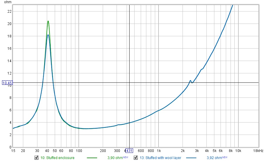

Let's see what it did to the impedance:
As seen the impedance peak is brought down even further. The curve is ever so slightly more smooth as well. I can live with this combination as a final result. I could go on and on, but that wasn't the goal. The goal was to reduce the peak, make the curve smooth and move the peak lower in frequency. Job done I'd say. Break in will probably have a further effect, so I'll first build up the second sub as this one and continue with installing the amps and seal off the enclosures.

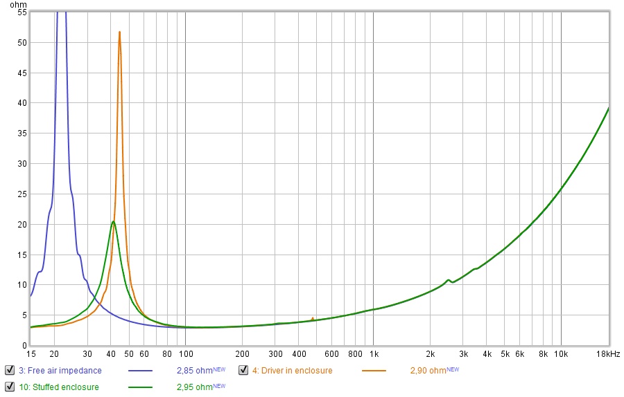

One more plot in detailed mode comparing driver in enclosure vs fully stuffed:

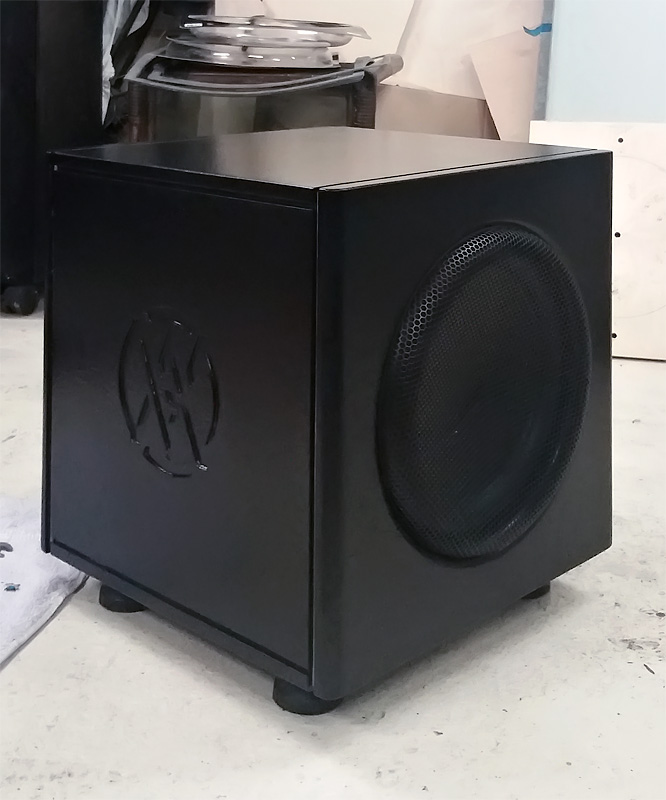

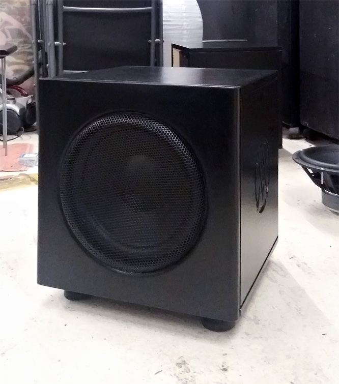

Cat protector is on...
I had to cut a groove to fit it (original hole was 280mm, protector was ~290mm).
I used the router table and covered the surface of the table with a towel to protect the paint. Worked like a charm. I glued the protector in place (Bison Polymax, a rubbery glue) and also used small nails to make sure it will stay there. Space between dustcap and the grille is just over 25mm to cover x-mech (not x-max) distance. The screen is bent inwards in the middle, the surrounds have plenty of room to move.
Not as pretty as seeing the naked driver but it will do. This Rockford Fosgate protection screen was the most open screen I could find.

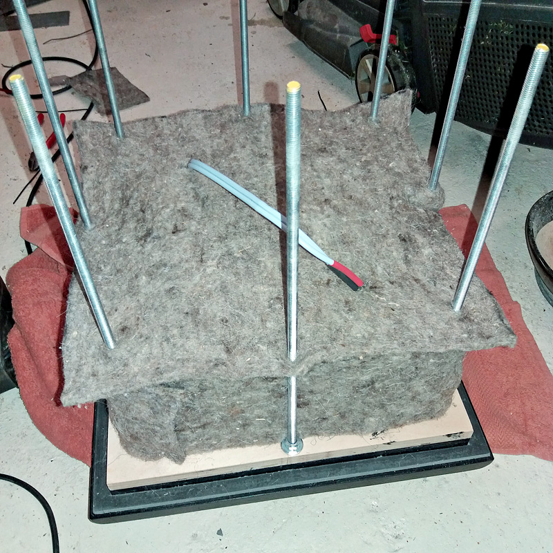

The first half is neatly stuffed this way:
After that I put in another layer of fiberglass stuffing as one of the wool felt layers was used to close the wool felt covered and stuffed cage.
I ran an impedance plot: it was moving towards overstuffed, not bringing the peak more to the left, while still bringing it down.
Out with one layer of fiberglass fill again. I had to satisfy my curiosity.
The peak is damped even more than before, and traces of the last wiggles I saw were suppressed far enough to satisfy even me. The impedance peak did not move further down in frequency, but it is damped a little more.
This will end my madness... I've booked about a 20% gain lowering the peak frequency. After break in the peak will probably come down ever so slightly (about 2-3 Hz). Making the Q value about ~0.77 right now despite the small enclosure. The enclosure size was aimed to get me about 0.70 after damping but at that time I had not planned on putting the amplifier inside the enclosure. I will settle for this, EQ will shape the rest as that was planned from the start. After break in I could actually be very close to the planned Q.
Main importance is I managed to get a good clean impedance curve, free of strange wiggles (even though it was hard to get a good reading with lots of ambient/street noise).
