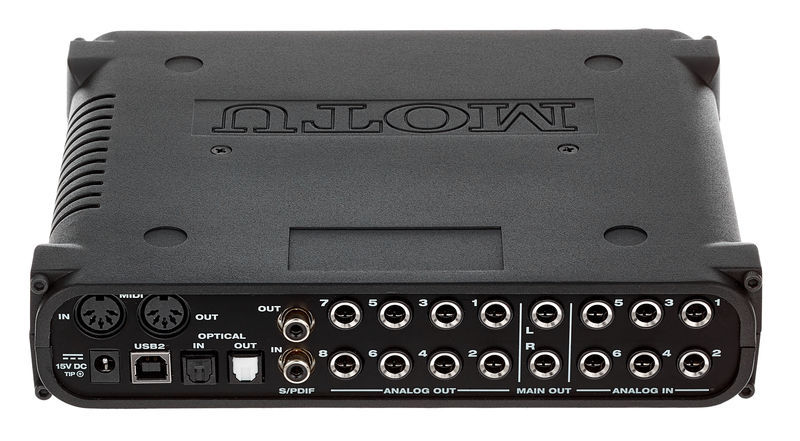

Is this the back side?
Balanced Jack out? Does it present itself as an 8 (eh 10) channel sound card inside the PC? (forgot the L and R in my count)

If your not familiar with balanced jacks, they can be either xlr or 1/4" TRS (tip-ring-shield). TRS are often used in devices like the MOTO where jack mounting space is at a premium.
FWIW, one of my most pleasant audio encounters has been how much easier, less expensive, and I dare say better, .... balanced +4dBu pro gear has been than my previous consumer equipment.
A 1.23V = +4dBu live level output, with typically 17dB headroom or greater, is pretty much a given in pro-gear world. Amp input sensitivities settings are built around that spec.
None of the wildly varying consumer I/O and amp specs built around -10dBV.
And imho, a 50ft $20 balanced cable is superior signal wise, to a 3 ft pure silver $$$ RCA cable.
Honestly, after several years away from consumer gear, I now equate using single ended equipment and RCA interconnects to having a mild cold or headache....
Love those balanced TRS jacks, patch cords for loopback, and all the TRS to XLR/RCA/... adapters I can get for them for just a few bucks each.

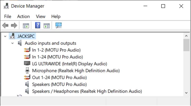

Motu presents to the OS as 1-24 inputs and outputs; their largest device goes that high. They have a console that allows routing any usb input stream to any output; same for input streams.

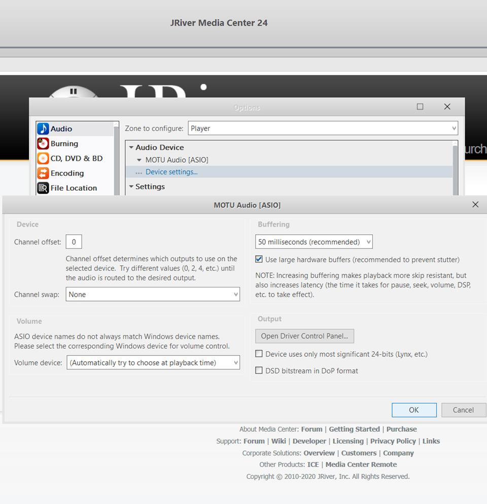

In JRiver you select Motu as the output device and then can specify a channel offset with advice to choose different values until the routing works. I got it right on the first try. Beyond that, for multiple channels you have to get into a configuration file, where I have yet to venture.
