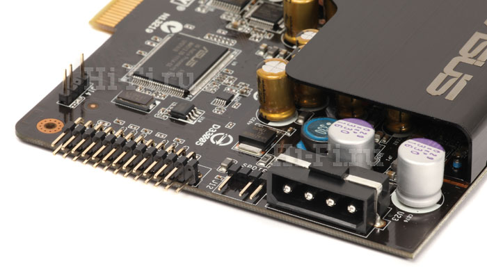

The Xonar ST has a Molex input plug for power:

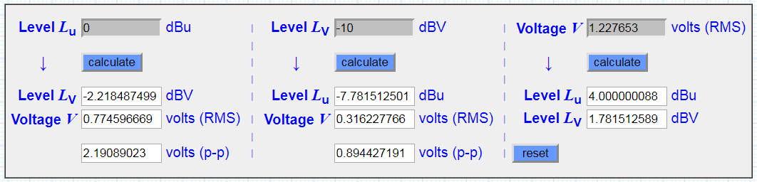

Another thing to put it in perspective for the Goldmund is that reducing 2V by -0.75dB makes the voltage 1.82V so it is very close to making 350W at 0dBFs with an 8 ohm load.
This is another reason why the 6dB of preamp/buffer gain is not a bad idea as it allows the reduction in digital level to give some room for intersample overs and still let the amp produce all it can when needed.

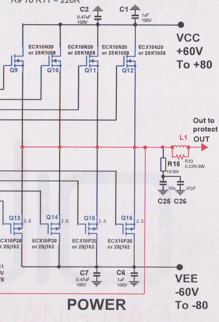

Just for your information, rails voltage is (plus/minus) 80V in the Goldmund amp according to the schematics.
attachment.php
This example from the schematics shows 4 pairs which would use 60 volt rails, mine has 6 pairs that use the 80 volt rails mentioned. :)

With meters for each of the stages, it's pretty easy to set optimum gain staging, and solve level matching issues.
First, a meter for the DAC, and set the DAC to pass peak signal just below clipping, 0dBFS.
Then, a meter for the analog output of the DAC, set to where the body of the signal resides at about -16 to -18dBFS, if using a 'digital scale' meter.
This is a good level for both consumer and pro DACs, as of course both need the same headroom.
If the DAC output analog meters reference voltage and not dBFS,
use their nominal voltage output spec to set where body of music resides. (0.316V for consumer, 1.23V for pro). That will give the same approx 17dB headroom as before. Easy to tell these meters, because 0dB is somewhere towards the middle of the meter's range, not up at the top ;)
Then, if SPL isn't all you want....cause those settings should be the maximum DAC or line out levels you run...(there's no output left that doesn't eat up necessary headroom)...
You either turn up the gain on the amp (which really means get rid of any inline attenuation), or get a line stage amp (preamp in home audio), or get a pro DAC.
