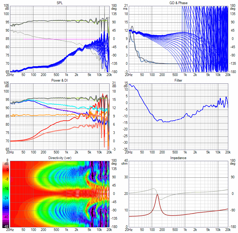

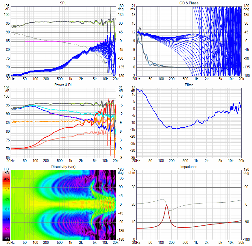

I've been playing with Virtuixcad non stop for a few days. I'll copy the results from the thread I linked to a couple of posts ago to keep it within my own thread, as it is my arrays that are simmed here:
Here's a comparison at the listening spot for a frequency shelf-shaded array vs unshaded:
The upper results are the shelf-shaded array, bottom is the unshaded array.
These are the in-room results of positions between -100 to +100mm around the 1000 mm height measurement spot. I'd say it looks to be worth the trouble. The results of the 15 degree array toe-in and 10 degree off axis listening is much more in line with what I had expected.
The results are more even than the prior angle I used (on axis sims). Pretty much in line with my toe-in experience a long long time ago. The 10 degree off axis was my subjectively preferred listening angle, having the array cross behind the listening spot. (or in front but due to how strange that looked I did not dare let that pass judgement on the WAF front)
Edit: these simulations keep a reasonable tonal balance up to 1700 mm. That's the rule number one: it should work standing up.
A by-product of the shaded array is much better tonal performance standing up and at 4 m distance. So room sound could improve too.
Belonging to the above graph, comparing shaded vs unshaded the 6-pack from Virtuixcad:
The in-room results were averaged and used for EQ correction in both plots.
So to recap:
I applied a pré-eq to get a somewhat flat result. Next I exported the Listen win SPL, which I altered in value to see a window of +/- 15 degree horizontal and +/- 5 degree vertical.
The listen-win IR was then corrected by DRC-FIR. The result of that was convolved with the pré-EQ to get a total correction.
This total correction was applied within Virtuixcad to the sim. Next I exported the in-room results looking at the height-differences from -100, -75, -50, -25, 0, 25, 50, 75 up to 100.
These results were averaged (non vector) and I let REW do auto EQ on that result, with a few quick tweaks. That EQ was applied to all measurements and the correction as seen in the upper six-pack(s).
Same procedure for both sims, Shaded and Unshaded.
Lots of work, but I need to find out if operating on the arrays is worth the trouble.
In the shaded version I've included my impedance correction schematic.
It is what I run, so I included it in the sim.

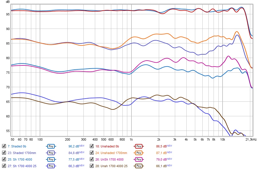

The chart I have not shown yet are the sitting/standing comparisons.
I've used psychoacoustic smoothing on these in-room results, as neither graph, be it unshaded or shaded, provides excellent results. Looking for balance here:
Obviously the shaded array will sound darker, while the unshaded array will sound a little brighter when standing up. Both show a maximum deviation of 5 dB between 100 Hz and 10 KHz.
This was the biggest compromise that I was willing to make. Neither is perfect, but I think it still is an acceptable compromise for the overall gain you get at seated listening positions.
At a distance of 4 meter the shaded array is showing a more even response while the unshaded version remains bright. However at a more distinct angle
the unshaded array will have an advantage in extension.
(under this specific angle of 25 degree, at 4 meter distance, the shaded version looks like an almost perfect 12 dB/octave roll off at 6 KHz)
The 1700 mm height was chosen because my ear is at that level standing up
P.S. I just tried to mimic the above results with headphones and graphic EQ. I do believe I could live with this compromise.

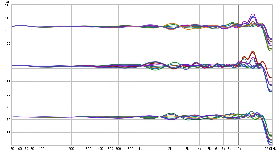

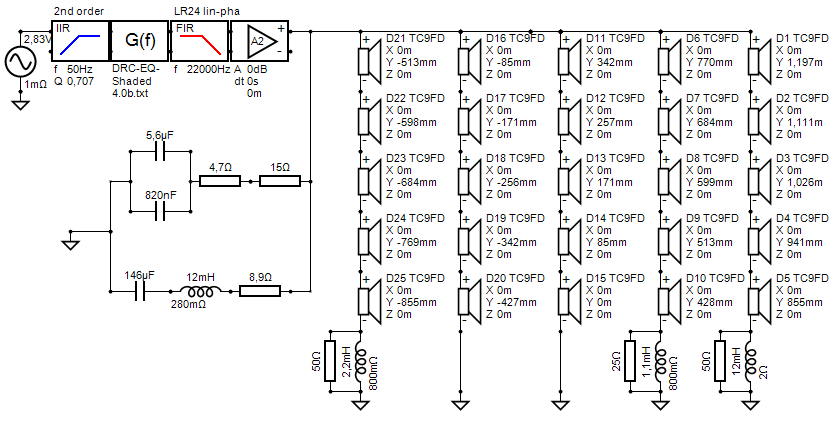

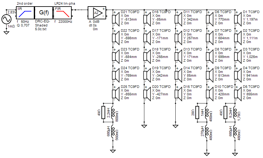

More sim work done, more results, not entirely happy yet. I was able to improve upon the results above with a slight difference in my shelf shading. As the impedance of the TC9 rises in the upper frequencies, the shelf shading isn't quite as effective there. With an extra inductor inline we can remedy that.
This seemed to clear up the top end even further:
Top one is the earlier shelf shaded example (shown before on this thread), middle one is the unshaded array and the bottom one is my new suggestion, the one with extra inductors to shade the top end.
It is easy to see, as these are raw in-room results, the differences. Based on this graph alone, I'd pick the bottom graph as a clear winner. It has less variation, similar processing on all graphs, including floor and ceiling reflections.

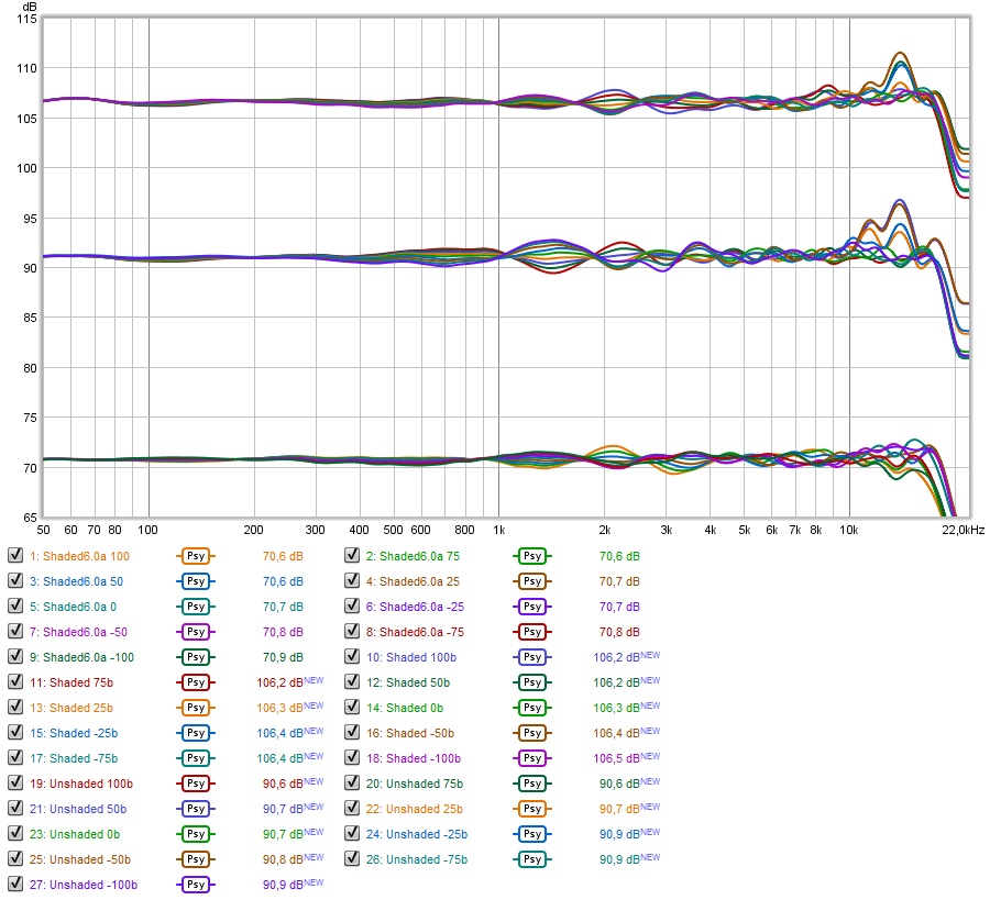

But let's examine it a bit closer. If I show the same graphs with psycho-acoustic shading we get a slightly different picture:
Even though the unshaded array has the biggest wiggles, we might state that it does keep a good balance at each position. Something I'd agree on as that is how I perceive my array. It shows great bundling of these results. While there are lots of wiggles, they are averaging out on a similar balance.
Now we see that the shaded examples improve on the top end, especially my new found shading logic. However the balance does show more variation.
Another look, this time with 1/3 octave smoothing:
Because I'm not in the middle of the array, you see that the bundling after this smoothing is less ideal than that of an unshaded array. It will take more time/work to try and find further improvements.
I'd like to get close to the bundling of an unshaded array, while keeping the upper advantage, less wiggles. I do think it should be possible. As stated before on the simulation thread, I'm not looking for a complete wiggle free solution, as it will be very hard to keep that, while adding natural floor and ceiling reflections. Plus I don't think that is the complete secret to success.

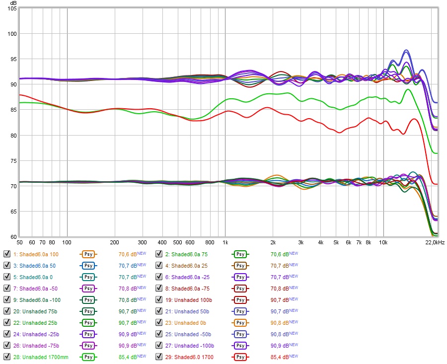

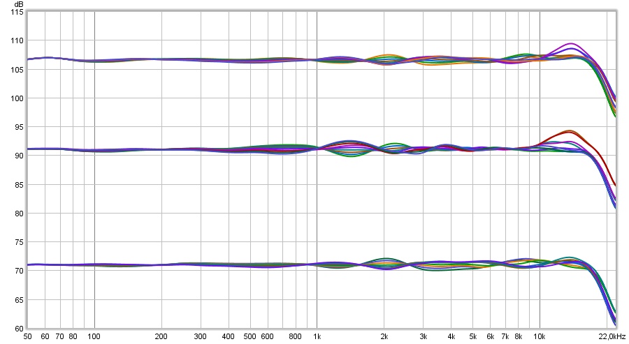

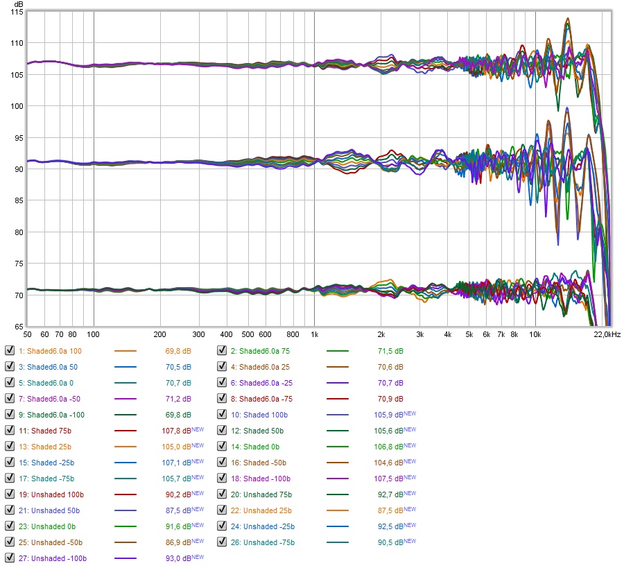

The next step:
Top graph is the first shelf shaded attempt as seen before,
Center is unshaded
Bottom is the new shelf shading with top end compensation.
Still passive filters only, shelf shaded plus inductor top end compensation. I sort of cheated, but it's very doable in wiring. I made the center group of 5 drivers unshaded and centered around my desired 1 meter listening height. The group right around that is 3 drivers below that center group and two drivers above it, so I could more easily shade their (very) top end.
The rest is back to normal as groups of 5 drivers, but I needed that tweak to get more bundling of the drivers around the center axis. I think I did quite OK. Maybe there's more to be had, as always.
Heights span +100 to -100 around the listening axis of 1 meter, in 25 mm steps.

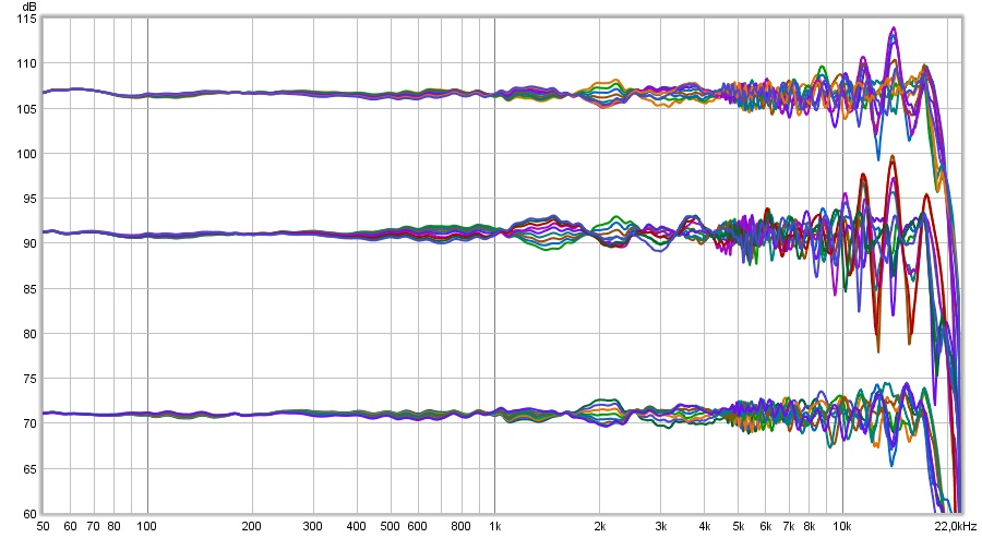

The results without smoothing:
I'd say a clear difference
. I think even the raw results look pretty awesome with the exact same settings used to make all three graphs.
Normalised comparison between unshaded and shaded 6.0...
As the boost on the upper end for the group of 5 drivers is no higher than it was for the unshaded array, I'd say that this should be save to implement without worrying.

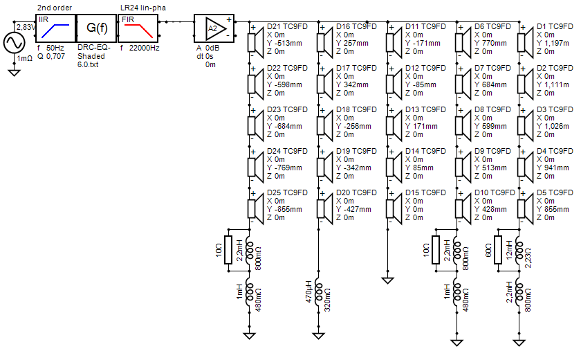

The shading schematic I used:
(look at the height numbers to see how I grouped the drivers)
To make this set complete, I've included the 1.70 meter standing height of both the unshaded and shaded array:
The unshaded array (green) is a little bright standing up. I guess I'd have to trade that in for a little darker (red) if I go ahead with shading...
I'm pretty sure I could live with that...

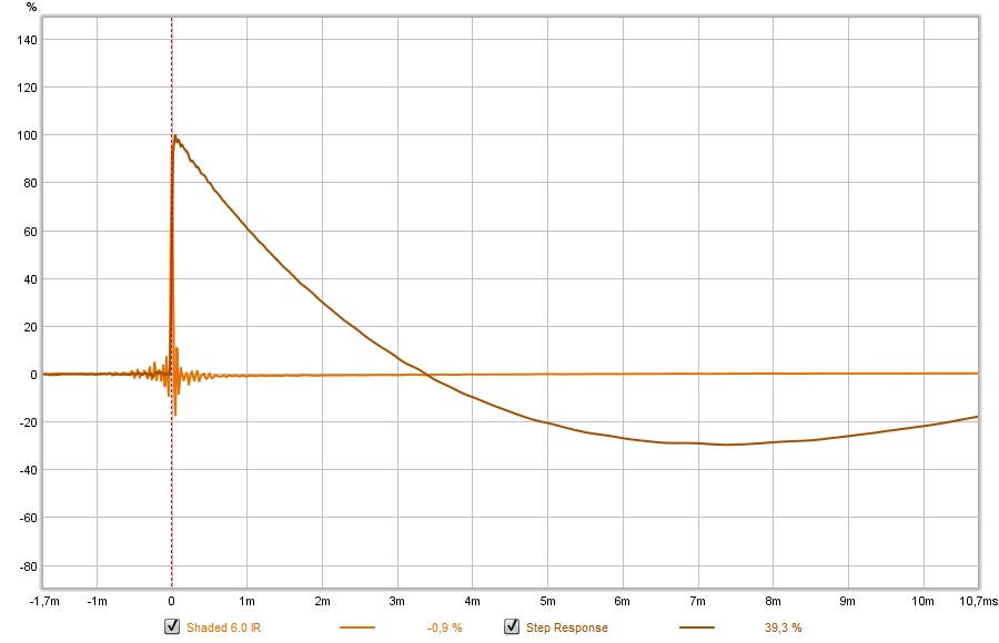

As long as I'm feeling a little victorious about this improvement, here's the predicted IR & Step (from Vituixcad)*
Center is unshaded
*= second time I spelled it right I think
