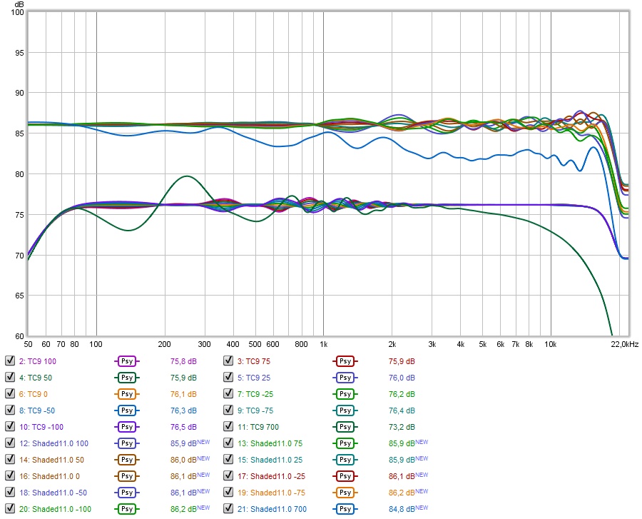

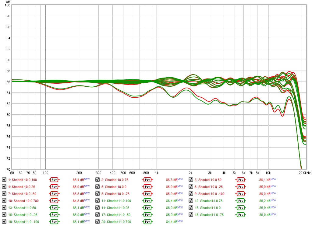

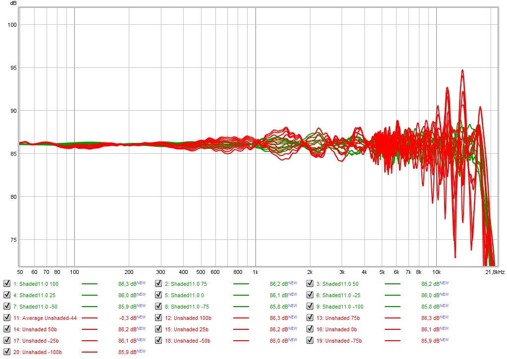

Still making slow progress, comparison between version 10.0 and 11.0. Target is better 'standing height' performance while not making the other heights worse.
See the scale on the left, 2 dB division. Meaning I'm down to plus/minus 1 dB over the entire range up till 10 KHz. Plus/minus 2 dB for everything above 10 KHz. (standing height confirms to that by itself between 100 Hz and 10KHz)

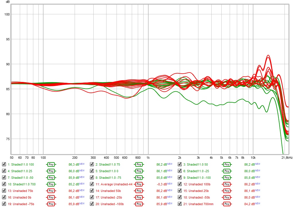

Same v.11.0 results compared to the Unshaded array...
The standing performance of version 11.0 has no greater deviation than the unshaded array. It's balance is darker, no doubt. But I'd rather have darker than brighter.
Raw in-room curves... Top end deviation max 6.6 dB for version 11. Top end deviation 21.9 dB for unshaded array.
Shaded is performing more uniform across the board. Plus/minus 2 dB up to 10 KHz vs plus/minus 4.9 dB for the unshaded array. Well over a 50 percent improvement. Much better than the 30 percent gain I started with.

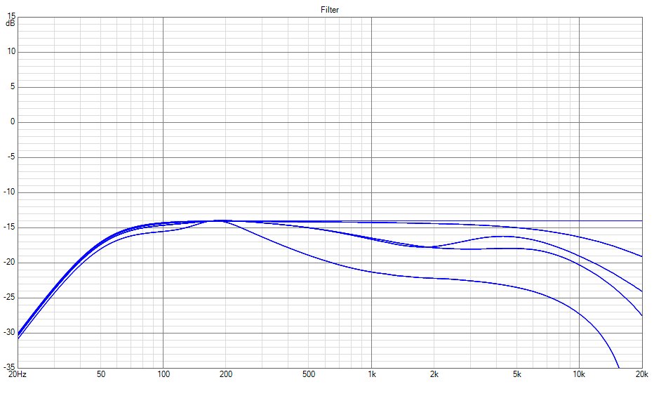

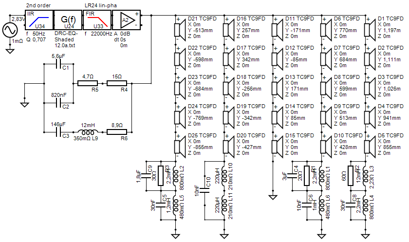

Only detail improvements in the schematics. Trying to balance the frequency response over the entire range. This could be the winner. I've tried many things so far.

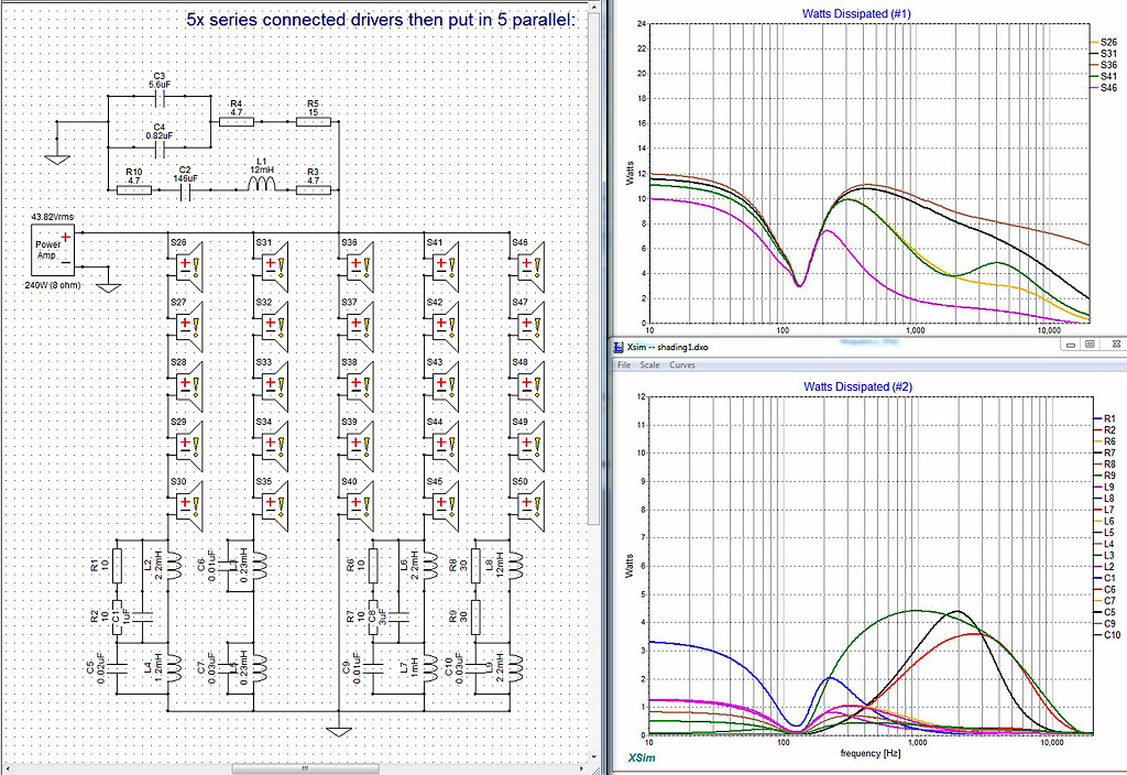

The schematic:
Completely done with passive components. That was my goal.

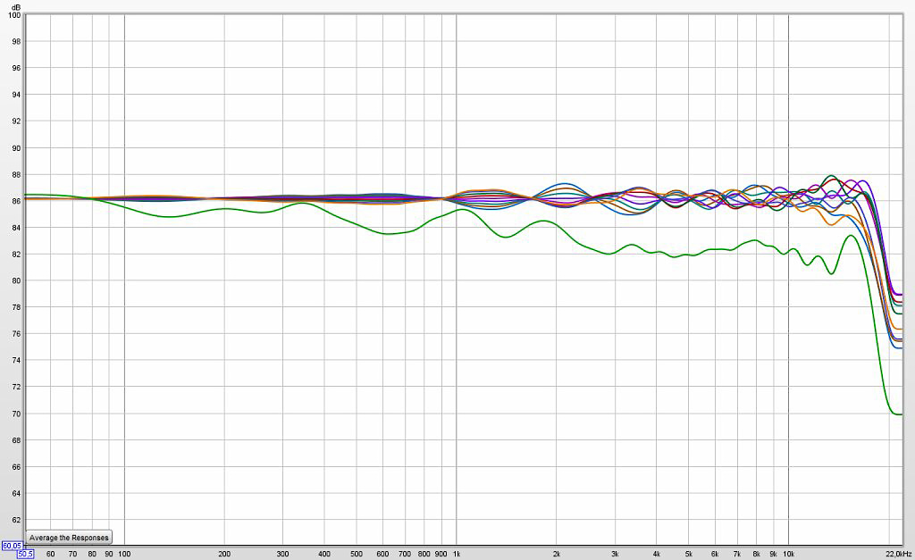

The shading in a pretty graph:
(prior to applying EQ)
5 drivers sharing the top end EQ load (not stressed more than in the unshaded array, even one dB less EQ). The next group is divided with two drivers above and three drivers below the central group. Gradually reducing output, but I have to maintain some of it to maintain decent performance standing up. Next up, 2 groups of 5 drivers, the top group has been adjusted to maintain the standing performance, bottom one is optimised for the listening window below 1 meter.
One more group, making it 5, that only helps out in the bottom end.

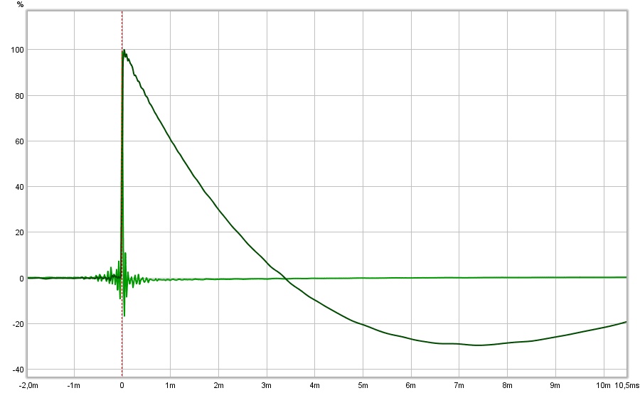

IR and STEP (shape of STEP determined by the cut-off frequency of 50 Hz)

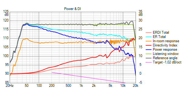

Trying to show the differences between using a single driver vs an array, in room.
Let's do some simple sims. First up, a single TC9 in vituixcad (because I have the model in there already) and 1 watt power on that driver (2,83 volt output):
Now let's look at an array of 25 of those drivers, in this example they are representing a frequency shaded straight array (just because I'm playing with shading models in vituixcad at the moment). To get the same 1 watt on the driver, I need to output more power in the total array, which still has the nominal 8 ohm load, 5x parallel and 5 groups of those in series (14,14 volt output, to reach the same 1 watt load per driver):
So with the same 1 watt load (but this time on all drivers) I'm 10 dB higher on total output potential. Despite the subtractive interference. But I'm only looking at output potential. Not efficiency for one watt.
So I do see more potential for the array, even in the top end of an arrayed driver.
These sims do have a reduced floor and ceiling influence 'on' and both would need EQ to be flat in room, but look at the pro's of the array. Less influence from floor and ceiling and still a lot more output potential overall. Despite the lower efficiency of the array in the top end.
Basically, it can eat a lot more power before we get into trouble. It will be louder, no doubt about that! And judging the graph of the array should make clear that the midrange would only need a fraction of that single watt on each driver to match the output of a single driver.
Just some food for thought...

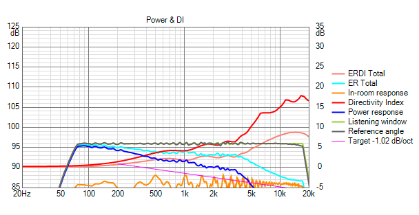

Let's compare the different heights of a single driver vs the array:
Clearly, a single driver could be considered well behaved vs the array. That is, if one takes the necessary EQ steps to get this in room result.
The dynamic difference is close to what you could expect, each one of the drivers in the array are getting by on less than a watt (each), despite the used EQ. Its SPL level is 10 dB higher than the single driver.
If we boost up both to see the max SPL figures they can safely reach at 2.7 meter:
Single driver at 15 watt... orange line is SPL level in room. In all honesty, the curve below 160 Hz is exceeding maximum power for this driver by a large margin. It had a 12 dB boost at 80 Hz to make it flat to that figure of 86 dB. Above about 160 Hz there is minimal EQ (boost) needed
Now the same graph for the array:
Every separate driver of the array is getting no more than 15 dB. So still within its limits. Quite the difference in SPL capacity.
(again, look at the orange line)
Now not all room anomalies are factored in here. Meaning in real life we won't be able to get this much, but it clearly shows why listening on the array at about 85 to 87 dB on average is a pleasure, and with the single driver it could become torture at those levels. The array has enough headroom for peaks while staying within the limits of the drivers used.
It can eat up to about 240 watt before exceeding these limits. Boost here is down to 50 Hz, I used up more headroom by boosting to lower frequencies. With the subs added, I can reach my goal of 105 dB in room (for peaks) without stressing the drivers. From a very low frequency (below 30 Hz) up to about 17500 Hz. That's where the dynamics observed come from I'd say. At the average the drivers are just loafing around. 20+ dB of headroom for peaks.

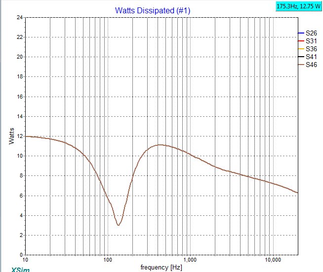

I've put the schematic into X-Sim to see the load on each component.
Looks like a 10 watt mox resistor would be enough for even the biggest value needed.
One driver presented from each string of drivers. Comparing it to an unshaded array:
So the load on the 5 center drivers playing full range does not change (as expected). The resistance of the air coil determines the output on the low end for the upper 5 drivers. (that are mostly just helping out on the bottom end)
I guess an iron core inductor could be used as they don't contribute much to the midrange. Just to get the resistance lowered while keeping the price of the inductor reasonable.

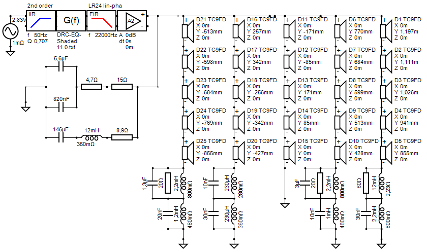

I've made minute changes to my last attempt. It's hard to see any difference, but I'm aiming to go back to single point correction, while keeping a balanced sound over a wide area. The more tight bundling of the top end should help to achieve that goal.
The schematic:
As seen with this 2 dB scale, it doesn't look bad. I hope I word it right to show the bundling I was after. It rotates across the (average) center line and mimics what an unshaded array looks like. It's even better behaved over a wide area and has way less true peaks and dips than the unshaded array.
The plots are covering plus/minus 10 cm around the 1 meter listening height with 2.5 cm steps. The 'standing' plot is at 1,7 meter.
You'll be hard pressed to see any true differences compared to the last plots I posted. Minute changes that I feel will help the overall result and goal to get effective correction made at a single spot (or maybe at ear positions).

The schematic:
Almost ready to order components. Someone needs to try this, right?
Disclaimer: I do not do this because I'm not satisfied with what I've got so far. It's merely curiosity driven. I need to remove my speakers from the room anyway, so I might as well give it a try. It looks like the work on our living room starts next week, so time to move the speakers out of the way.
It will be a while before I get back that living room space and will learn what it does exactly. So don't hold your breath.

It should. You are describing a continous line source. Put that in a room with reflective floor and ceiling and you have the mythical infinite line array.
All the ripple in the FR of a discrete line array can be traced to the spacing between drivers. But the equalization to smooth out that ripple is position dependent so once you smooth it out, you no longer can have the same response at all heights. Its the same catch22 as getting rid of the ripple by shading.
