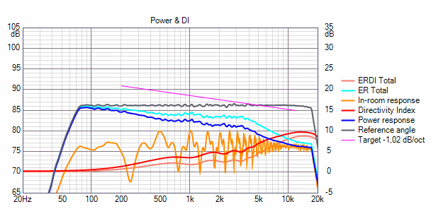

Indeed the dark blue line in the middle left graph is the Power response.
We're only changing the vertical directivity, horizontal should not have changed.

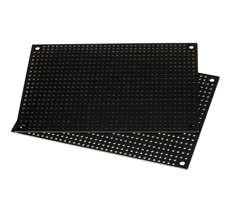

Thanks for the tips on the crossovers. I plan to go for the phenolic boards with zip-ties.
I'll check if I can get them into the enclosure due to being somewhat wider than desired.

With most of the fibreglass or phenolic boards they can be made smaller by scoring a line and snapping the board. That could be done with a sharp blade or a blade in a multi tool or angle grinder.
Lots of commercial boards are designed that way to be snapped off.

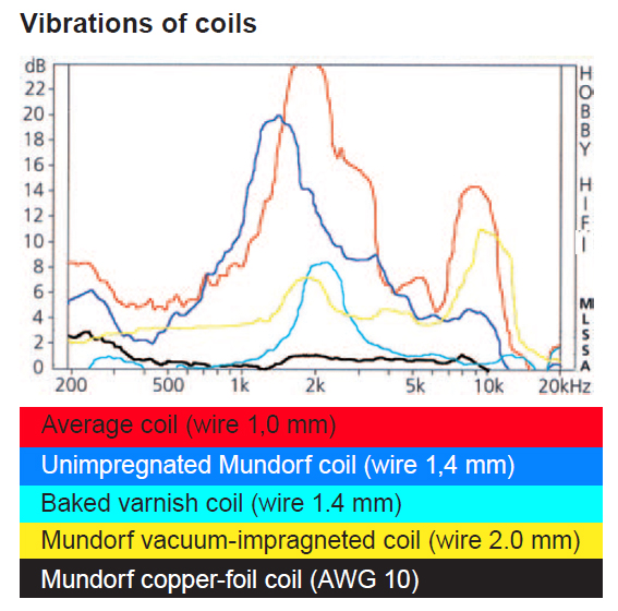

I think I found my answer on the coils. The Mundorf air coil series is baked from the BL series on while the Jantzen coils are baked by standard:
Air Core Wire Coil - Jantzen-audio.com
I stumbled over a graphic from Mundorf coils that made me doubt a bit. But generally it tells you the most expensive coils perform the best :).
attachment.php
The L100 series has none of the treatments to make it more quiet. It would represent the dark blue coil. The BL series are the baked (light blue) version on this list. It seems the Jantzen are baked already (see link above).

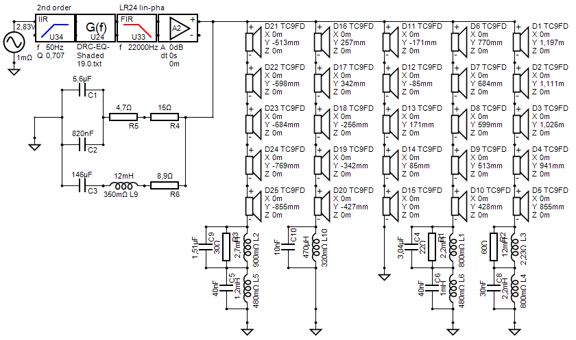

I guess I'm going to find out what this does after all the simulations(*). I just ordered the big bulk of components, still need a few parts that ship right away and those will have to wait for a suitable delivery moment. :)
It better be good (lol). This project is turning into a passive/active setup. The final schematic:
attachment.php
Don't get too excited, as it will take a long time before I'm able to test it all.
I'm kind of curious if other line array users are following this with possible plans to do something similar. My version is balanced for reasonable sound standing up and good sound at seated positions. Or that's what I hope it will do :D.
I still have to source the parts for my 6 channel pré-amp... It's going to be a busy summer! At least I hope to push it all through.... It wouldn't be the first time that it all gets finished somewhere in December.... :bigeyes:
(*)= I just looked it up, I ran 52 separate simulations to come up with the above...

Is it clear what has been measured? Solely mechanical aspects i.e. the coil was exposed to vibrations and then, by an accelerometer? the amount of vibration was measured? Or was there an electrical signal passing the coil, and then the resulting mechanical vibration was measured? Or was the coil vibrated and then the impact on an electrical signal was measured?
I don't get it...
22 dB is a lot...
Here's another link to the graph in german: Mundorf Spulenvibrationen
And I figured Mundorf would be proud enough to say something:
Anmeldung zum Informationsservice
Sadly they did not publish the article at that time... but they did mention this:
Auf Wunsch senden wir Ihnen gerne den kompletten Testbericht zu.
So an email to Mundorf might give us the original article...
I filed a request for the information in the contact form at Mundorf.com.

Any idea at what level/power these coils where measured?
Absolute levels are needed to determine audibility of the own accoustic noise generated by these coils...
btw, I also heard sound coming from capacitors, would be interesting to see these measured also.
But... this all disappears with active cross overs :D

Article on vibration. Looks very convincing, but can I hear it when the coil produces 20 dB? No!
The question remains whether the vibration affects the sound? According to my test, rather no.
When searching the Internet on this topic, you will also find contributions from members of this forum who do not consider this vibration measurement to be meaningful, but also those who say that film spools have advantages in fine drawing and dynamics.
Anyway, I can rest easy.

How could a vibration test look like? At Kirchner Elektronik there are the small accelerometer electret capsules. If you measure in a quiet environment, you should be able to measure the vibration directly on the wire winding. One would then only have to measure with a defined signal. The resonance frequency will stand out clearly. A sliding sine offers itself. One would measure the "vibration impulse response" of the coil. Unfortunately, very high currents are needed again. Or should the whole thing be measured at 1W at the 8Ohm chopper resistor?
Differences will certainly be audible in the whole box. But they are the same for every pair of the same structure. The sum of the tolerances changes a lot here.
Why should a film spool sound more spatial than a wire spool and not a wire spool more spatial than a film spool?

The measurements were probably made with a button at one point. This was criticized as insufficient and laser measurements over the entire "outer skin" were suggested, but it is probably too complex.
I am not convinced of the influence of the coils on the room.

btw: Is the scaling of the ordinate safe in dB SPL?
A switch makes a lot of noise! At high outputs, the PA switches sing along well. How critical that is in a box then ....

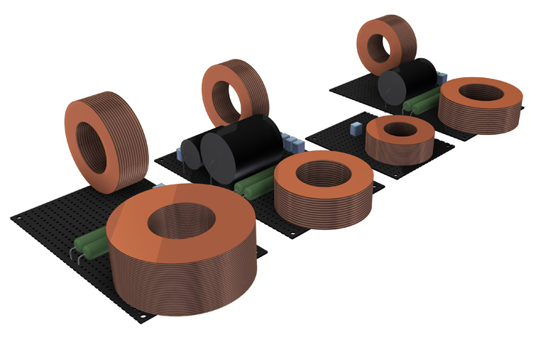

I think you could argue that there is no way for the coil to move/vibrate except in reaction to magnetic force exerted on some external object - such as another, nearby coil. But if that is happening, you've got the coils too close together for other reasons.
Audibility is another issue. No one who has heard transformer hum can be blamed for concern about the possibility of audibility.
Basically the coil construction could have an effect on how prone it is to make noise. At least that's what I get from the graph. In that light, I was comparing the Jantzen coils to the L100 series from Mundorf. The L100 does not have the baked (better performing) construction, yet the Jantzen does mention it on their coil construction.
In that light one might conclude you don't want it mounted rigid to a hard surface? As that might amplify any sound that it makes.
I have seen the Troels measurements of mounting coils close together: Placement of coils in crossover networks
So my intent is to have the coils separated as far as my boards allow it, and have them aligned like this:
attachment.php
(and as far apart as I can get them)
