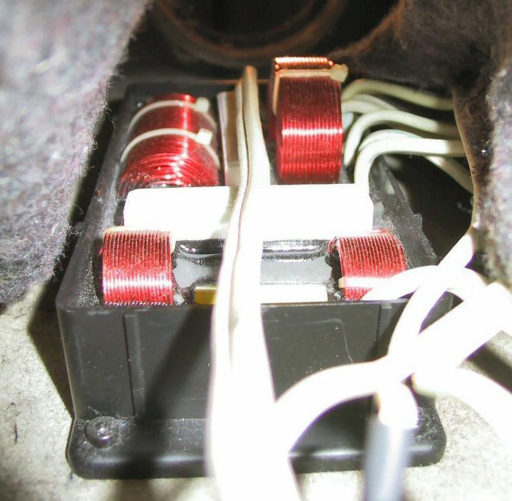

There is always someone who has tried it, it seems...
B&W diamond head crossovers, glued and tightened with cable ties...
Troels: glued... (with something much like Polymax) Tips and ideas Copyright 2012-14

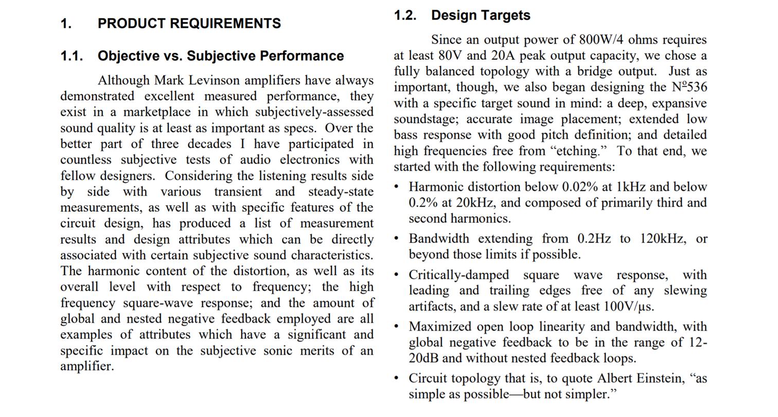

This is a screenshot of the intro to an AES paper "New Design Methodologies in Mark Levinson Amps" I thought it would be interesting given past conversations here about amplifier sound quality. The author claims to know what is needed for exceptional sound quality and the design targets for achieving them are daunting.

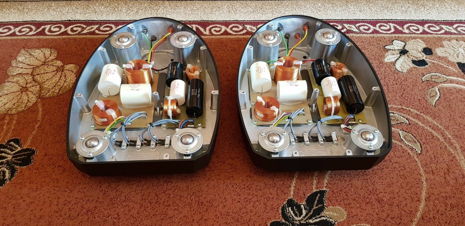

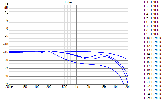

An impression of the first board:
(so something is happening at last...)
Originally I was opting for a bypass cap for the ClarityCaps, as I did order more Vishay MKP1837's than I needed. But after reading many threads on bypass caps in general I decided to leave it as is. I think I may have been reading too much Cap reviews and got into that "groove". You know, the rating cap kind.
As is, these bigger caps are there to lift the energy back up again around 4-5 KHz to be able to balance the "standing" performance. The row of Vishay caps on the right are responsible for a quicker decline than a coil by itself above 10KHz (using them as a notch that centers around ~20 KHz).
As all caps are sort of bypassing the coil or coil/resistor I guess it doesn't even make sense to think about using bypass caps like the Vishay 0.01 uF. On a tweeter or mid? Who knows if it ever makes sense at all... I certainly wouldn't know.

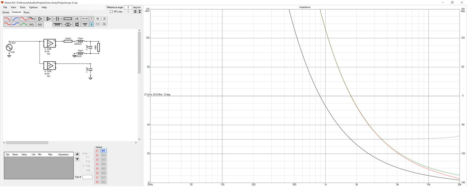

it wouldn't be hard to measure your shading filter frequency response with REW. Replace the mic with a hardwired connection to sound card line input through a resistor divider... It would be nice to know they work before opening up the arrays and that would tell you if your caps needed help.

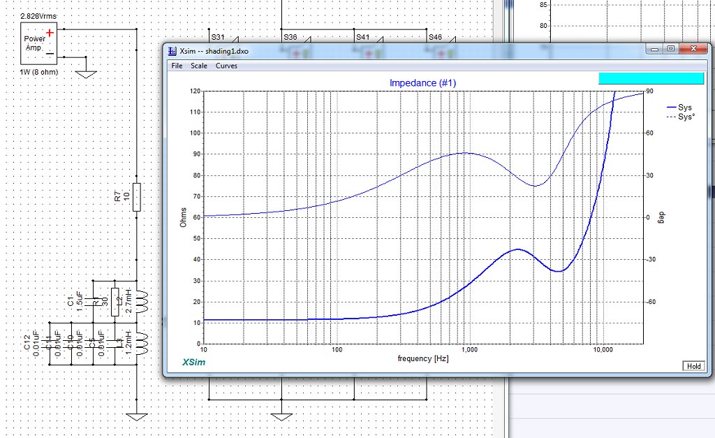

I figured I would check the impedance with REW against an X-Sim prediction like this:
That's basically what you meant right?
Infomercial.
That may be a valid criticism of the paragraphs I quoted but there is meat in the rest of the article.
I retrospect, I think the 200 khz -3db bandwidth target is a subtle dig at class D. Not even Purifi, gets anywhere close to that,or tries to. Perhaps this will happen when switching frequencies are extended to 2 Mhz or so. One wonders why such high bandwidth is pursued, unless the goal is to pass 20 khz squarewaves or cater to the same community that places value in tweeters whose response extends well beyond 20 khz.
Couple of things:I figured I would check the impedance with REW against an X-Sim prediction like this:
Measuring the Z may well point out differences between the real caps and the ideal caps used in the Vituix sims. You could also measure the frequency response directly. At the high end each TC9 has about a 10 ohm Z so you might feed the LC network through a 52 ohm resistor and then run a normal frequency response sweep. XSIM will tell you what to expect. Watch the power real carefully to protect your sound card input. Doing this will tell you how close your filter comes to simulated response without "noise" from room and actual driver characteristics
You could also do a Z measurement of the capacitors themselves. I had to put what I thought were unrealistically high values of ESR, leakage R but perhaps not lead inductance in order to see a difference with ideal C.
The fact that the departure from ideal C isn't visible until high frequency implies it likely doesn't affect the frequency response significantly. The thing to check for is if the measured Z value or frequency response is a function of drive level. I have no idea if that is possible or likely but if it were the case, SQ would definitely be affected. I wouldn't do that without having a resistor pad between the filter and my sound card input.
