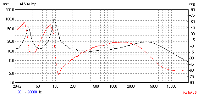

Hi wesayso allow me post this fantastic thread those arrays really got some care and ended stunning beautiful, great thanks sharing.
Let's say the drivers and box volumes are reasonable matched specs. Could it be the different groups of drivers not have same cable lenght, it's a guess one would cut cables to the groups of speakers nearest the common point where amp low z arrive a little shorter than groups farther away giving a uneven electrical path to common dampening z and time to stop drivers at same time. Reason could also be drivers need run in time to get same mechanical flex and thereby start/stop synchronicity.
Cable length probably doesn't matter as electrical signals travel ~1 ft (11 inches) per nanosecond. 8 ft difference is 8 ns or characteristic freq of circa 100MHz - too high to show up in the kHz regime. I have seen wiggles on my impedance sweeps and often it was something loose. Like a panel or driver not screwed in tight. You might have cracked basket, however, the wiggles are so small I wouldn't worry unless you hear something. What does the harmonic distortion plots look like? Is there a HD peak near the resonance peak wiggle of 150Hz? That freq is close to resonance frequency of cabinets.
Cable length isn't the cause, as X explained. I looked for impedance plots of line arrays using google and found two that actually confirm somewhat what I have been thinking:

Final Array Measurements
![AllVifaImp.gif](/community/proxy.php?image=http%3A%2F%2Fwww.rob-elder.com%2FLouC%2Fspeakers%2Farray%2FAllVifaImp.gif&hash=ae7e61e4ab0e5b752c293f25b9545308)
(image from above linked page, by Rob Elder, used for reference)
Here you see the same wiggles except there's also a few wiggles (resonances of the cabinet) in the downward curve.
Another I found:
http://www.htguide.com/forum/showthread.php?31848-New-Home-for-the-BG-Ribbons-Part-27&p=472006&viewfull=1#post472006
![091309-outside-active-805-4020-imp.jpg](https://i21.photobucket.com/albums/b297/chasw98/array/091309/091309-outside-active-805-4020-imp.jpg)
(image from above linked thread, by user chasw98, used for reference)
Same wiggle at reference peak, no cabinet as it is open baffle.
So my take on this would still be the different drivers adding up with series/parallel wiring. I guess if you only used parallel wiring it would even out the resonance peaks. And give you an impossible load for the amplifier.
