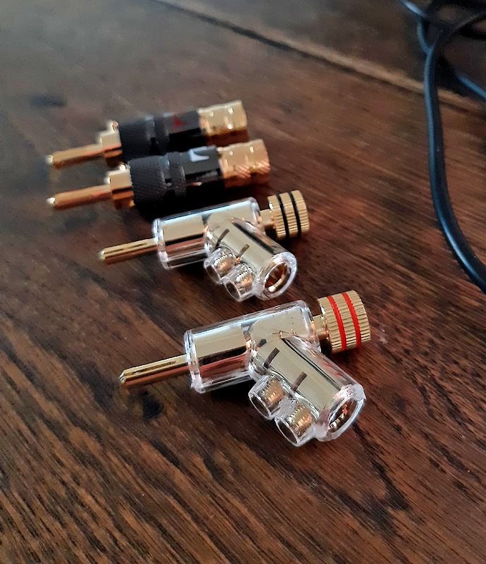

I've ordered 2 types of locking banana plugs, we'll see how they work out...
attachment.php
Both look to be cheap copies of older style WBT plugs. They do not disappoint in my first impression as far as mechanical construction and fit and finish is concerned.
The straight Nakamichi (similar style as the Bluejeans Audio plugs) is a bit large for the receiving wire, but I knew that from a thread on Audiosciencereview.

Which ones did you order. I look for plugs with as least amount of metallic mass in them as I have a hunch that big blobs of metal do not do any good to signal transfer. I find the bananas above has a very good stay thanks to the spring loading that the slits provide. And they are thin and light.
I've heard about that before, but personally I'm not so sure about it. I've read it on this side of the forum (full range) but you should see the connectors on the back of my amp. If it does any harm I guess I actually like that kind of harm 🙂. It did not stand in the way of my listening pleasure. The thing I worry about is ensure a good electrical connection. So I'll just have to remember how a former fellow worker used to wire things up in our industrial applications.
(using crimped cable end sleeves, locked with one of the screws, cable kept in place by the second screw. Exactly as described in the WBT manuals)
I did find a test that showed a simple style terminal block actually had the best (lowest) resistance values.
(as long as it was re-tightened at least once)

i dunno 'bout the blob of metal not good for signal transfer thing but i'm onside with good quality low resistance contacts as someone who's done PA work for years, a good quality locking connector is worth it's weight in gold (hence big blobs of metal, the heavier the more costly)
but at the end of the day, for long term i like screw terminals...

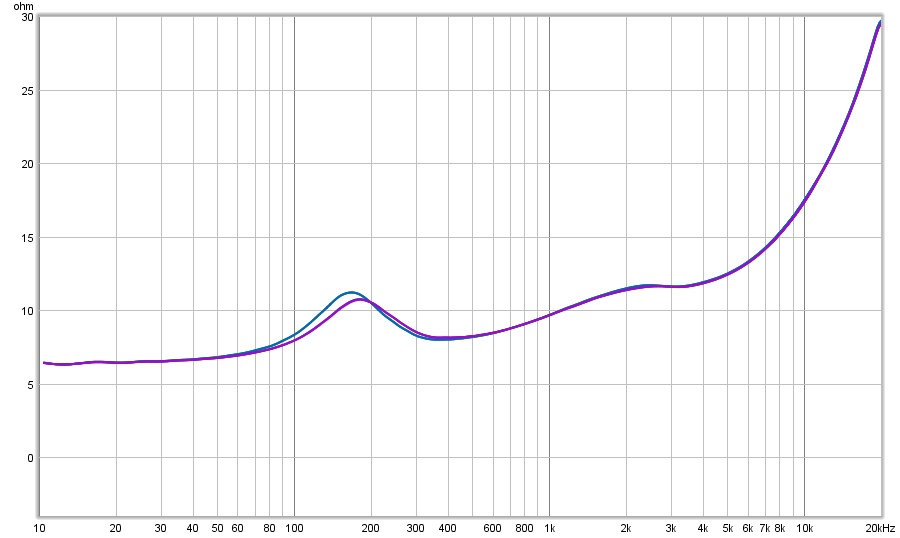

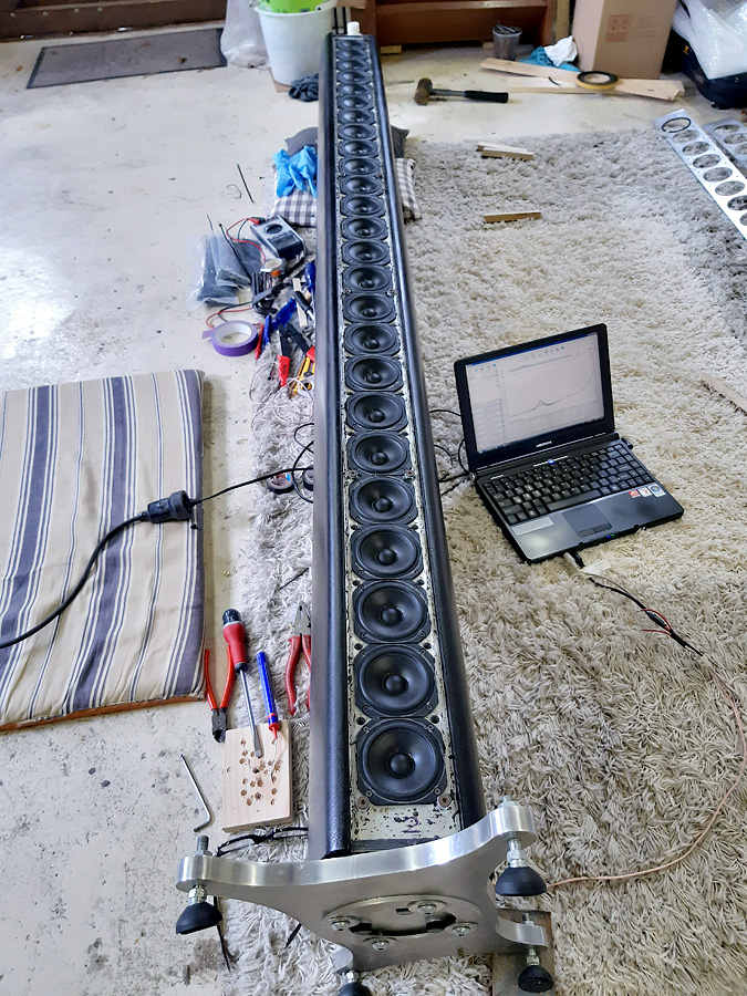

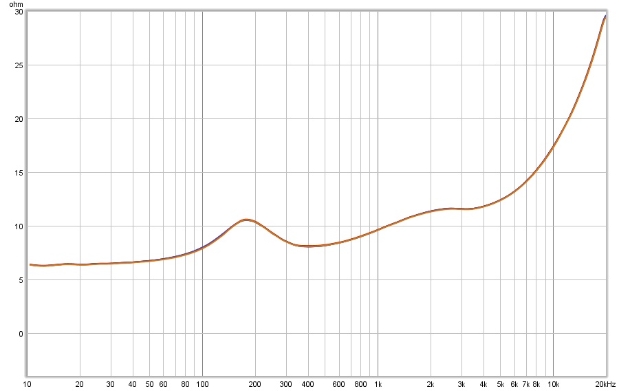

I closed up the second array today and finished the impedance control measurements.
attachment.php
I could not figure out why the measurements of this array differed so much from the first array:
attachment.php
So I set both arrays upright again and ran the impedance tests one after the other:
attachment.php
attachment.php
(there's actually 4 measurements in there, 2 of the left and two of the right array. So they are close enough to call them the same.
I guess the temperature plays a large role here. It's chilly today but I wanted to finish this up)

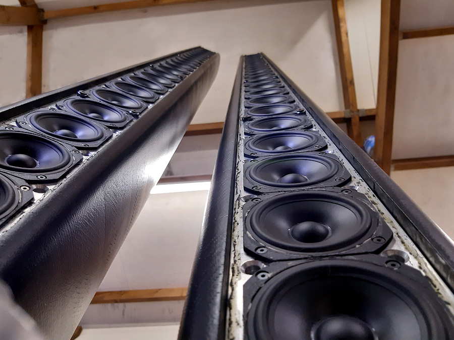

The up close picture shows why I want to refinish the outside. The fiberglass mat structure and some seams show through the outside paint layer.
I will sand them ever so slightly and give them a fresh coat of epoxy (+ glass balloons) and paint.

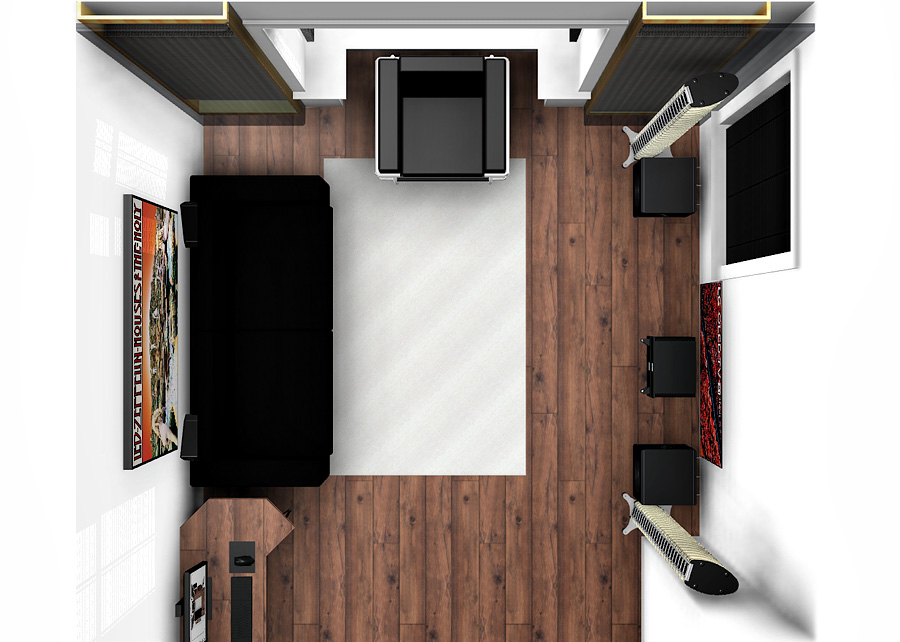

I also measured the toe-in angles and corrected them to match the sim predictions and setup drawing:

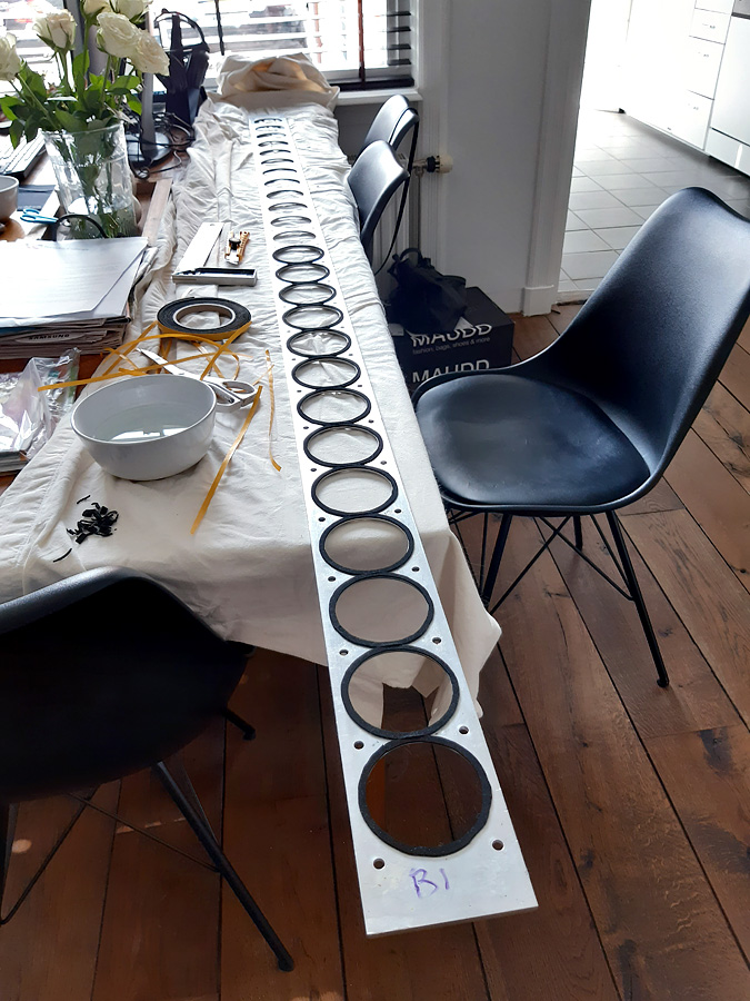

Cutting new seals for the front baffle to replace the front seal that came with the TC9 FD18-08.
attachment.php
Temperatures were low outside, so some in-between work to keep the idea of making progress. I have to say, seeing parts on the table again brings back good memories...
Even though this time it's just a filter tweak, the anticipation of what is to come feels familiar somehow 🙂. Parts keep rolling in to finish the speaker cables.

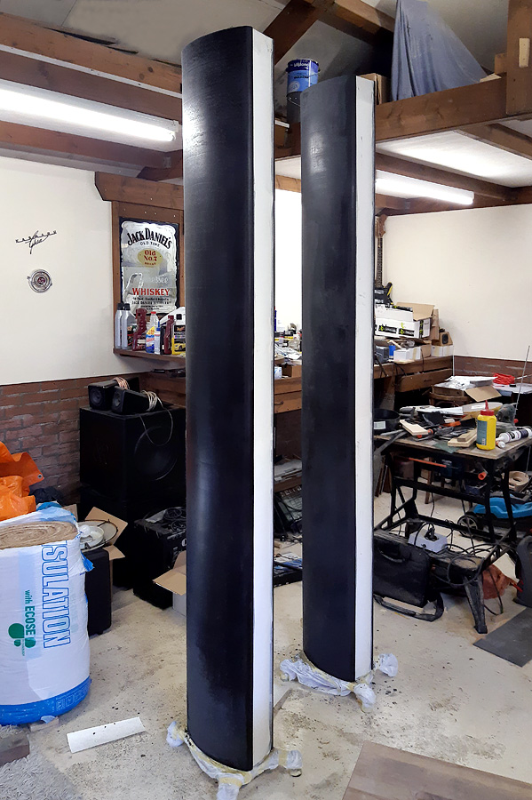

Preparing for a fresh coat of epoxy + paint...
attachment.php
It does look somewhat familiar. Don't mind the mess... I haven't taken the time to clean up yet. That will have to wait until the arrays are finished. 🙂
Sanding not quite done yet, but close. Maybe a first coat on Monday, then finishing up the refresh next weekend. Hopefully it will be quite a while until
I dream up the next update. 😀
More sanding done today... I can't help but feel a bit proud, having build these 🙂.
It was done in a crazy period in my life, but I did get to build these to be proud of...
I think I'll manage an even better finish this time (practice makes perfect) and with the new addition of the added filters make them (sound) the best they have ever been.
I simply have no regrets (at all) of all the hours I've spend on these monsters. I've enjoyed this journey and have learned a lot from it in the process. Looking forward to put them back in action, I'll take my time to do every step once again, because I've learned it is worth it. In my humble opinion, the concept is solid and well worth the effort.
It truly has become a labor of love 😉.
