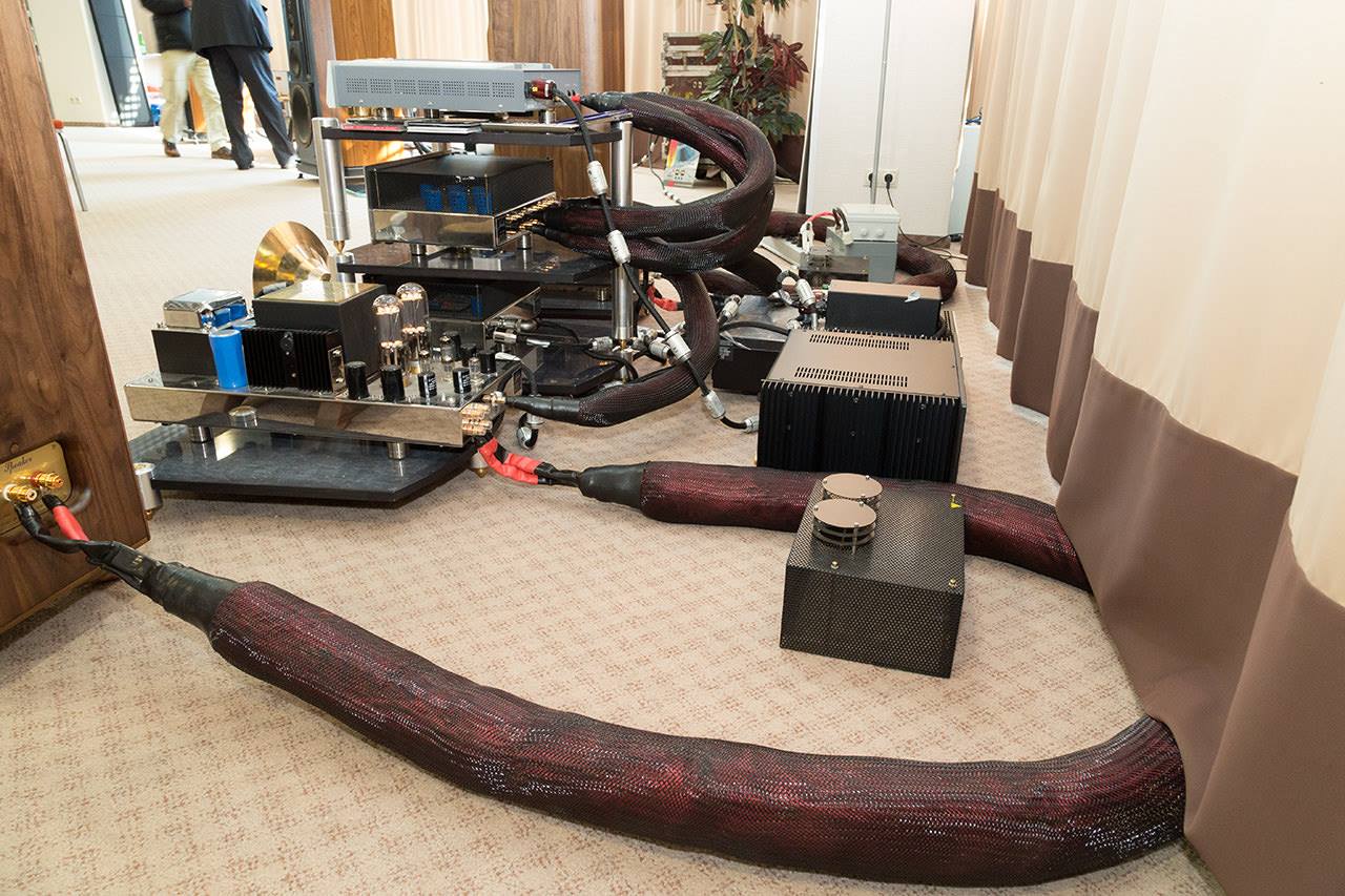

Need to be focused and get it right, you guys will have to intervene once I start wiring up the speakers like this though:
Those are full of more than snake oil... Full of $h17...just what are these anaconda's of wiring composed of .....(bet we could extract a few years of snake oil outta those !!!)

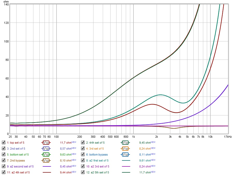

First bypass is in, I guess the second will follow tomorrow. Measurement checks out.
