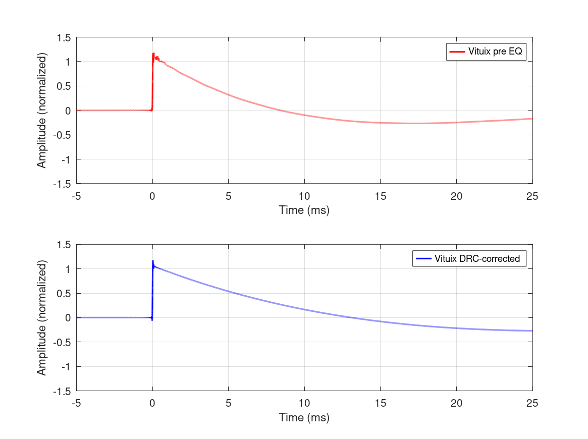

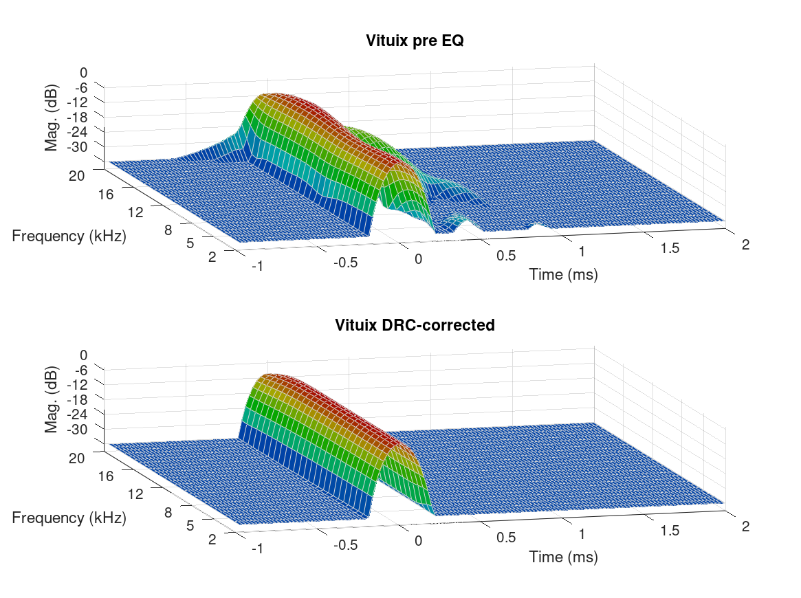

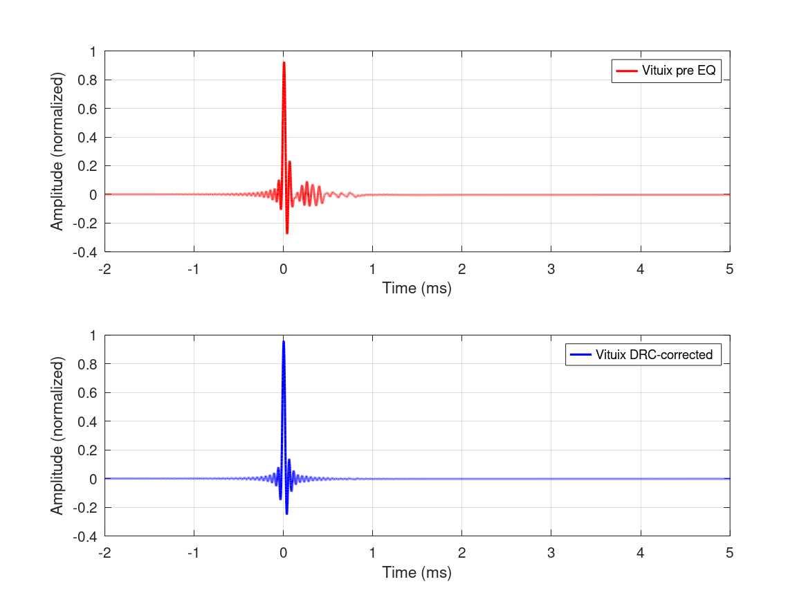

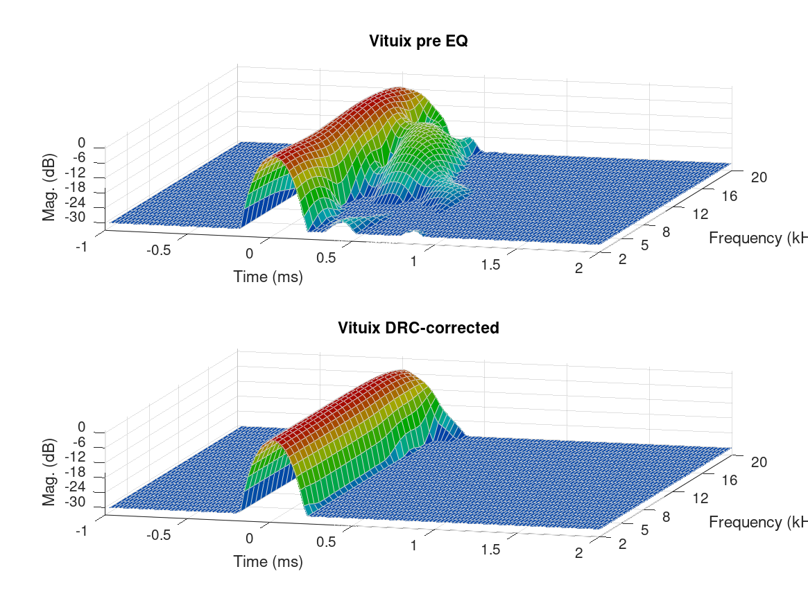

Inspired by a post from emailtim I ran some Octave scripts as supplied by DRC-FIR.
I ran the script comparing the sim data I used in Vituixcad to get a comparison between my pré-EQ stage and after running DRC-FIR.
attachment.php
attachment.php
For this to work I did have to jump trough various edits, probably because of short files used etc, as they are not representing measured data but are limited length files I used to sim my arrays.
But my newly created template for these sims seems to work quite well.
attachment.php
attachment.php
(this is a pure minimum phase correction, on a Vituixcad simmed line array, which is why it looks this clean)
The resolution of these seems limited compared to just importing the IR into REW. But they do provide a view from both sides, something I've always wished for within REW. As I already nagged John about the wavelet mode that made similar plots to APL-TDA and getting a user adjustable "span before peak" in these wavelet plots (to be able to see pré-ringing for us digital DSP users) I didn't dare ask for a 'kind of a reversed' waterfall plot, showing us the pré-peak area where ringing would occur. I still think that would be interesting and useful to keep an eye on, but the above Octave graph tools do not seem detailed enough to provide a solution.

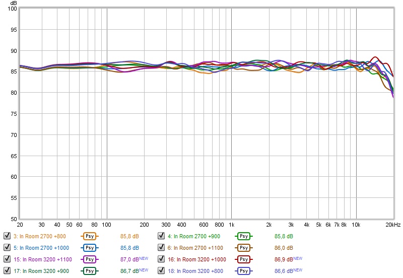

I also decided to check a 30 cm listening window, at listening distance of 2700 mm and 3200 mm. Here's the graph:
attachment.php
It is in these simulations that the filtered array does wonderful compared to the unfiltered version all throughout the frequency band. Very little variation overall with 2dB set to floor and ceiling absorption.
I did realize the simulations from Vituixcad will differ from reality on a couple of details. All trends I did see in my measurements do show up, but the exact behavior will be slightly different, as the floor and ceiling will play a role in lengthening the array behavior. One of the old sims where nc535 had a copy of the array below the floor showed the most similarities to my measured results. That's when I started to take notice and join the sim fun. The floor and ceiling settings do go a long way to predict the in room response, but actual results will vary slightly.

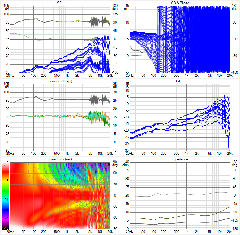

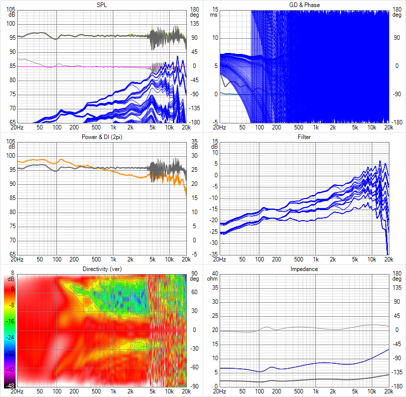

I probably will, though this experiment did prove that the in-room calculations using the simple floor and ceiling settings in Vituixcad match well with the actual 'under floor' model. It does change the final needed FIR file shape as the floor mirror does work to make the array seem taller.
If you want to see what you can expect, as far as the IR goes, model that under floor and above ceiling mirror. As that would be a quite close match to what one measures out in the room. The 'Total SPL' IR can be exported as a wave file, while the 'in room' results are simpler text results.
The modeled mirror array's will show you all the 'warts' you will see when you measure indoors. Flipping trough the waterfall settings can show you what that does over time. I've done that a million times on real life measurements, including many of fellow array builders and it is cool to see the Vituixcad model resembling that behavior.
It also makes clear why a FIR correction with a frequency dependent window, like DRC-FIR has is superior to just EQ-ing the in-room frequency curve.
In other words: worth it to learn from.
EDIT: if I had tools like Vituixcad when I started with this build, I can't imagine ever getting around to actually building something 😀. There's always something to optimize, right around the corner... Which is the reason I haven't started playing with ABEC yet. Because I do not need any more distractions and I first need to finish what I started 9at least, when the weather improves over here to actually be able to do it. I'm watching the long term forecasts and have plans for a short break from work as soon as the temperature rises 😀.
As expected, right? I just had to try. I don't know how usable it is though. As there are certain aspects within Vituixcad that prevent you to go over 2 meter in the driver placement, but then the actual schematics editing allows you to do so. But once I start moving the whole sequence it goes terribly wrong. I won't start nagging Kimmo to fix that. As it is enough confirmation for me that for all practical purposes one can trust the floor/ceiling settings within Vituix.

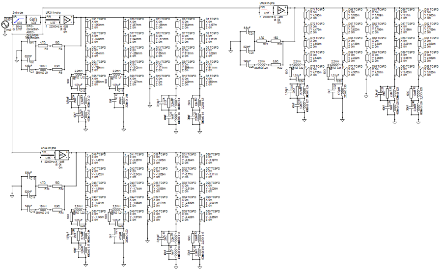

Anyway, here's the 6-pack with proper driver placement and both mirror images:
attachment.php
The schematic is turning in to something unworkable:
attachment.php
Maybe a step too far at this point 😉. But it was interesting enough to try.
