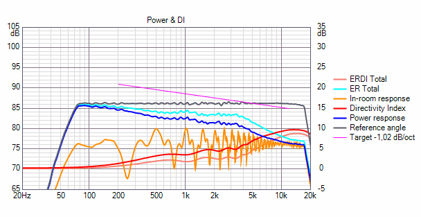

Very good to know that we can trust the floor/ceiling settings in Vituix! Are those the "final" passive networks that you are putting into the arrays now? Surely, many iterations must have been needed to get there. My own are so much simpler but still a huge amount of parameters to tweak. Vituix is marvelous tool, but as you wrote - the endless possibillities can get you stucked in "simulation"-mode forever!
Those are the networks that I'm incorporating into my speakers, yes.
Many many iterations... I numbered them from 1 to 19, but most of those numbers also had an a,b,c,d,e version (lol).
I had to stop somewhere, but not until I came close enough to my goal.
After playing with the separate version, aimed at using a tweeter (just out of curiosity) I even added some tweaks as this did show me what was possible.
A flat response throughout a large area was my goal(*). moving closer or further, up or down. I'm quite pleased with what I got. Even keeping a reasonable 'standing' balance. That part was lower on my scale. As in: less important in my decision making. Most of the listening will be done from the couch, either music listening or Home Theater. So that's where the focus was.
(*) while maintaining a similar overal balance, e.g. not a slowly dropping or climbing result over a large area, as i do know that is something one hears quite easily. Unfiltered arrays have quite a good balance like that, I wanted a result as good or better. I believe I've managed to get just that.
Time will tell if I made the right choices. 😉

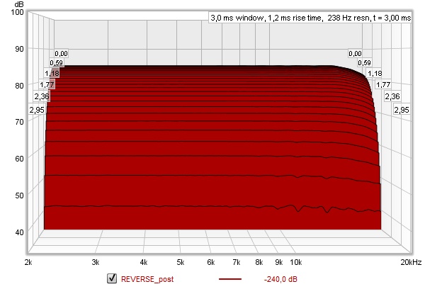

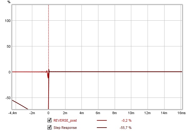

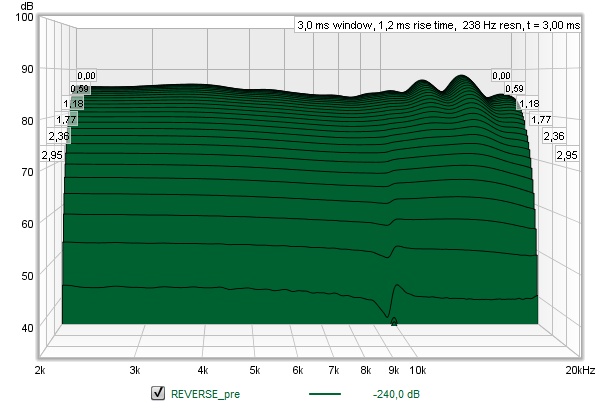

For the longest time I have been interested to find a way to see the other side of my impulse response in REW. You know, a waterfall plot that shows the "on-ramp".
I finally figured out that all I'd need to do is to reverse the audio file and load that into REW. So a quick search gave me this site: Reverse Audio - Audioalter
The reversed Pré IR:
attachment.php
Post IR:
attachment.php
Waterfall plot of the other side of the pré IR:
attachment.php
(notice the 50 dB scale)
And the post convolution IR:
attachment.php
So a simple tool like that would give me all I need... 🙂 A clear view of the other side of the impulse. Now why didn't I think about that any time sooner!

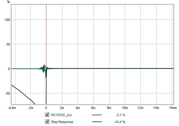

A few days ago I showed this picture on another thread:
931739d1615668058-convolution-based-alternative-electrical-loudspeaker-correction-networks-pre-energy-jpg
It was my way to find the pré ringing output of a measurement/sim etc.

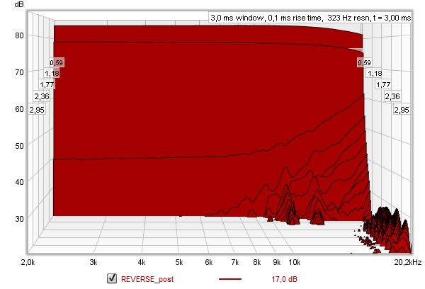

With this reversed IR, we can show it in more detail, with timing...
attachment.php
Using a very short rise time (of 0.1 ms) it shows a very similar picture, with even more detail. This picture
above is the result after processing, I'll post the before picture below:
attachment.php
So it's doing quite a clean-up.

I tested the above on a couple of IR's, works like a charm to "see" the other side of the waterfall plot. Now why didn't anyone tell me that earlier 😀.
It was such a "Duhh" moment yesterday, when it finally hit me how simple it really was... Indeed i can do it within Cooledit, and probably many other packages. Anyway, glad it finally came to me as it will be of use to me to see things like pré-ringing or in a case I'll try my hands on cross talk cancellation again.

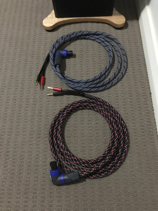

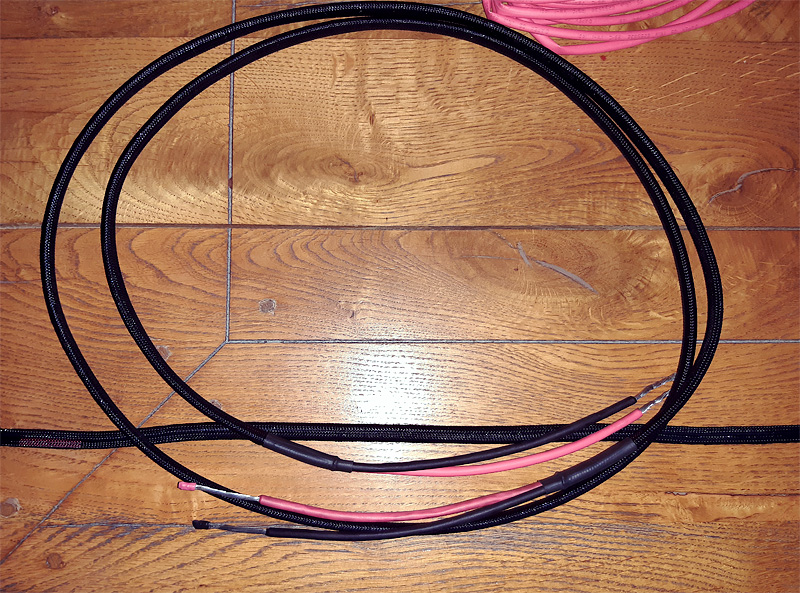

New speaker cables under way. 4 Square mm or 12 AWG, tin plated copper cable. Dressed up with Techflex as promised. I've wondered about the best termination though. Spades, banana plugs etc. Up until now I've always used bare wire ends. I figure that would suit the non corrosive wire ends of this new set as well. Most banana plugs would feature set screws anyway, with isn't dissimilar to just tightening down the current connectors on a bare wire.
The only thing that would make sense is crimped on or soldered spade connectors. But it's one more piece of metal in the mix.
I've also wondered about twisting the wires or just use them as a parallel pair. In the end I went with the last one, parallel pair of wires. Twisting them would lead to less inductance, but upping the capacitance nature.
After reviewing Mr. Pass's excellent paper for the #$W# time it seemed to suit my needs. A coax construction would limit the inductance. However the capacitance would rise. An example of that would be the coaxial speaker wires from Goldmund, using passive correction networks on both ends to counter the raise in capacitance. Not what I'd want to do.
attachment.php
Is this better than lamp cord of a similar size? Well, this one is tin plated to avoid corrosion, and as it is an actual industrial type of wire, it comes with a list of specs it abides to. More than a lot of audio grade wires would give you. 😉
The resistance of this specific wire is 5.09 ohm per 1 km of wire. In the lengths I use that would translate to about 0,1 Ohm.
Without the tin plating the resistance of this same type wire would be 4.7 ohm.

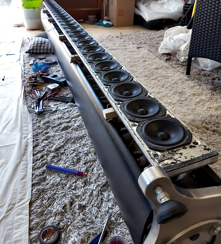

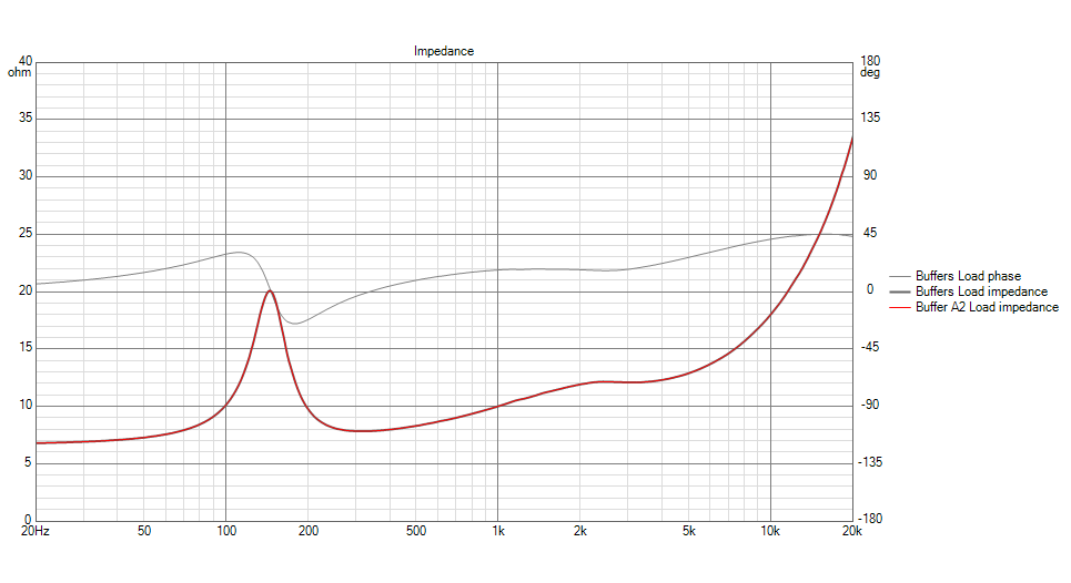

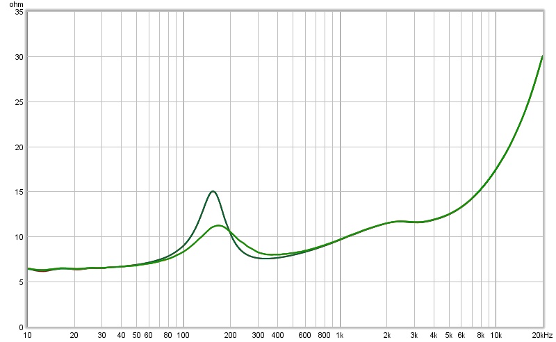

On to the following point of my agenda. Closing up the first array after including the filters. Don't get too exited yet, it's only the inner baffle at this time. I will redo the outside coating before final assembly with outer baffle. 😉
Ran a couple of impedance sweeps, a few before closing up, drivers all hooked up and floating above the enclosure (on a couple of wooden sticks).
attachment.php
Easy to see the difference with the plots ran after the baffle was mounted in the enclosure.
A comparison to the Vituix simulation:
attachment.php
So far it all seems to check out. Hoping to start on the second array tomorrow!

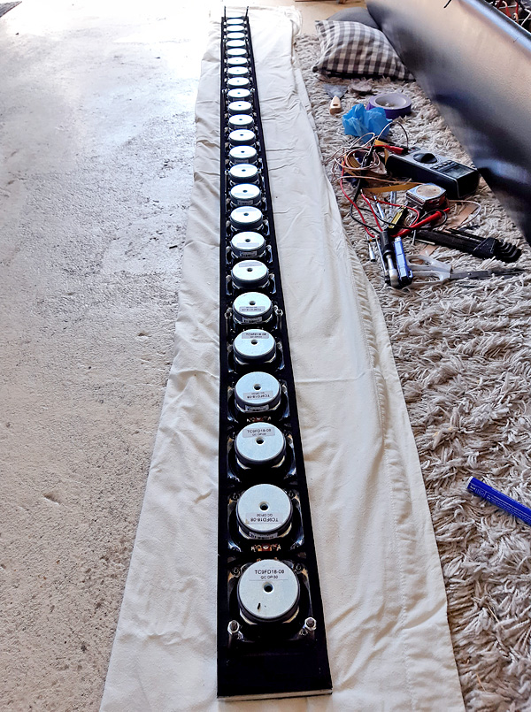

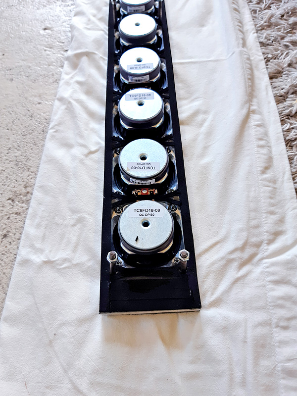

New seal on the back of the inner baffle:
attachment.php
A little closer view:
attachment.php
New neoprene seals between enclosure and inner baffle...
Just before sliding it back in, and first testing the impedance this way:
attachment.php
(still some left over residue of the butyl rope)
That's all the pictures I took today. But I'm happy with the results so far.
Impedance checks out, on to the next...
I'm glad I made it all "serviceable". That made this task a lot easier. Still it's a lot of work, especially if the weather doesn't cooperate.
This is a good week though, and I've taken the opportunity to take the week off from work. I've been eyeing the weather forecast since
the start of this year, waiting for a good time to take up vacation days 😀. It coincides with my birthday halfway the week, so all good!
(nothing is more fun than doing what you want to be doing on your birthday 😉)
