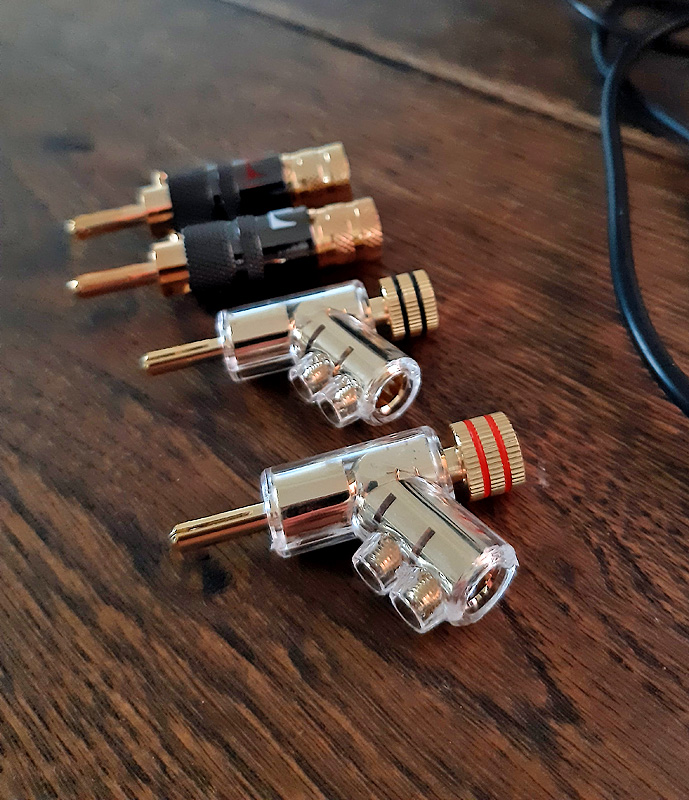

Quite a few pages ago I posted about Banana plugs...
It turns out that the locking mechanism of these wasn't that robust. I've searched for other variants, like the Parts Express locking types, they all had one thing in common: fine threads on a small diameter. So I stayed clear from those too.

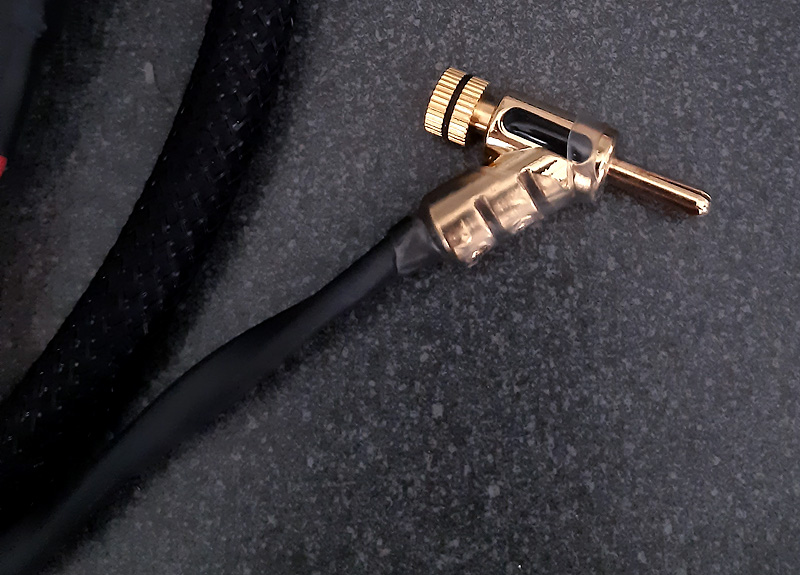

I ended up sourcing yet another type that I use right now:
These have the threads on a bigger diameter area of the locking pin. But did not have a plastic outer shell to protect the body. I used 'see trough' shrink wrap to cover the part of the body that holds the wire.

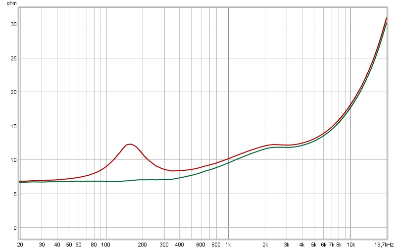

I used spades to hook up the impedance correction. Sorry, didn't take a clear picture of those yet... I might get a few measurements in today, but don't hold your breath just yet (lol).
