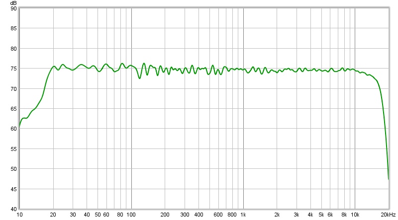

The good news: I've made my first few measurements....
The bad news: during the fitting of the outer front baffle, one of the wires of the full range driver set came loose. So it's not firing on all cilinders after all... .
I had noticed the left side playing (a lot) softer with the old filters, but did not make much of it at that time. That is, until I made my measurements! All kinds of theories crossed my mind...
A lot of difference, especially the top end was lacking! After doing all simple tests I could think of, like swapping amplifier sides etc. I figured I'd start up Vituixcad, sure
enough... the difference between flat and center group missing is what looked most likely:

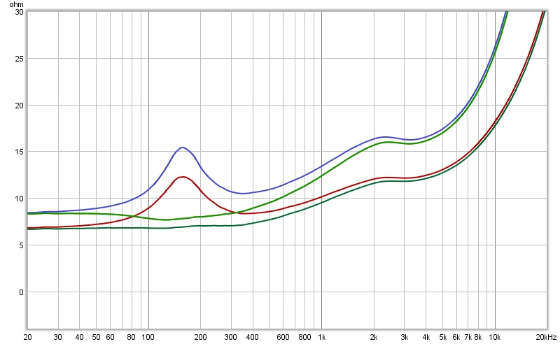

An impedance check of both arrays should be able to confirm that...
Yep! One of these is showing 4 parallel groups of 5 drivers in series! Last time I checked both, they were still identical, but I didn't have the outer baffle on yet.
In hindsight I remember moving the inner baffle on one array 'carefully' (with a hammer!) to position it... a few well meant hits with that hammer...

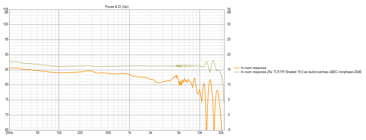

In the mean time I've been reading a lot, but I've also played with the proper working right array (obviously). As said, the Vituixcad sims made me rethink a few DSP decisions. For a while now, I have tried to limit/avoid pré-ringing in my DRC-FIR templates.

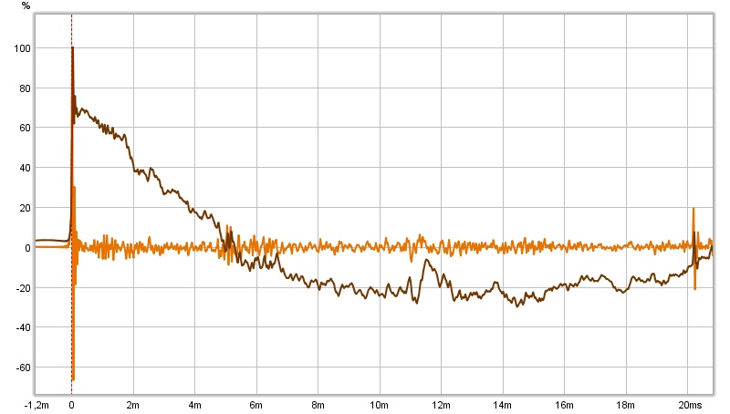

A while ago I said to be interested in the other side of the impulse, looking at how it arrives at the ears, being able to see if there's anything arriving early etc.

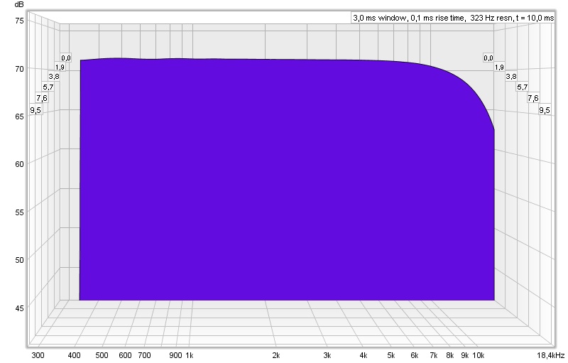

Here's a graph showing the right array, 3 ms Window, Time Range 10 ms, Rise Time 0,1 ms:
Smoothed 1/48, can't turn it off completely. A look at the reversed IR.
I bet I've listened to a lot worse looking graphs than this. This has been an attempt to optimize the first wave front, and let the room have it's play with it afterwards. Only adjusting the (overall) balance when filtered/seen with a Psy filter.
Here's the (non reversed) IR:

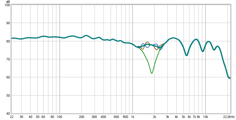

I've also used the measurement to check/see what my latest cross talk ideas would look like with real measured results. Can't wait to really try that! The idea seems to pan out and work to fill the ~1850 Hz dip due to cross talk. With an even response on both left and right ear, no funny differences like previous attempts showed.
In a graph it looks like this:
If nothing is done, you get something close to the light green graph at both ears. Aside from head shading at higher frequencies, that is. My proposal has a fixed signal added to the IR, at about a floor bounce interval after the main pulse (close to ~2ms). Left and right differ (one of them is inverted) and that is why they actually sum favorably. The average of a single channel will hardly be different from an IR without the 'synthesized' floor bounce. Red and Blue traces represent the L and R channels, dark green is their average.
The main part that makes it different from a real bounce is that one side is inverted. As far as energy and FR curves this pans out. The bigger question: how does it sound? Combined with earlier mid/side EQ? This tweak could be done to the left + right signal, but I can also split it out to mid/side.
It will fill the usual hole, and hopefully (phantom) mimic the sound of a signal coming from straight ahead. Together with the mid/side EQ already applied, tried and tested.

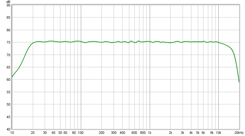

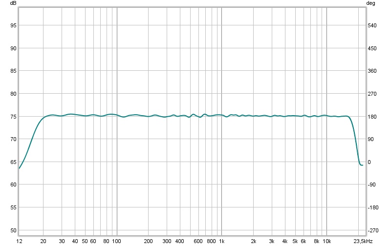

In other news, I've made a correction for the right side and tested it. Sounds good and promising. Here's the FR with psy filtering pré room curve:
Filtered 1/12 oct:
Now back to the waiting game...
