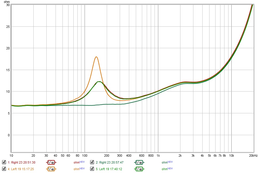

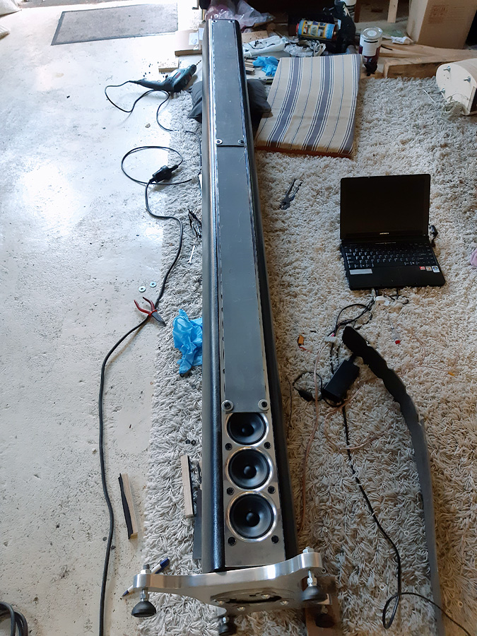

Had my last procedure early morning last Tuesday and I am recovering well. So well, actually that I decided to mount some drivers on the baffle. I got them all hooked up and what do you know....
Again the impedance showed a one group failure. The average low impedance hoovered around 8 ohm instead of 6.something... I figured I must have messed up wiring them all up again, nope... quick group tests showed yet another driver failure in a previously untouched (and fully functional) group.
Enough for this day, I'll call it a bingo and will try not to worry or guess why I lost another driver yesterday. (that's 3 in total)

What's the nature of the driver failures? Open coil?

Closed up the left speaker again, measured it more than once to be sure
Red is the right one, the lighter green the repaired left array. Orange is free baffle impedance of left array.
Looks like she's firing on all cilinders again.
So far, so good. Now waiting for some help to get it back inside. Not going to do it by myself this time.

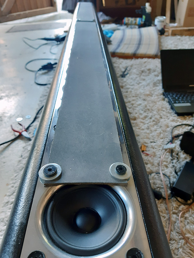

I've got a friend coming over tomorrow that's going to help me move the speaker indoor again.
If, and that's still a bit of a question, if the drivers were damaged from transport, I figured I needed a bit of safety/protection this time. Especially since I'm not the only one carrying the speaker this time.
So I figured out a way to protect the drivers:
That should help prevent little mistakes as to grab a cone by accident...
Need to be extra careful with the bottom 3, lol... I think this should help, fingers crossed!
