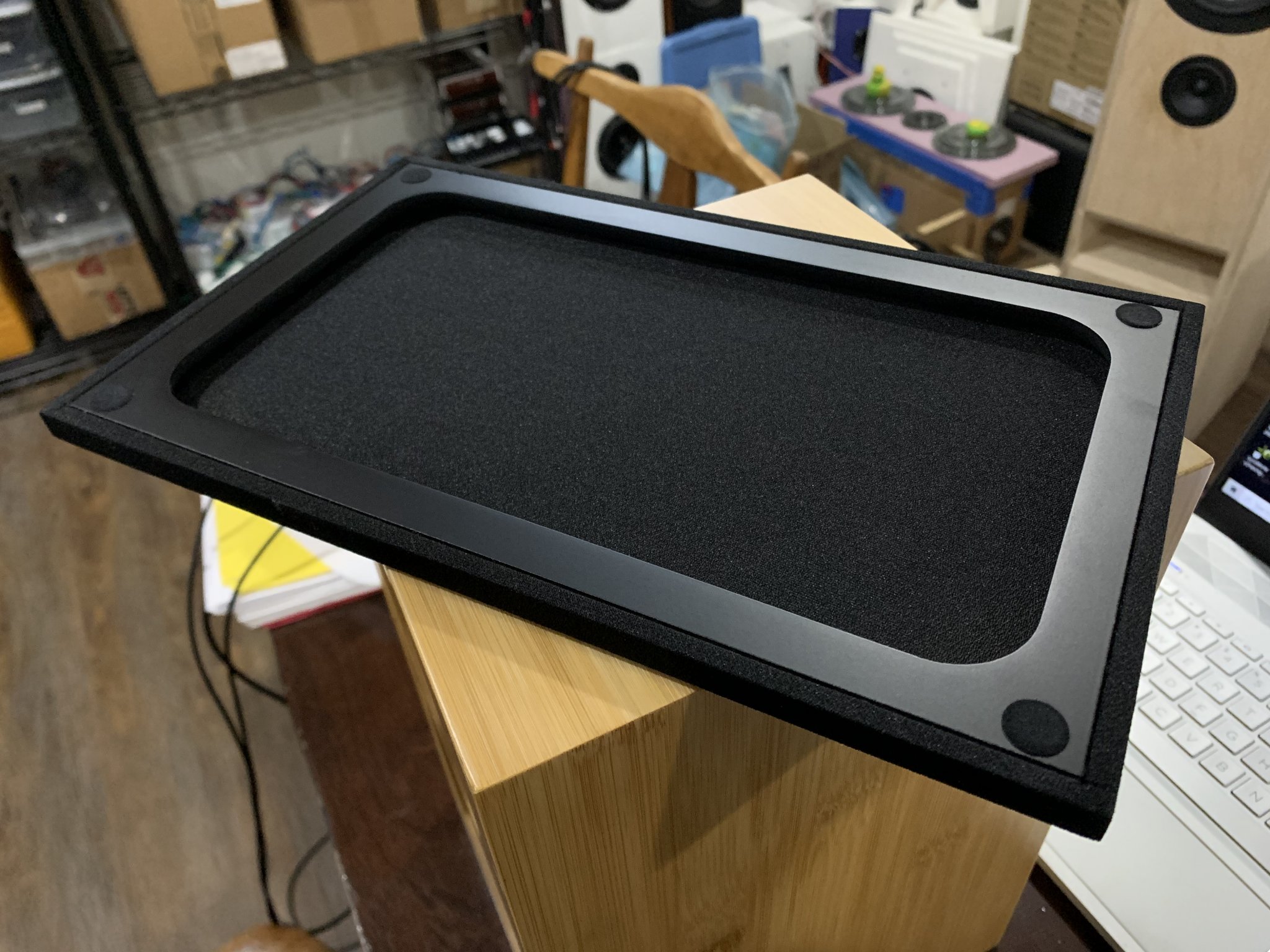

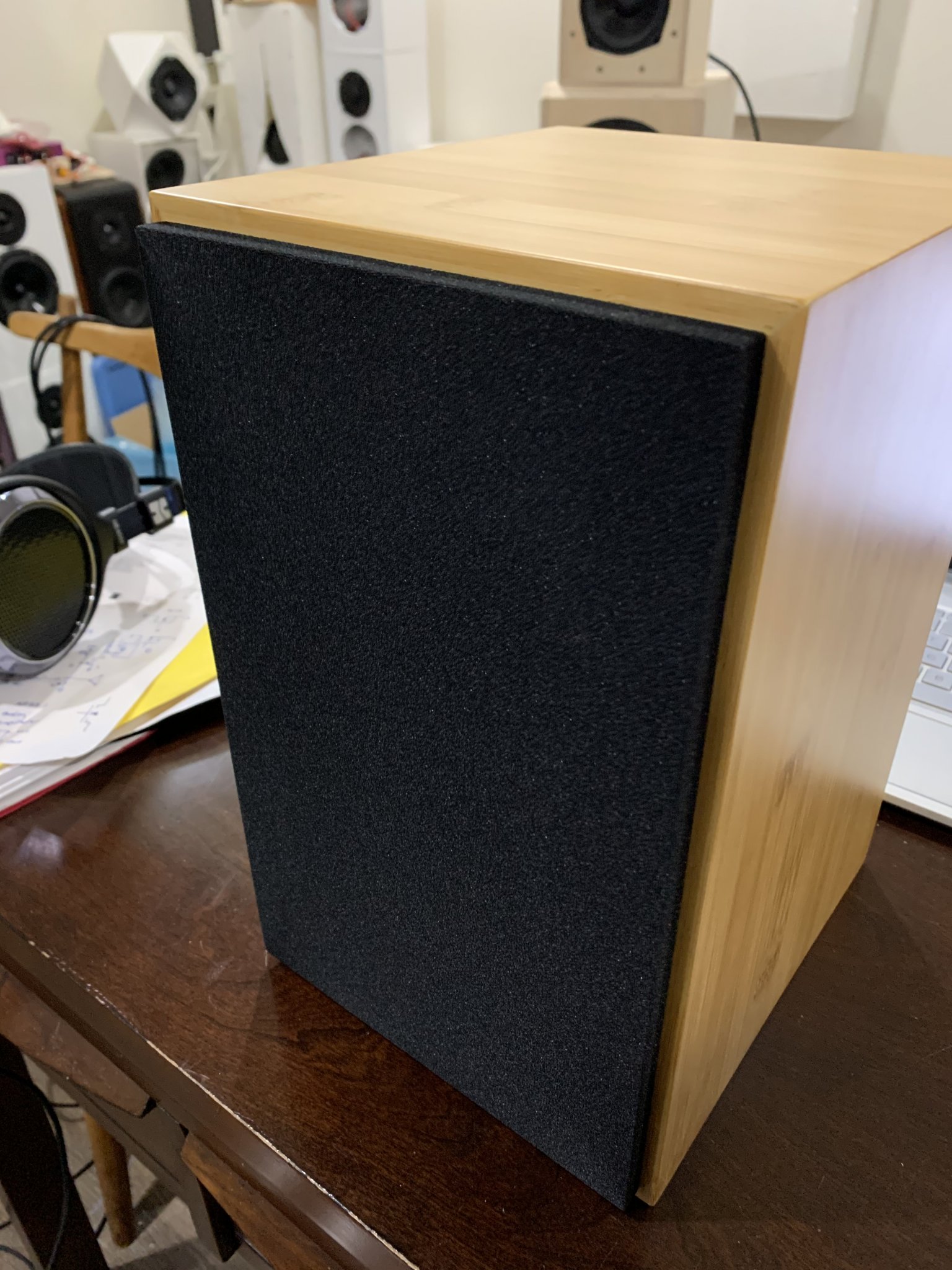

What about a thin wooden frame covered in traditional stretchy grill cloth. The frame would be held in place with magnets. The moment the cat hits the cloth, the whole frame detaches and saves the speaker. Very traditional type of grill. You could make them in 5 sections of 5. It’s more manageable and can be made saw or router and template. I did this on my 2 ways:
