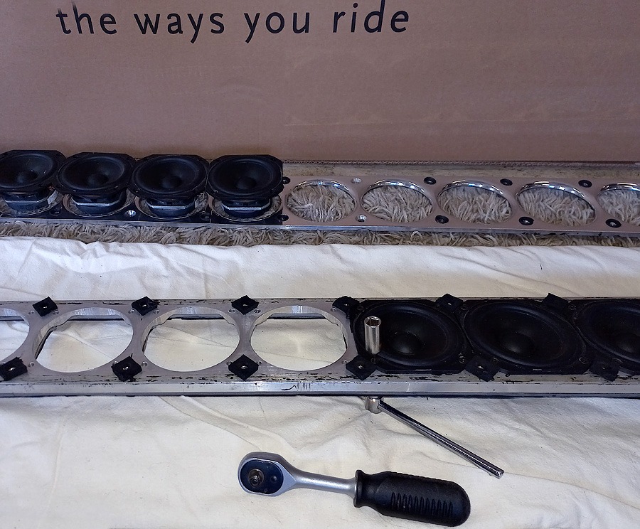

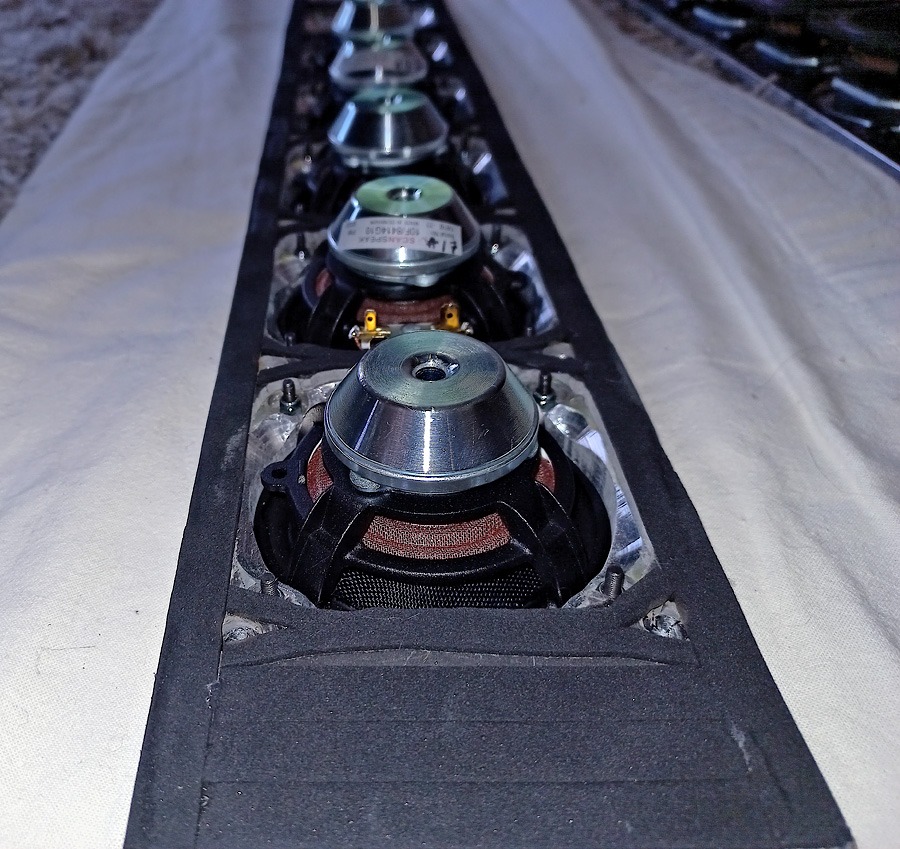

Changed the 3 filters capacitor value that made quite a difference in the top end in simulations with the 10F (compared to the TC9).
Need to place the last filter back inside the enclosure and then on to replacing the drivers...
Sorry, no pictures as it's all covered in wool fibers it doesn't look that good anyway. Basically, the outer driver groups get filtered steep
which makes the top end (the 5 unfiltered drivers) perform a little better.
Practically it meant raising the capacitance of the last step on those 3 filters. @ of them from 40nf to 60nf, one from 10nf to 40nf.
That's all the change the filters needed to accommodate the 10F drivers. So no large overhaul, just some minor changes.
(still a lot of work though)

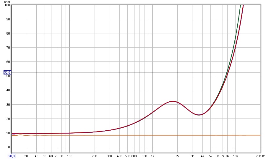

An example compared to (measurements of both of) the old filter(s):
The green one being (one of the measurements of) the new result... only the top end deviates...
(in reality you're looking at at least5 8 different measurements of 2 the original filters and one modified filter plus a simulated result using x-sim
these measurements are my quality control, a way to check the simulated filters with reality and against each other if one builds 2 sets)
The orange line is the 'load' resistor of 8.2 ohm (to be able to measure the filter with a load). In reality there's
two of those straight lines as well, one of the old measurement set and one of the newer set made today. (my reference)
