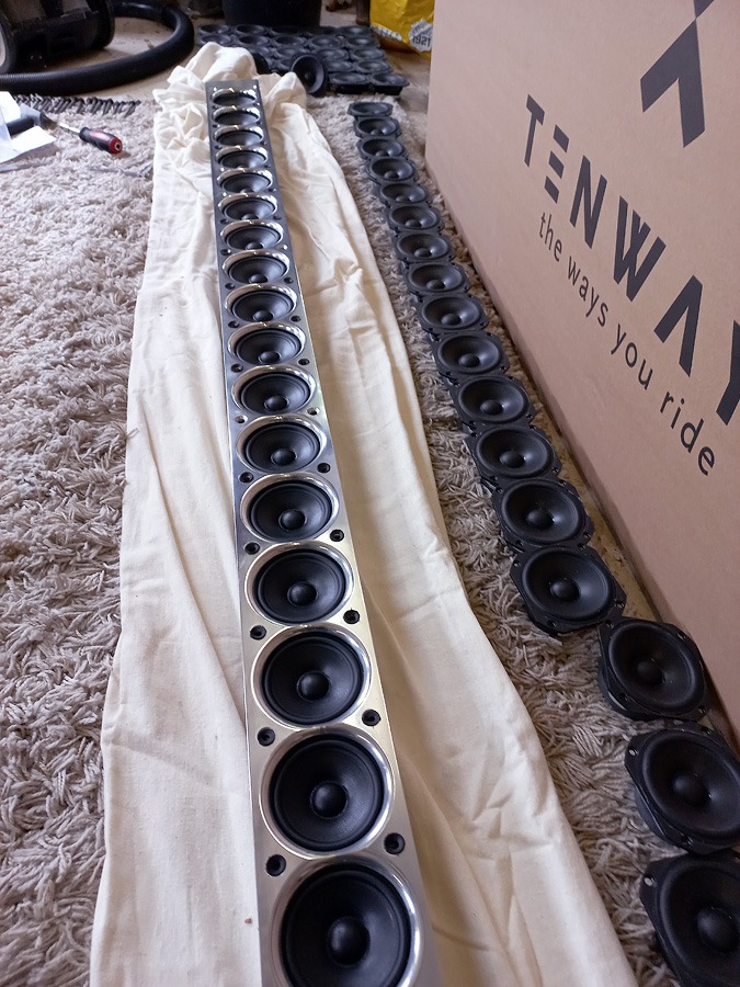

Boring afternoon, taking apart 100x m3 bolts/nuts and some clean-up work. It has to be done, though
At this rate I'll be re-assembling the second array next week. taking plenty of time to clean it all up and
prepare it for assembly again. Watching the F1 races in-between sessions

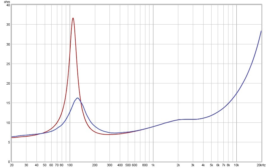

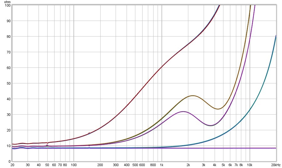

One more impedance control measurement:
Impedance as measured of all groups in left and right array. Close enough!
The wiggles at 50 and 150 Hz are from the laptop power feed.

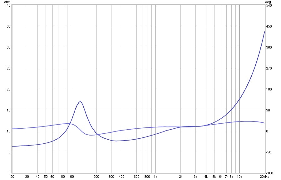

Left array is finished. Will drag it back inside tomorrow. Impedance looks nice and clean after bolting down the baffle and setting it upright.
Impedance peak landed at ~128 Hz (without any play hours on it). Array back on it's feet inside the garage.
