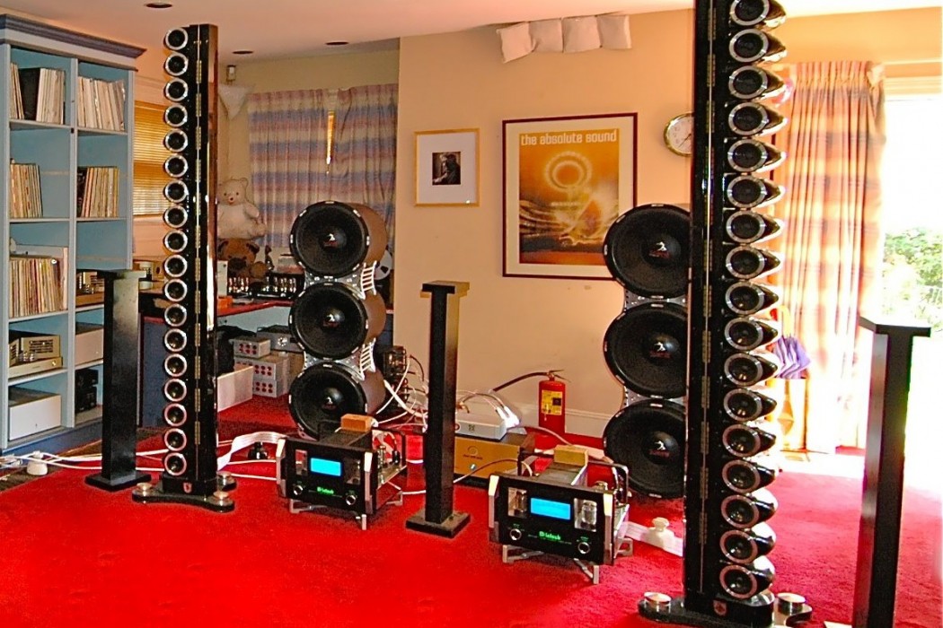

Do you have a picture of your Arrays? I think I've seen an interesting avatar from you on another forum :).
For now I'm extremely pleased with what I hear, played a couple of songs today and the magic is still there. Time to let it sink in and enjoy it for a while.
I haven't even brought my baffle fixture back in original state yet, which I know was a tiny bit better. No hurry with sound like this.

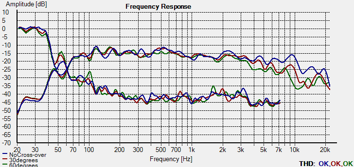

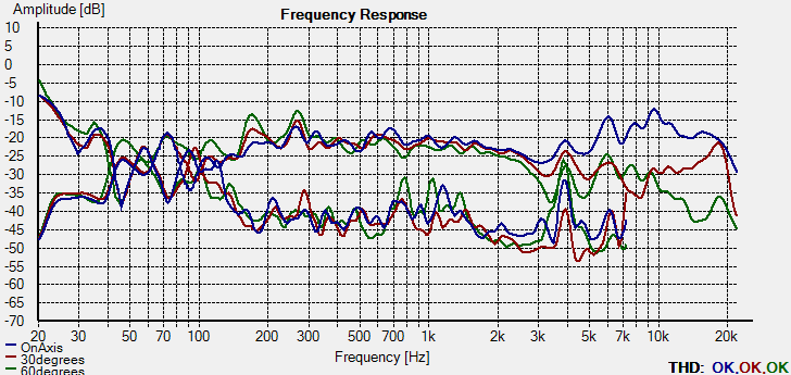

We are told from a physics standpoint that all drivers start to beam at some point, the measurements below prove otherwise. I did on and off axis measurements of my Arrays and Avebury. line source (on left) -vs- true point source (on right). My degree placement is not exact, but close enough to validate this point. I am using a Dayton "Omni" measurement mic, noting some of the same issues discussed in the recent posts. The mic was pointing directly at the center of the drivers for all these measurements. I included the distortion readings just to reaffirm the possibilities of what a large quantity of cheap drivers can do working together.
I mentioned above that maybe "beaming" causes a loss in overall sound stage. Based on these measurements, that would not be the case. As many of You are preferring slow gradual roll-offs in the highs, maybe the highs do mask the spatial details in the 1 - 3 kHz region. I do notice when I create a 3 kHz, 24 dB/octave Low-pass crossover convolution in JRiver and use that on Avebury, that system completely disappears. There are no highs what so ever, but I can not localize those speakers at all. Again, I am not sure if this is caused by the beaming or shear lack of highs. I am going to set up a two-way system when I have enough time off work: Avebury crossed at 3 kHz to Hi Vi Pro planar tweeter. I will let You all know of the results of this test...
I also tried crossing the arrays at 3 kHz to see if they would disappear. They didn't. I do not quite experience the disappearing act Wesayso experiences with his arrays. But my cabinets are flat rectangles with sharp corners, and I do not have the rounded baffle covers to round off that 1/4 inch cardboard bezel frame that sticks out of each NSB driver. :mad: I would like to build nicer cabinets for these, but as it turns out, three of the drivers are damaged and there is a nasty break up around 1.2 kHz that EQ can not fix. (Not all of my DSP adventures were good.) EQ can do a lot, but it can not fix inherent driver problems. When I crossed these drivers lower, at 700 kHz, I could hear a quiet rubbing in the voice coils that sounds around where the break-up is. Maybe all the drivers are damaged. I do not know if I am hearing things, I just know that when I perform the same test with Avebury, it is not there. I tried figuring out a way to measure this, but I really do not know how to. Giving all these setbacks, these arrays do sound pretty good at moderate volume levels. But unfortunately, I will not be putting any more time into these arrays, so I am figuring out what to do for the next Array build. This is not a bad thing, as this was always an experimental build to begin with, I got my moneys worth from the experience.

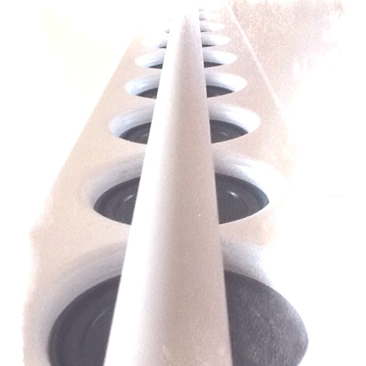

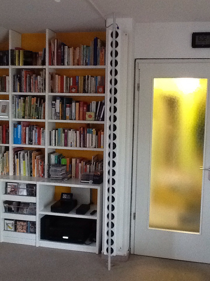

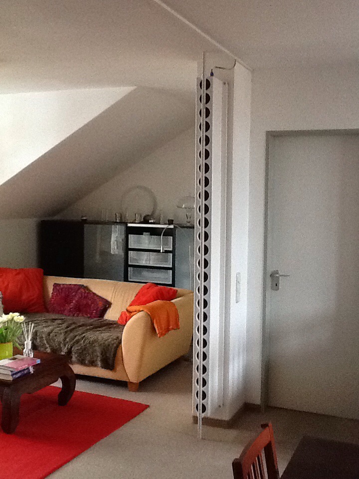

Here are photos of both arrays, which are mounted via sorbothane machine mounts in an opposing fashion.
The grey plastic tubing in front of the drivers serves to disperse the highs, which works very effectively but looks awkward.
Then there's the avatar you've mentioned, right?
Lastly there's the frequency responses of each channel and both channels combined, heavily smoothed, since they aren't as smooth as yours. But one gets the downward tilt, which most of us seem to favour.
Cheers

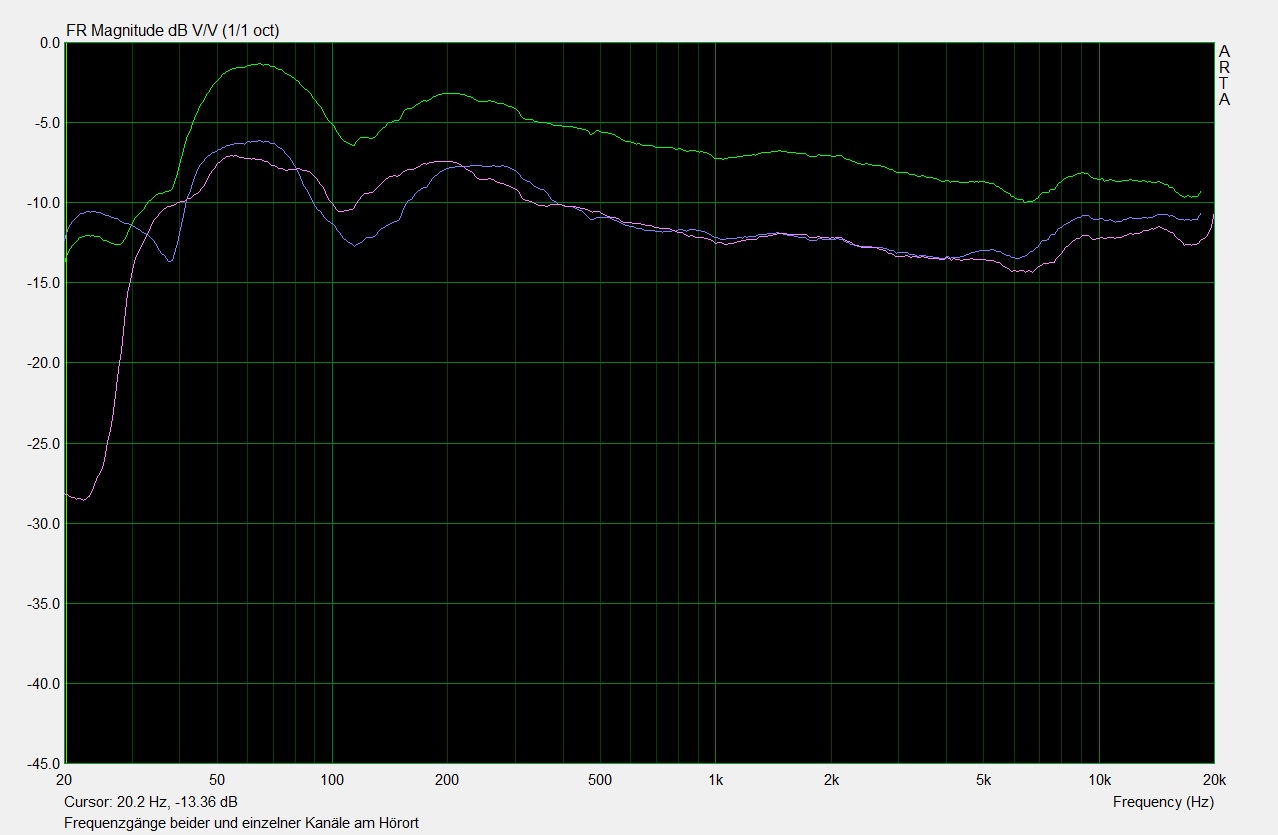

Yes marin, that's the avatar I saw... I immediately got the drift when I saw that tube. I had been thinking about something similar. I wanted to try a sphere in front of the drivers, one each. I figured it would make the path length more even over a wider area for each speaker and combat the comb filtering that way.
I haven't tried it yet. What's your story behind the tubing, what tests did you do and how does/did it work better than without that tube? Is it a solid tube? or is it a type of foam. I've thought about using foam for the sphere, it would slow down the waves going straight through while evening out with signal that goes the longer path around it. One of these days I'd like to get an idea a la Danley (see his work on the Synergy) to be able to get a true line output at higher frequencies while still only using full rangers in the Array.
Interesting for sure.
Marin,
Is there a "science" involved on how You figured out the diameter and distance (from the drivers) for the gray tubing? (Any links to reading material would be greatly appreciated.)
Did the gray tubing affect the clarity in anyway?
Based on your measurements, this seems like an effective way to create a uniform dispersion pattern.
Thanks for sharing the idea.
Allen

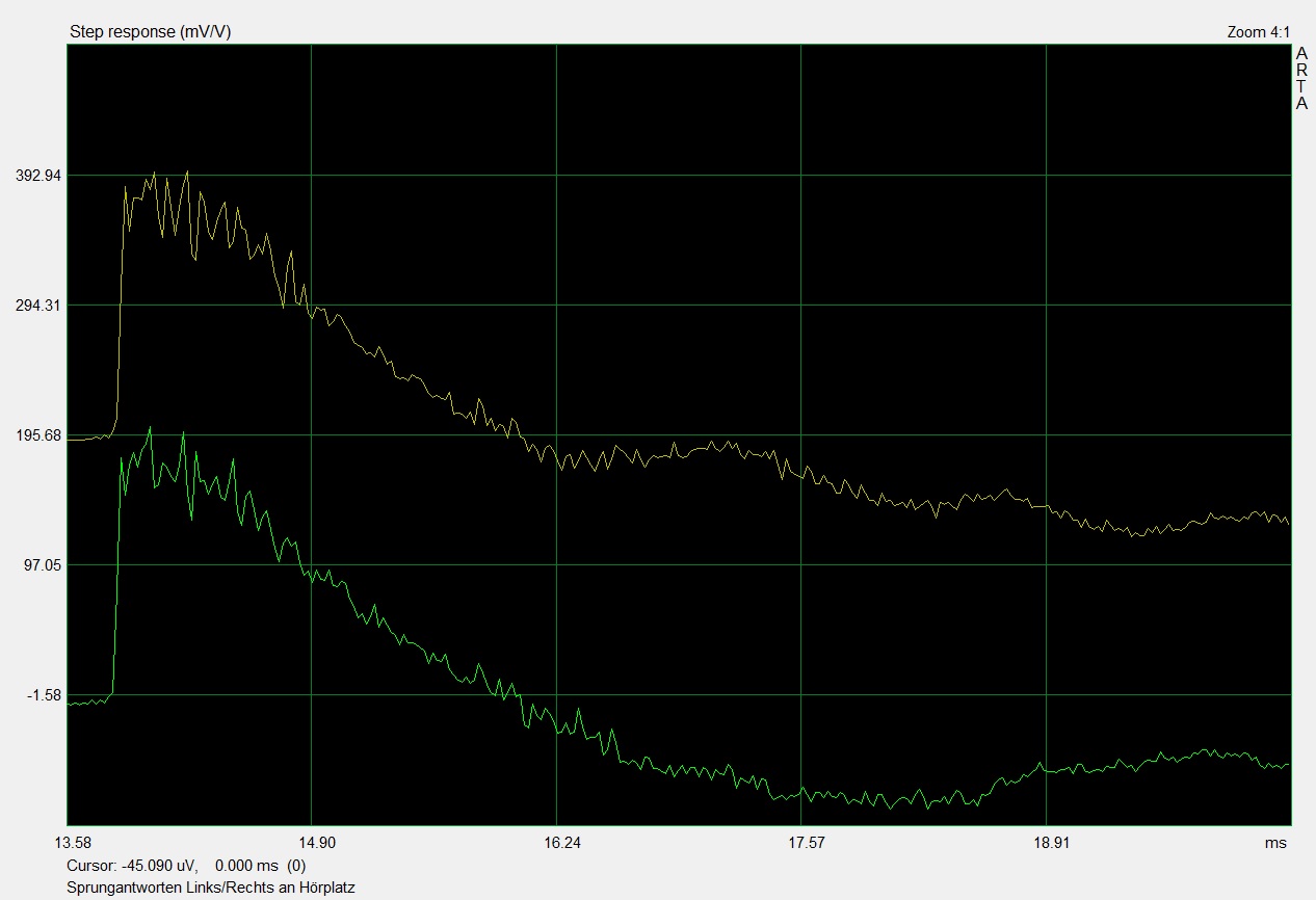

To add to Allen and my question, I'd love to see an impulse and step response from this idea. The smoothing is quite heavy as you mentioned. I get straight lines if I do that :D.
Here's 1/1 octave smoothing in REW from me (prior to the mentioned PEQ change)

There's not that much science behind the tubing, I'll have to disappoint you...
It's just standard 25 mm PVC installation tubing, other diameters seemed out of proportion. No fancy filling like foam or sand, but they're suspended from the arrays and I can't make out any detrimental resonances from them.
Background:
I had opted to subordinate my HiFi to family needs - after all, it's our all-in-one room and my girls kindly put up with the T4A's taking up a lot of walking space for many years.
So I mounted the arrays where they seemed to be at an acoustically favorable position, minus any fancy swiveling mechanism.
Due to increasing horizontal beaming toward high frequencies, I needed some counter measure for my preferred equilateral listening position, and voilà, came up with the cheap to try tubing option.
After some measuring and slight adjustments in the lower highs, they just stayed where they were, since they did fit the bill.
Due to their sub-optimal visual appearance I recently removed the tubing, but still am less enthusiastic about the sonic result, which can't be fixed by eq.
None of the sonic attributes I crave suffer from the tube-approach, so I need to figure out a visually more appealing solution eventually...
The soundstage is usually wider than the arrays' positions suggest and it's depth reaches from about halfway between them and my ears to well behind the room's boundaries, some 3 meters away from them, to as far away as the recording seems to demand.
When walking around the room, the positioning and radiation pattern of the arrays mitigate the sound stage collapsing problem usually encountered with standard loudspeaker placement.

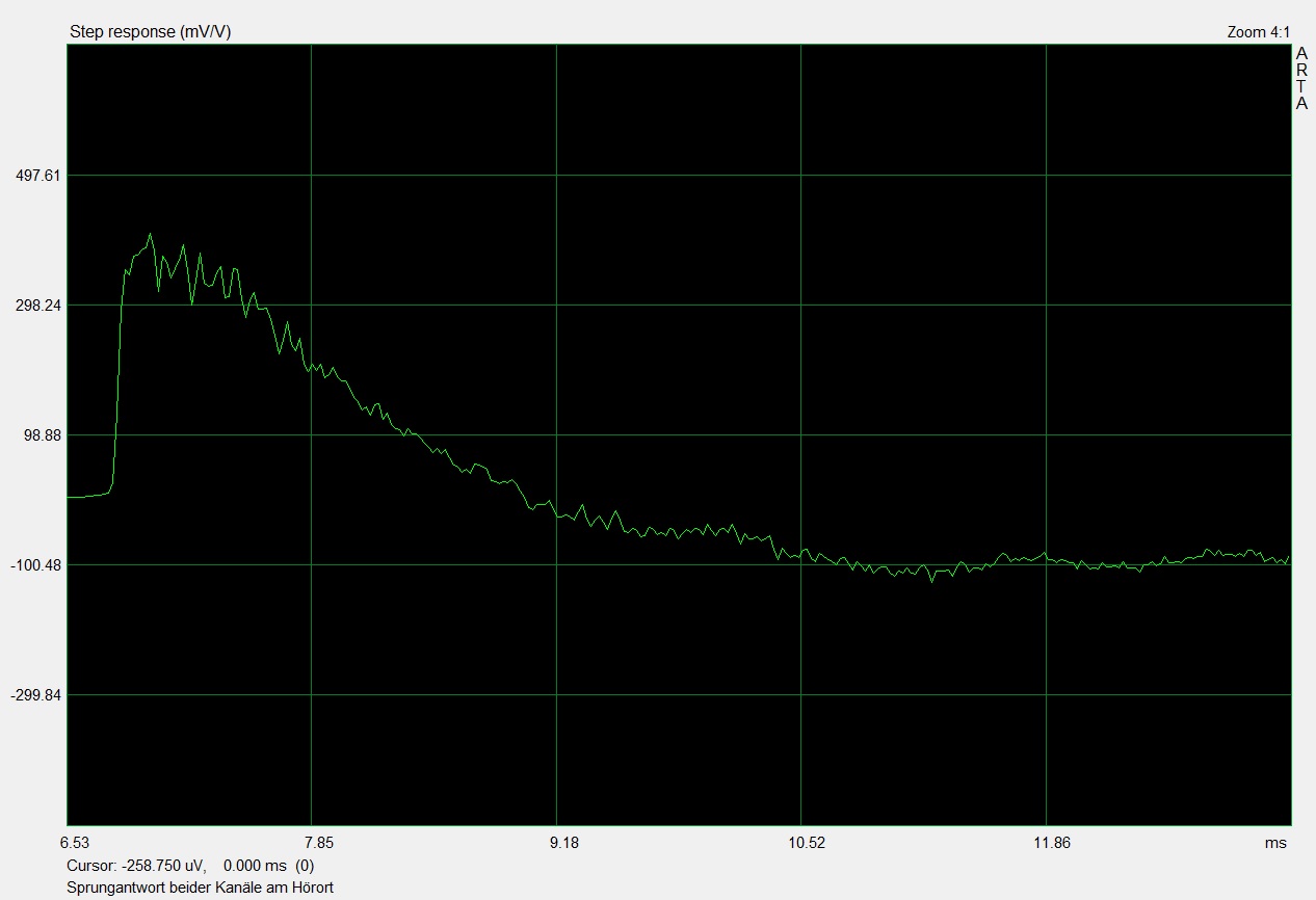

See pictures of both arrays' combined as well as their individual step responses from the equilateral listening position.

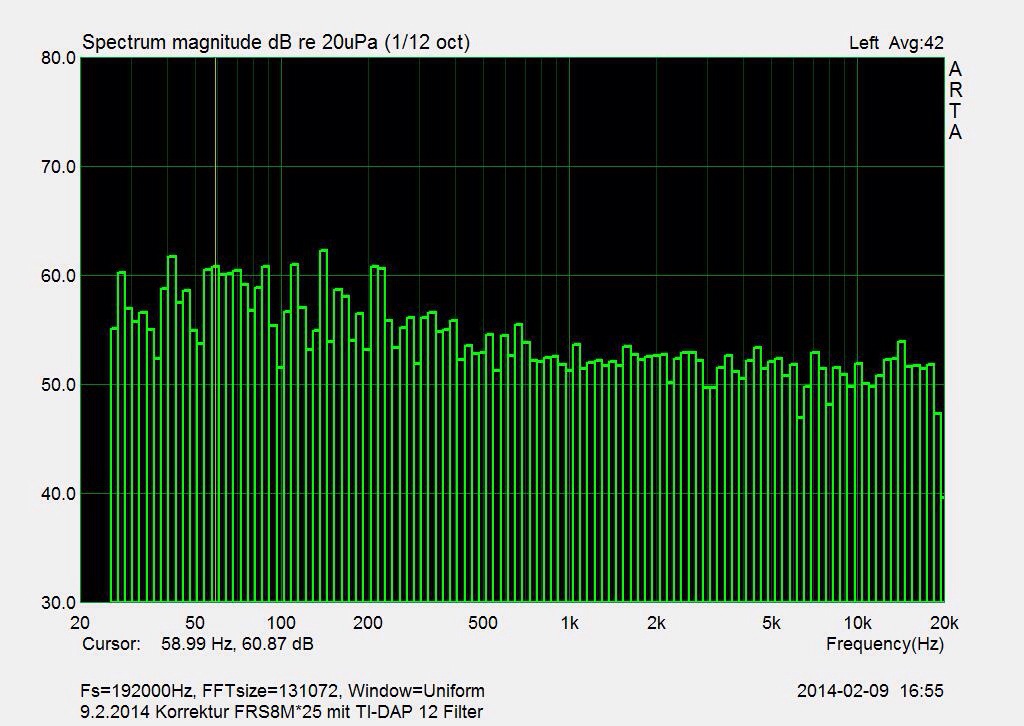

Just realised, that all the measurements were taken, before I replaced my Texas Instruments Digital Signal Processor Evaluation Board, with which I originally eq'ed the arrays, with the Behringer.
:eek:
Haven't done any ARTA measurements since the Behringer came in and after using it's integral noise generator, mic input and analyser to eq the arrays.
Intended to do so eventually, but am so happy with the sound, that I rather spend my time listening...
:cool:

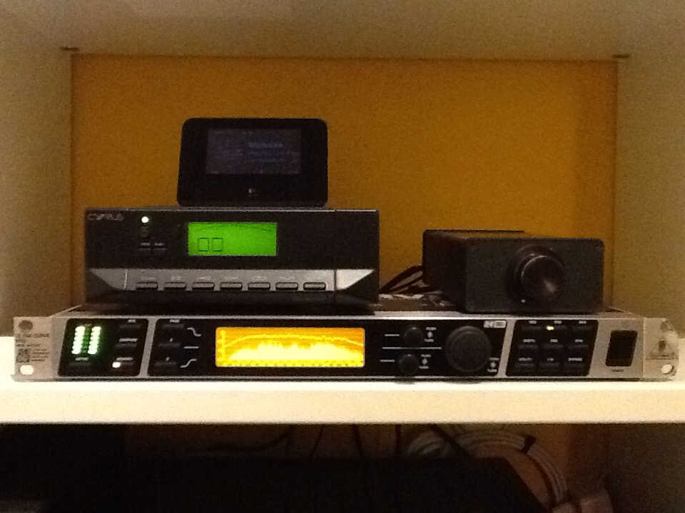

Just a pic of a 1/12th octave smoothed measurement and one of the Behringer in the system...
Could a thinner tube be placed closer to the front of the array?
Trying to think space and perspective here. If a bigger tube is placed away, perhaps a thinner tube, held in place closer to the arrays drivers would work the same way?
I determined the optimum distance of the 25 mm tube to be about 1 cm from the baffle by measuring treble extension at the listening position. Too far away or too close and the dispersion effect there is gradually lost.
The next smaller tube diameter of 10 or 12 mm seems to suffer from the extrusion process and storage conditions to render the tubing out of shape. It would look even more awkward against the straight shape of the arrays, so I didn't even try. Other materials were too costly to just try...
I should actually use a single chassis in an appropriately shaped box to experiment with different tubing material and diameters, while being able to measure in a 180° arc in the nearfield without the disturbance of near-by surfaces and different arrival times from the differently spaced chassis relative to the microphone.
