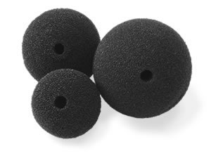

I'm not sure about any possible merits in using those foam balls.
They will most likely start to reflect effectively at frequencies way too high for what we need, since they're made to transmit wide band sound while blocking a draft.
Even a hard and rigid tube will practically be invisible for wavelengths larger than half the circumference of the tube (f < ~8,75 kHz @ 25 mm tube diameter). Tell me, if I messed up my calculations here...
I'd also be aware of reflections other than in the horizontal plane, since those might add additional destructive interference patterns, counteracting the line source effect in the already compromised high frequencies.
Tell me about your thoughts...

What I wanted from a reticulated foam ball in front of a driver is trying to slow down waves passing straight through. If we assume high frequency is being produced by the center cap. We would then create a wider wave front of high frequency forming a flatter total wave front. Sort of like letting a ribbon play that frequency.

Also, I'm not sure the foam effectively slows the wave propagation through it, since it's mainly made up of air bubbles with very thin membranes in between. And the speed of sound is the same in those bubbles ...
Working on driver shading here, but am using microfiber with 30ppi reticulated foam for the absorption of said hf instead of just diffusing it.
This foam is the same as is used in the hvac biz for filters. 20-30ppi works best at these wavelengths.
Let us know how that goes... I wouldn't want to shade drivers with passive components, but padding down the high frequency output of the outer most drivers (gradually increasing padding to the outer drivers) with reticulated foam is an interesting way. It has been on my mind ever since I saw the reduction in high frequency from Dr. Geddes waveguide fill with reticulated foam to reduce the effect of hom's in the waveguide.
But as said, I'm afraid it would take quite a thick layer to have the right effect for huge line arrays? I have no idea how to make that look pretty.

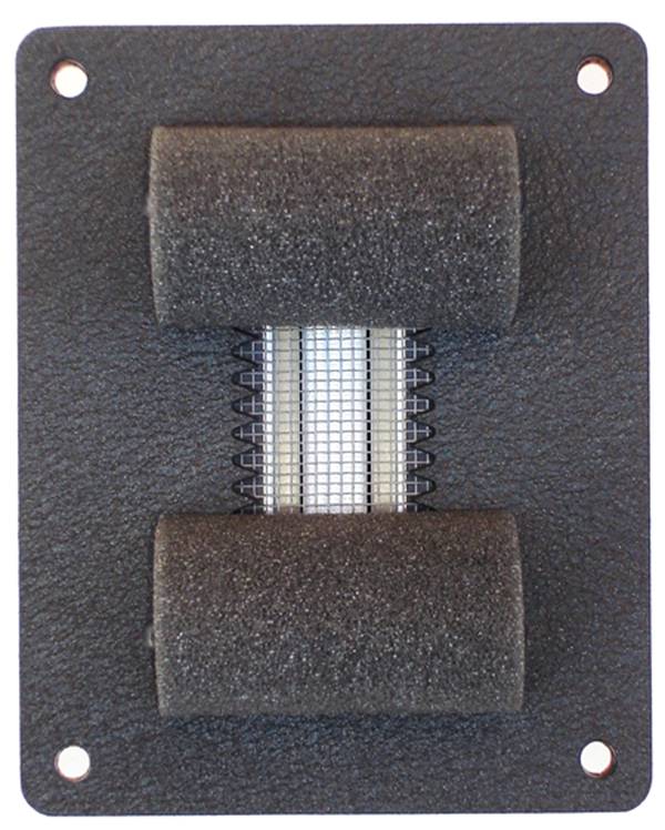

I can imagine that ribbon tweeter being better than a line of full rangers that are obviously playing beyond their true potential up high. I'd love to hear the Scaena in real life, they bring the tweeter line in at ~5500 Hz... If only funds would allow to play with it, just to hear the differences...
The Scaena is still an array of tweeters. I think the comb filtering is minimized with an array of ribbons (or are they planers) like that. I am not sure about the driver spacing of the two arrays is the best for a 5500 Hz crossover frequency. 13740 (speed of sound in inches) divided by 5500 (Hz) is about 2 1/2 inches or about 64 mm. Wouldn't there be comb filtering between the tweeter and main arrays? Sure You can "toe" each array in on your listening area, but again, maybe giving up the large listening area.
It seems there are many things we like about our full-range arrays, if we could only have that "ribbon" type of sound on the highs. There are a couple of other threads of people building "full-range" ribbon drivers, covering 200 -300 Hz. But as Marin says... (next post)...

The only thing I dearly miss is the true ribbon tweeter ...
So maybe the full-range ribbon is not all it is cracked up to be... But maybe building a 72" tall ribbon tweeter to cross in at 3000 hz? Can we get the driver spacing between the arrays down to 4.58 inches or 115 mm center to center? The magnets and steel bars needed for the structure of ribbon drivers makes that a challenge, but maybe designing it for 3000 Hz and above is possible... Then can we get it to integrate? Quite a journey none the less... Any takers?
