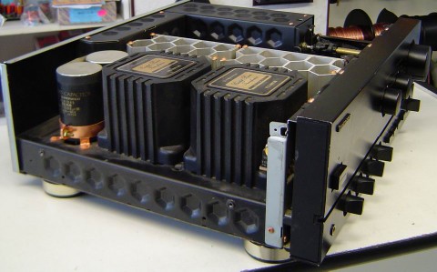

The arrays could handle about 240 watt before they run out of steam. My amplifier, a big old heavy beast, only puts out ~ 100 watt/channel. So that will be the first thing running out of headroom. It's a Pioneer A 757 Mark II
(not mine but to give a reference, a 20 Kg beast, last of it's kind)

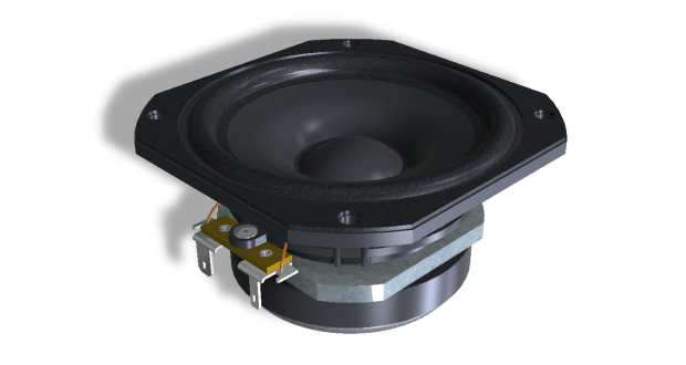

(3D model of the Vifa I made to help out in the design stage)

Hi wesayso.
I hope you don´t mind me saying this:
I admire your attention to details and I do believe all the work you have done results in a better speaker. BUT for all those that are following this thread I have to say that you can build a line array with the Vifa TC9 a lot simpler. Roger Russel from MacInthosh were actually the first to use the TC9 in such an array, but with far simpler enclosure and an analog equalyzer.
I have build an array myself, and I would say, when reading the comments to Wesayso´s arrays, you can get 95% of the way with a lot less effort.
I only say this to not disencourage people to build these arrays, as you will get a REALLY High End loudspeaker knocking the socks of nearly everything else, without going all-in like Wesayso. I am sure Wesayso´s are performing better than mine, but marginally so.
Another thing that puzzles me a little:
Do you think you are using the best equipment to drive these speakers?
IHMO these arrays really can tell the difference between a good amplifier and a great one. You don´t need much power to drive them, but the quality of the amp is clearly evident. I have thrown all kind of amps @ these arrays: OTL tube, hybrid tube/MOSFET, Class A SS and MOSFET, class AB SS and MOSFET. And the same holds true with source equipment...
I hope you are taking this up in a positive way, as I am full of admiration of your dedication and knowledge.![drink :drink: :drink:](https://files.diyaudio.com/forums/images/smilies/drink.gif)
