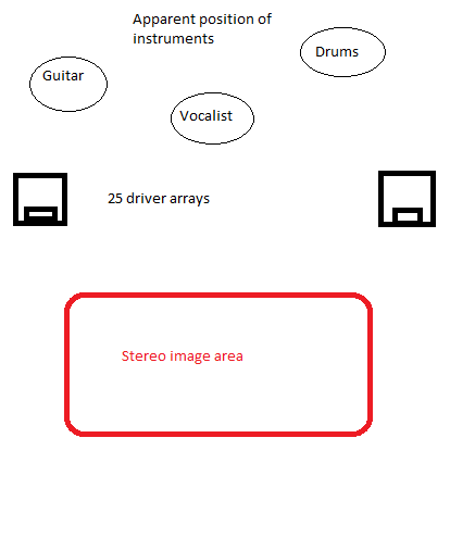

Simple visuals on how it sounds
The colored graphs do not mean much to my untrained eye. I feel that a simple diagram would help newcomers visualize how your speakers or any speakers sound.
In the image shown, how would you mark the area where you can hear real stereo? Where do the instruments appear to be located? What is the frequency response at each point?
Not sure of REW can generate such a diagram.
(I apologize for the basic diagram)
BasicHIFI1,
don't take this the wrong way, but I think you are trying to tackle very difficult concepts that are not easily translated into basic diagrams. There's a lot of math and science involved in the reproduction of sound. Plus, each song is recorded in a different way, so trying to apply general rules will be impossible.
It's also a question of feelings. Some people like the sounds of single fullrangers, some like line arrays. Some will swear by having monster horns or 4-way speakers with huge drivers.
Each have advantages and downsides.
We can talk about this forever and not see / hear the same things.
My advice:
Build something. Listen.
Get creative, explore.
We can split hairs forever, but in the end, it's about the music, it's about feeling.
That will never come out from an audio forum discussion. It will come out by listening to different setups, and finding what YOU like and enjoy.

Perceval is right,
It would be impossible to draw up a diagram of placement in songs as each song images different anyway. Re-read what has been said about the imaging already. In quite a few songs I get wider placement than the actual arrays and even up to one meter in front of them. This isn't just array behavior. It's the lack of early reflections (all of them). Arrays solve 2 mayor reflection points for you if they are tall enough. The floor and ceiling ones. That colored graph I showed gives you a hint at what my remaining reflections look like, get it like that and imaging excels. It is the result of a lot of thinking and planning the room to be able to maximize that. I didn't want to turn the living room into a studio environment. I cannot give you any guarantees.

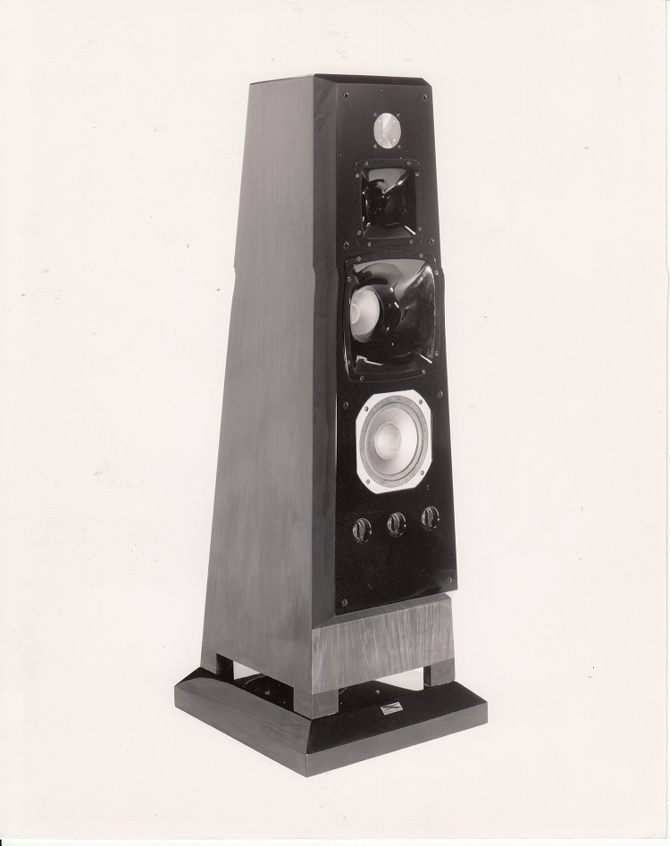

I will say when I built multi-way horn systems the best high end was from a TAD ET703 driver. Only problem is that today a single pair which is good from about 10Khz on up to way higher than we can here is about $5,000 per pair, a lot more than the $450 a pair I could buy them for years ago before TAD got stupid with their pricing. It was the first time I could seriously identify some extremely high frequency sounds, nothing like the Tizz of a normal dome tweeter or the fatiguing high end of most compression drivers pushed that high. Let's see 25 of those in a line array per side would cost what! I'm not Bill Gates so not going to happen. I wish I had never sold those enclosures, they were the best thing I have ever built or heard. Just the top two driver pairs would be $10,000 dollars today. They were a a five way system with both the TAD 2001 and TAD ET703 driver and another cone driven mid horn and two bass drivers in two separated internal enclosures. FR was 20 -24Khz. They were really nice looking also with piano black faces and Mahogany wood finish. Trapezoidal, a real engineering problem to build those enclosures. The second bass driver is down firing, ports on the back, tuned to two different frequencies.
I would love to see what you come up with. I am open to learning from anyone, no ego trip on my side. One comment I will say is that to expect any single device to cover the entire audio bandwidth is just asking a bit more than i think can be done. Something has to give, you can get the bottom and then not the very top or vice versa. There just aren't any devices that I am aware of that can do it all in one unit.
I'm sure Wesayso has an excellent system that meets his needs but to ask any 3" driver to hit 20Khz and have any real dispersion is asking to much. All cones have some breakup mode, nobody has a perfect solution for that.

But even in a line array at very high frequencies you would have to look at the individual devices radiation pattern. at 10Khz the center to center distance is to large for the devices to combine, so even at low output you have to look at an individual device. I'm not talking about spl, I'm only talking about producing a clean 10-20Khz output with a matching dispersion to the rest of the bandwidth.
Kindhornman,
This is a common compliant of those that have not heard the arrays. I made some height/distance measurements of my arrays and comb filtering is only a problem above 10-15 kHz. As you move away from the array, the phase shifts from one unit to the next are so small that the vector sum is a random addition at low frequencies and you only see the peak/null pattern at very high frequencies. Other designs (cone/dome, etc) could improve on this performance. But line arrays have many other benefits (removal of floor/ceiling reflections, power handling, low distortion) that are a fantastic trade-off in my opinion. Besides, how much music is there above 10 kHz? It's mostly just air/breath.
