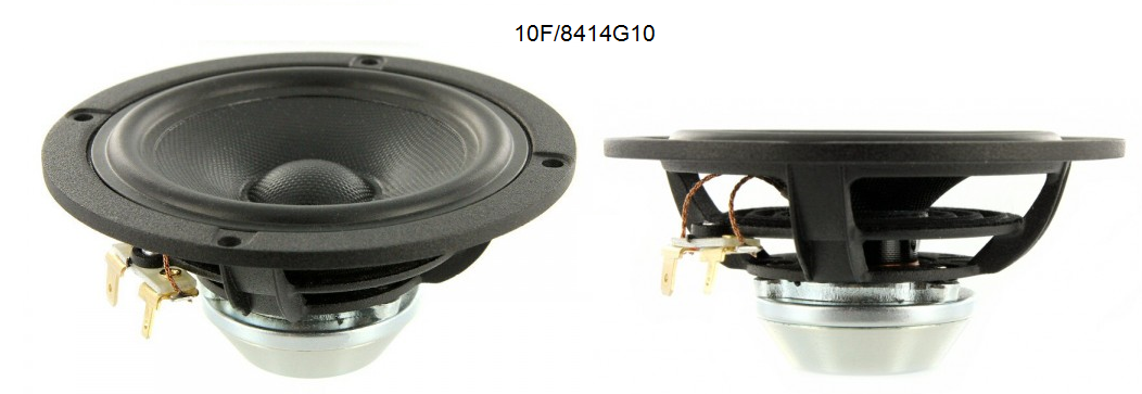

I just reviewed my above posts. It is very interesting how similar the two drivers are. The 10F is 10 times more expensive and because of that, it is refined to the N th degree. It is going to be interesting to see what one gains in sound with that kind of refinement.

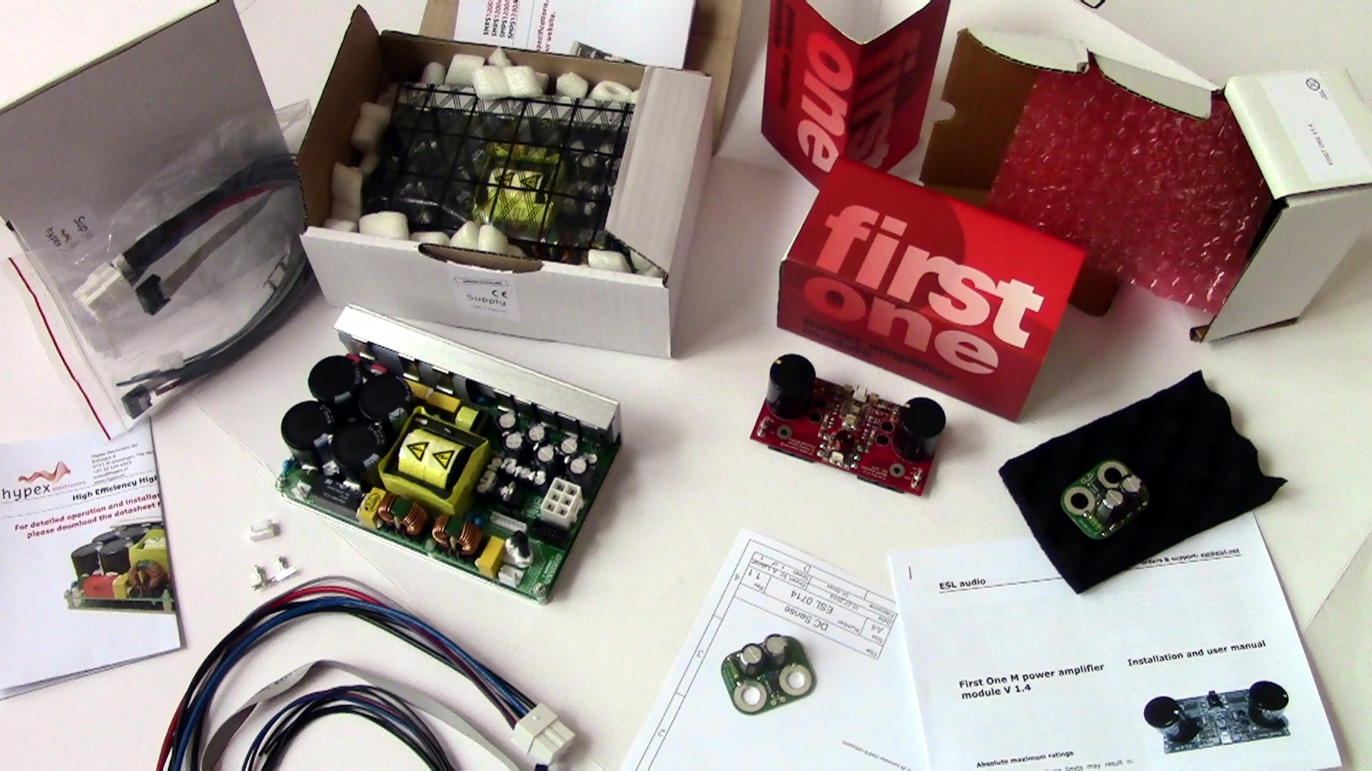

Anyway, first thing is first, got to get the First One built first. I am posting this photo here, as I know Wesayso has expressed interest in this kit.

Has anyone tested to see how the TC8 TC7 and TC6 compare? Is the TC9 top in the family or are the others of a similar quality barring minor differences?
Actually, there are 2 TC9's, The other one is the relative of the ones you mention. They are a new breed of drivers from Tymphany. Stamped steel baskets etc. No doubt the will share some things but the TC9 FD18-08 we are talking about is not like those others in build and heritage. It's more closely related to the Scan Speak 10F than to that new line up sharing the similar names if you ask me.

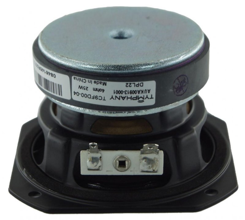

For those interested, the other TC9, the TC9 FD00-04:
Transducer Detail | Tymphany
Not at all like 'my preferred' TC9 FD18-08 driver looking at FR alone...
I do hope the old TC9 is here to stay. All other new drivers in the TC series seem to share the new stamped steel baskets etc. The old TG9 FD10-08 seems gone completely. The 4 ohm version is still listed.

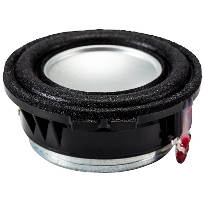

In my search for drivers, I bought a few models of the Tympany PMT series. They seemed interesting drivers, but I concluded that the Fs, even though below 300 Hz, was still too high. But imagine about 75 or so of these arrayed floor-to-ceiling. Good FR, almost no beaming. I think they would reach 80 Hz, which is where I am crossing the current arrays. HF performance would be closer to ideal. They are more expensive though... as in 75 of these versus 25 TC9s.

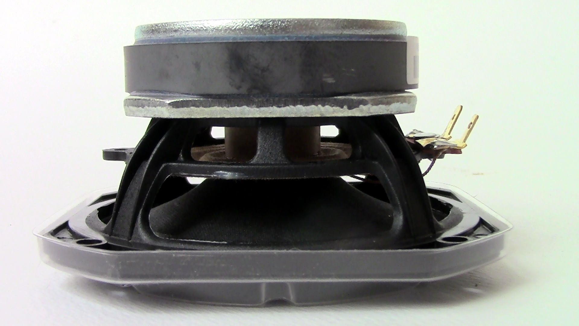

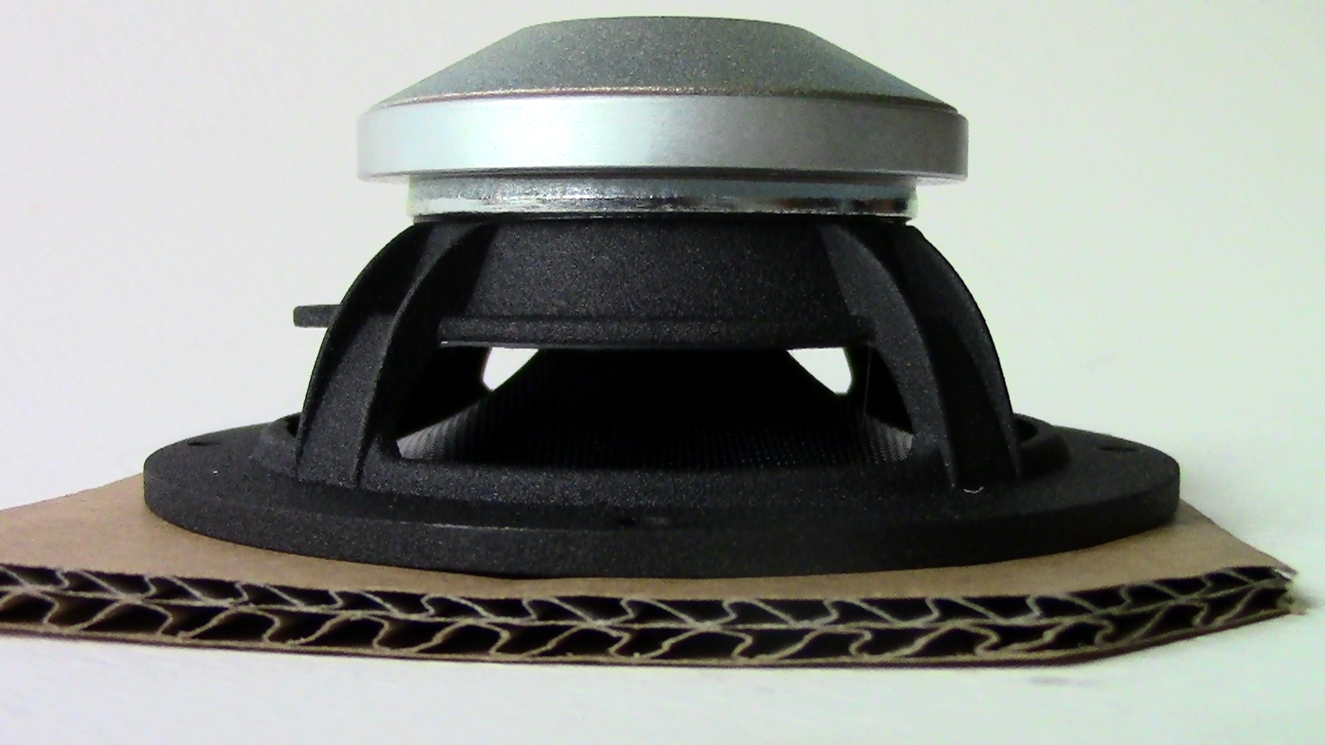

So what do you guys make of the closed up area below the spider on the 10F?
You can see the TC9 being open there:
Always wondered why they did that...
They must have their reasons because version 10F/8414G00 is ventilated as TC9.
Just for sake of comparison, the 10F has X-mech of about 7.5mm whereas the TC9 has X-mech of about 4.5mm.
And of course the TC9 is very high Q compared to the 10F, so it is naturally somewhat inefficient in frequencies lower than the Fs.
True, it would take only 70 watt to let the 10F do the same as 240 watt on the TC9.
Both versions of the 10F are marketed as "Fullrange". At least that's what their spec-sheet says.
I don't think with these small speakers with very small xmax you will see any real difference in performance with the spider open or closed. That is really a large air volume compared to the small motion of the spider.
I'm sure they had a very good reason to do this, why make several basket castings if you could have done all the versions, e.g. 4 ohm, 8 ohm etc.. with one.
The venting will be for the air mass behind the dust cap and not for the air behind the spider. From what I can see these are vented magnets with the hole in the back plate. You do not normally ever vent the air behind the spider through the magnetic motor, out the frame some way but not through the motor assembly.

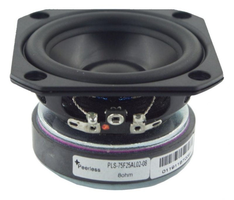

Does anyone have anything to say about these PMTs? I'd like to see someone else give it a try. The array would be very easy to build. No back chamber needed. Simply cut 3/4 inch holes in a baffle and poke these through the holes.

Those look like the speakers used in the small Apple JBL sticks that you would see in an Apple store with something like 4 stacked. I'd think even with all of those stacked you would have a lot less surface area than the 3 1/2" speakers that Wesayso is using. Will you get any bass with those even with a stack of 75 per side? What is the fs of those speakers?

Sd = 4,9 on these, x 75 = 367,5 with 1mm of x-max.
TC9 = 36.3 x 25 = 907,5 with 2.55 mm x-max.
It's save to say they won't do bass. But the proposition of ra7 was to use them with separate bass reinforcement. The FR does look sweet though, but I'd want to see more graphs to say anything useful about it.
Fs is ~ 275 Hz.

ra7, what where your listening impressions of this driver?
I really like the off-axis Frequency Response.
The cost for 75 with the parts-express discount is $568/array, so double the TC9. That I do not think is unreasonable, if they indeed perform "better" for high frequencies. I wish I could find a CSD for these...
My concern is getting down to 80 Hz, as 75 of these only has an overall SD of 367.5 cubic cm, compared to the 907.5 cubic cm of 25 TC9s. And this driver has a "fixed" enclosure volume.
I am interested in how these would perform with high frequencies in an array. My gut is telling me, these would lend themselves better to a two-way design crossed between 200 and 300 Hz. If I was to do this myself, I would consider a line of small bass drivers. Thankfully, at 200 - 300 Hz, one could easily get the two lines close enough...
