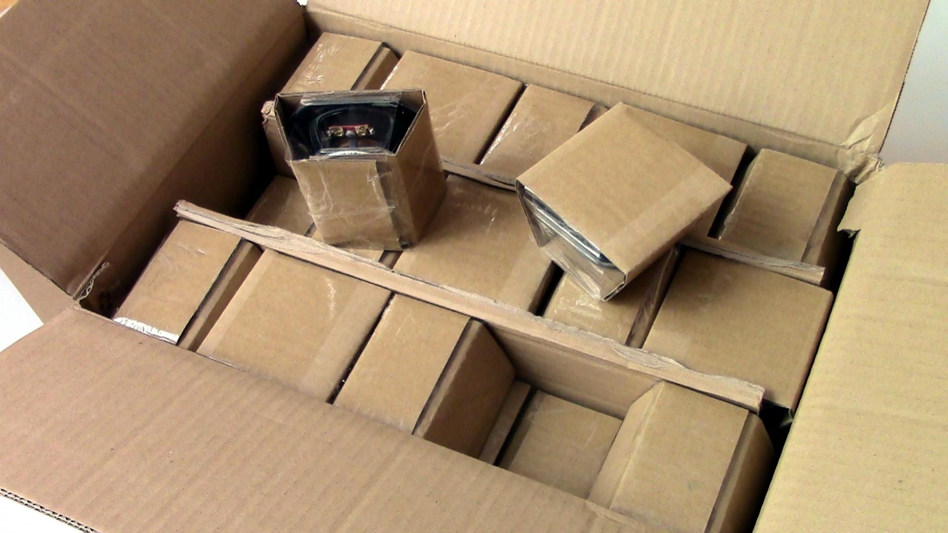

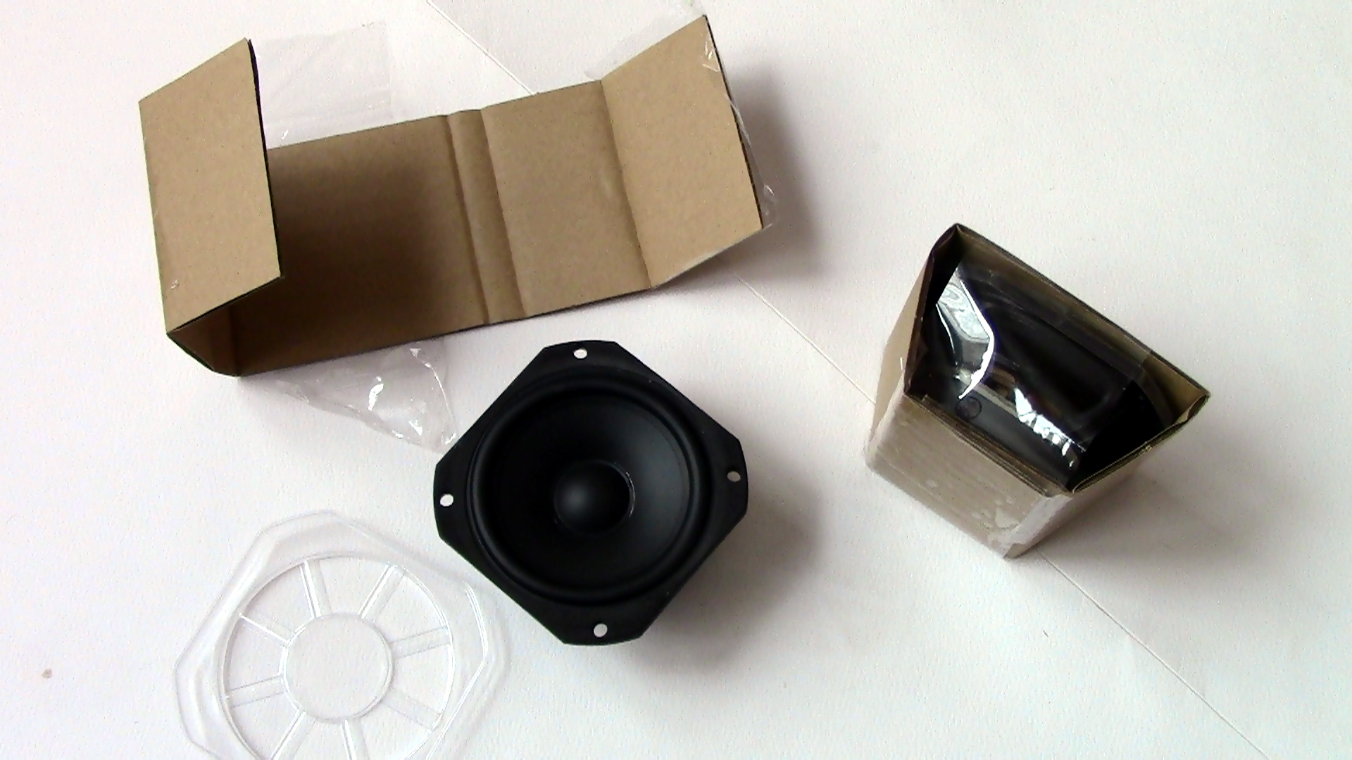

Wow, that was fast...
Had quite the deliveries today :)
Actually, I was surprised all 64 of them TC9s fit in those two boxes (one was only half full).
The box on top are the two SMPS I ordered from Hypex for my First One build.
Efficient packaging of the TC9s...

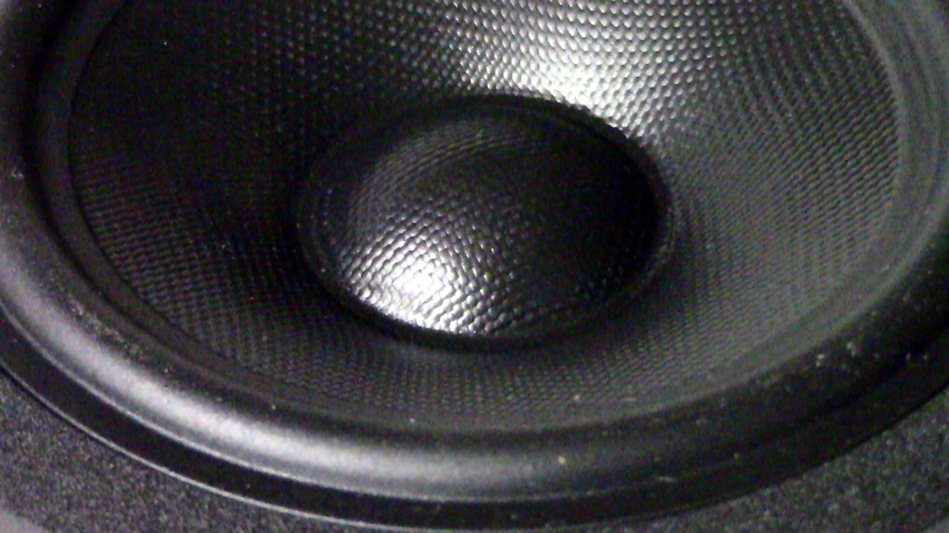

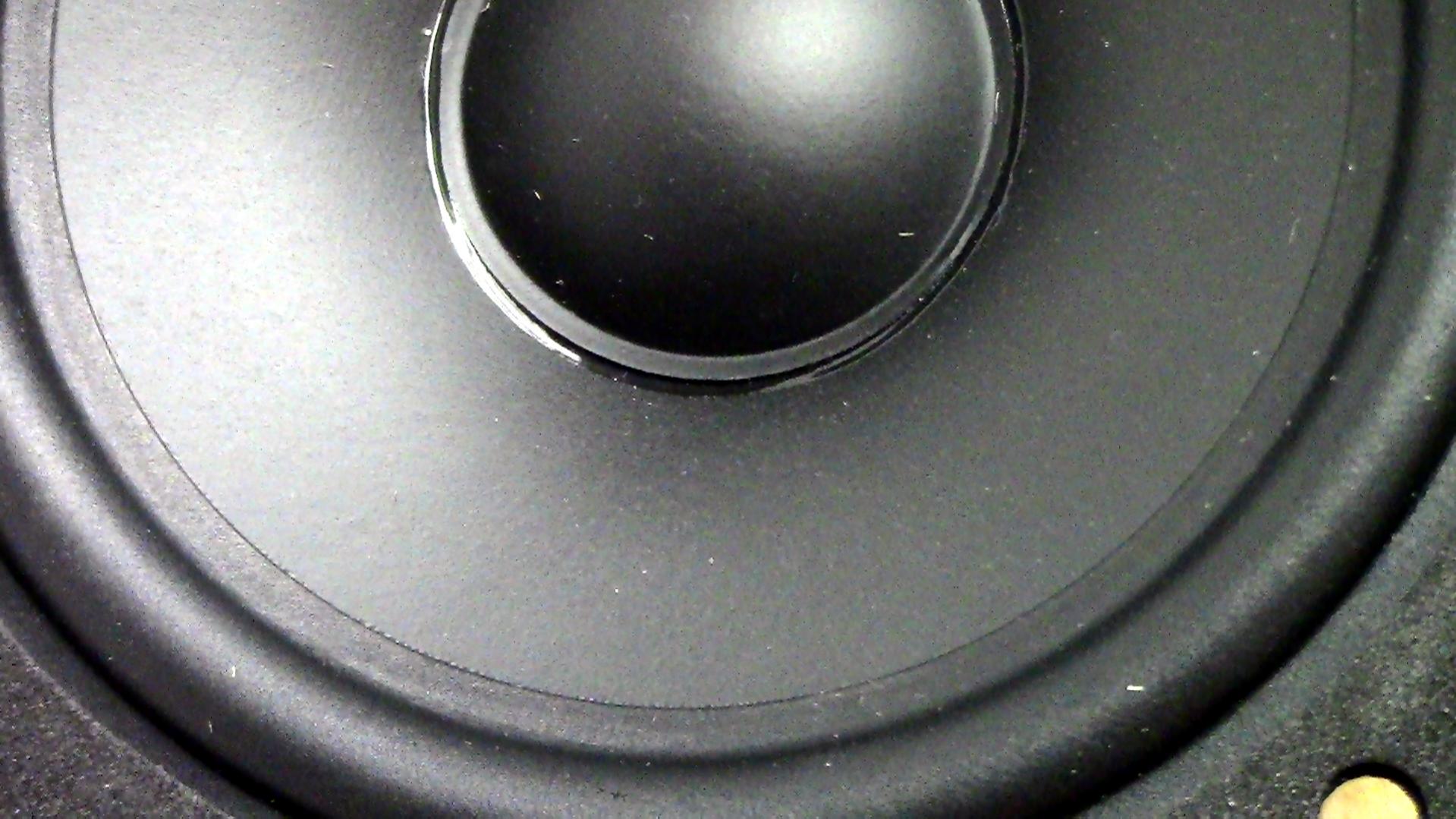

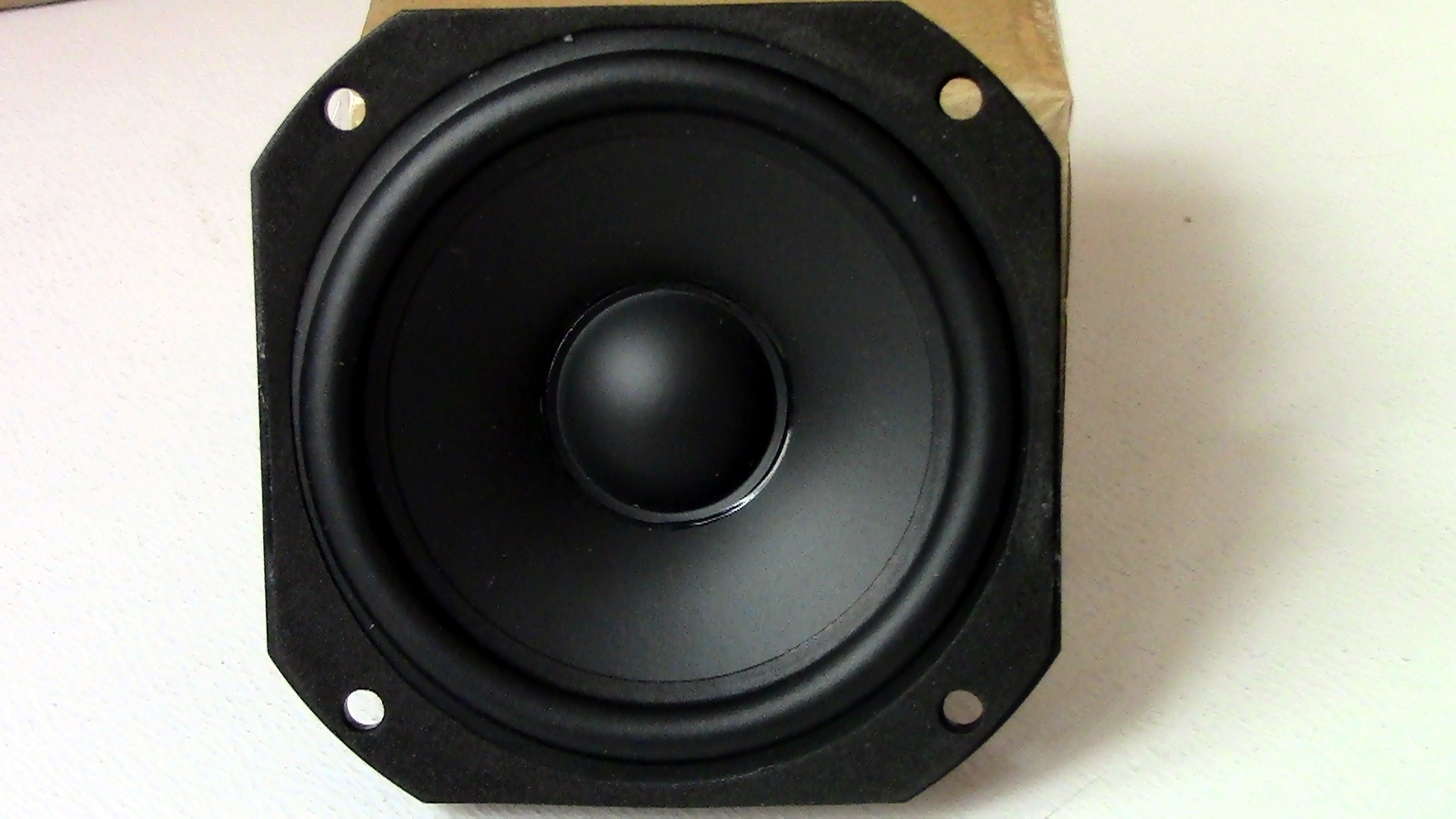

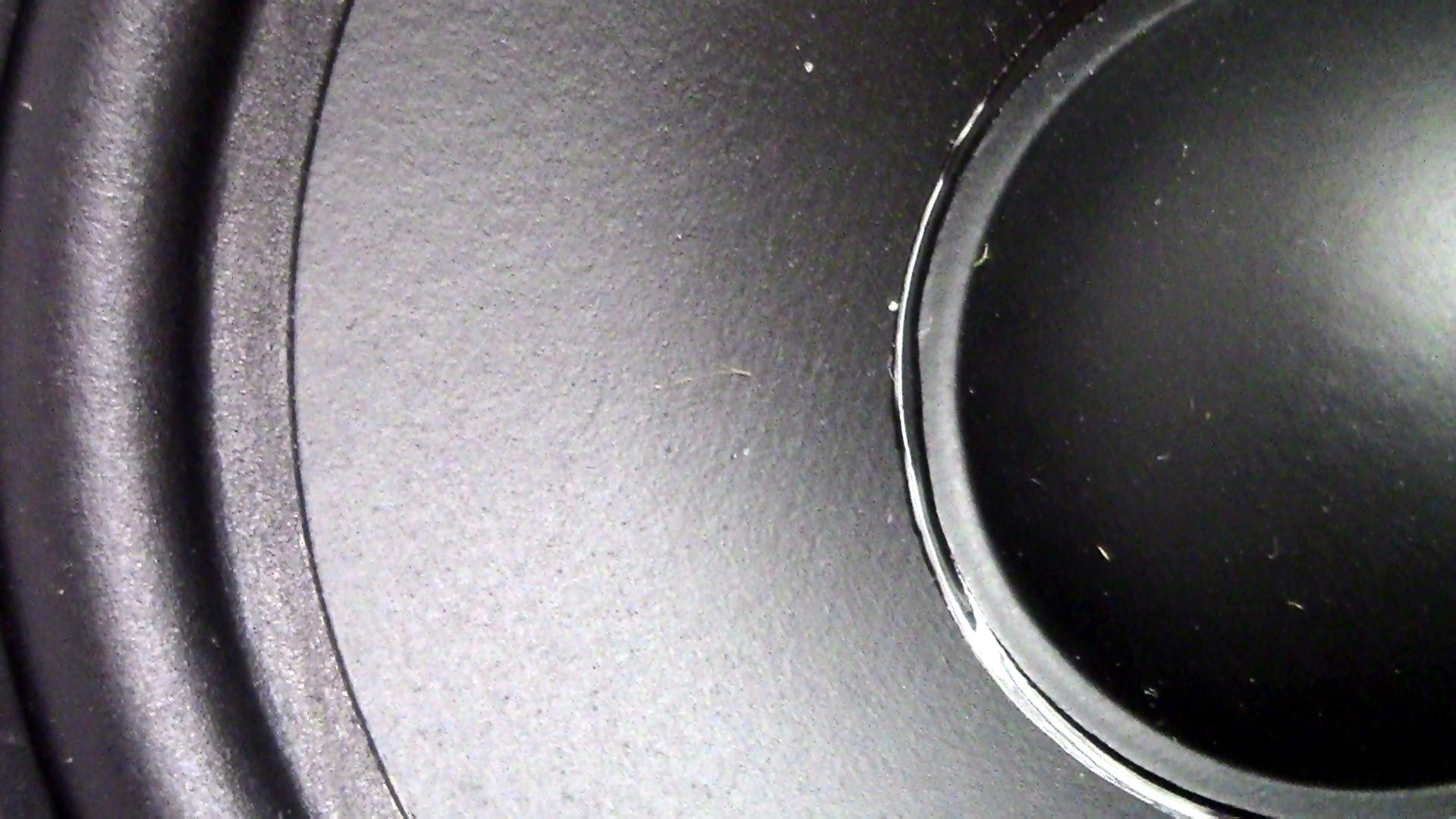

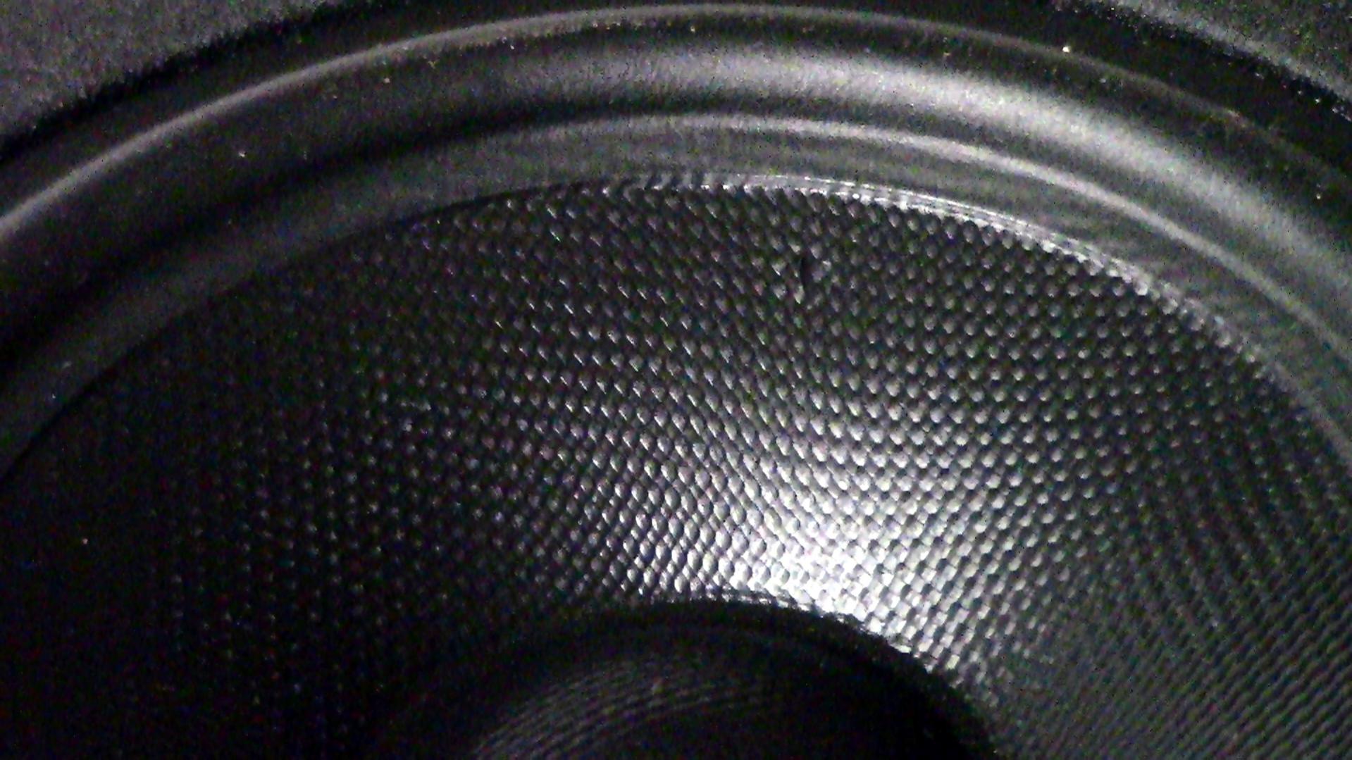

TC9 compared to the 10F
Most of You have seen the TC9
But for laughs and giggles, lets look at it side by side, to the ScanSpeak 10F:
Here are the cones: First three photos are the TC9, last two are the 10F
Both are finished quite well. The TC9 almost looks like a poly cone, I have never seen a paper cone treated this way. The 10F is a fibre glass cone.

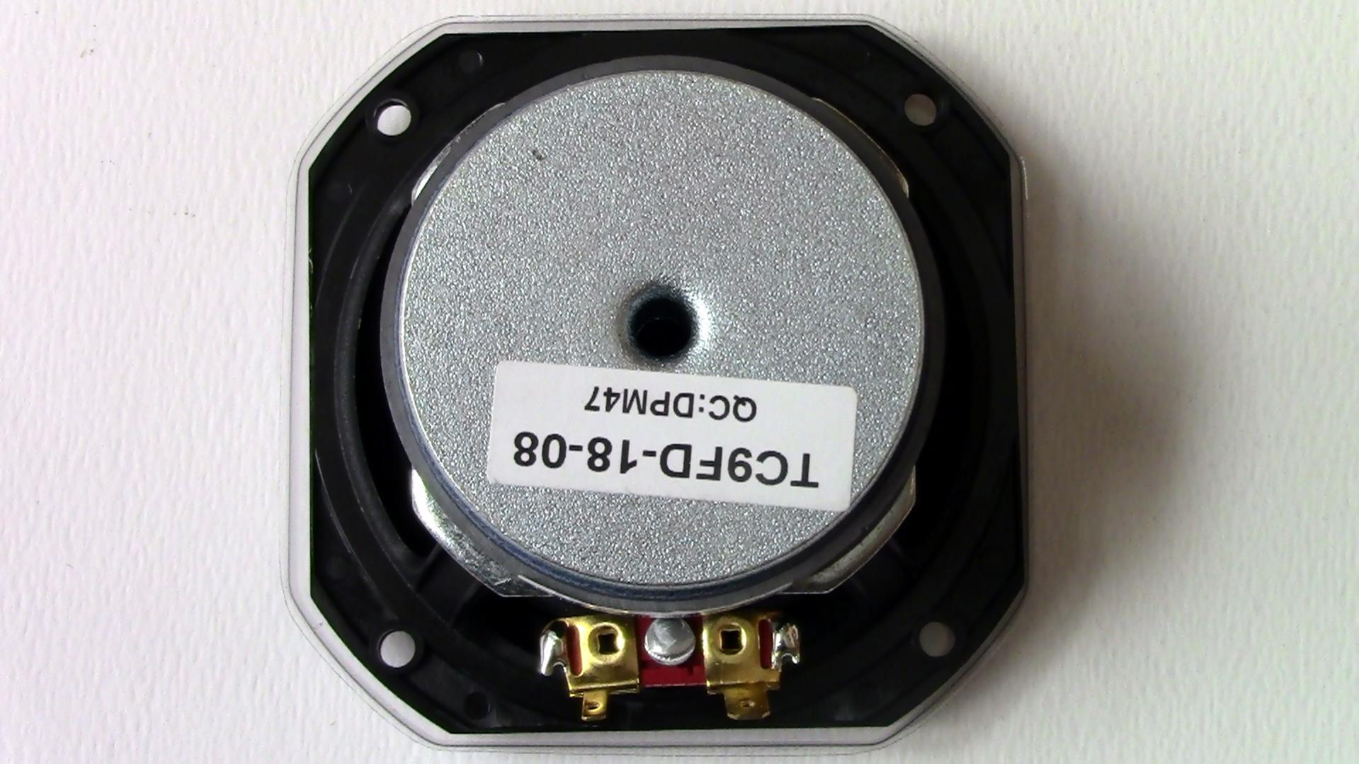

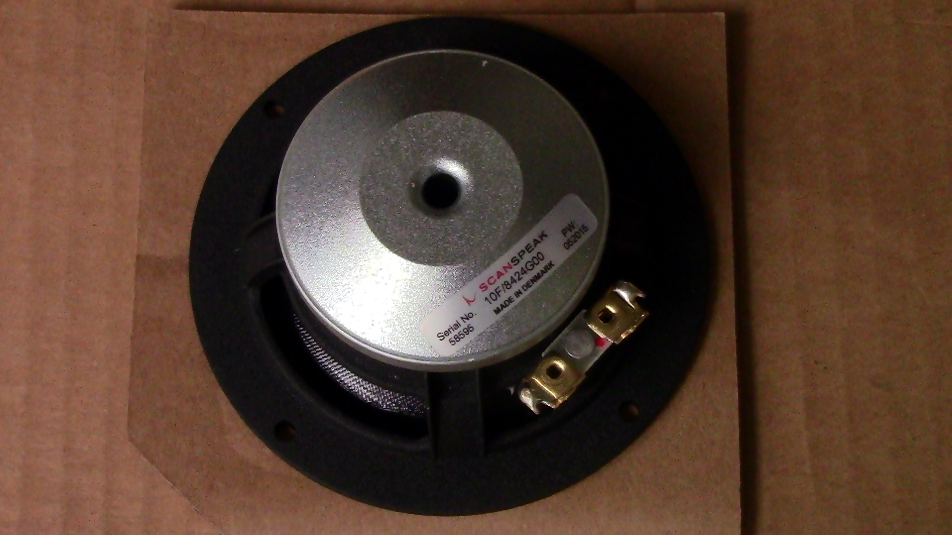

Magnets and mounting...
This is were the significant cost difference starts to reveal itself.
Both magnets are vented. :up: TC9 is ferrite, and the 10F uses Neodymium. The 10F is a lot more stealth in this regards.
The fit and finish on both baskets is very well done. TC9 is poly based and the 10F is cast aluminium.
For mounting, the 10F is circular, and if I choose to build an array with this driver in the future, I would need to cut these to truncate them for closer driver spacing. :eek: The TC9 is already array-able. :)
:magnify: Also, I was very happy to discover that the bezel on the front of the TC9 is flat, under the foam gasket. So one DOES have the option to front mount these. Normal considerations do apply in regards to beveling the inside to allow the cone freer movement. And depending on one's building technique, insetting the TC9 for flush mounting can be a challenge, but as I plan on doing this via adding a hardwood mosaic to the outside of the cabinets, this will not be a problem for me - just have to cut over 120 curvy triangle wedges to fit in those gaps. ;) I would have to do something similar with the 10F too. :D

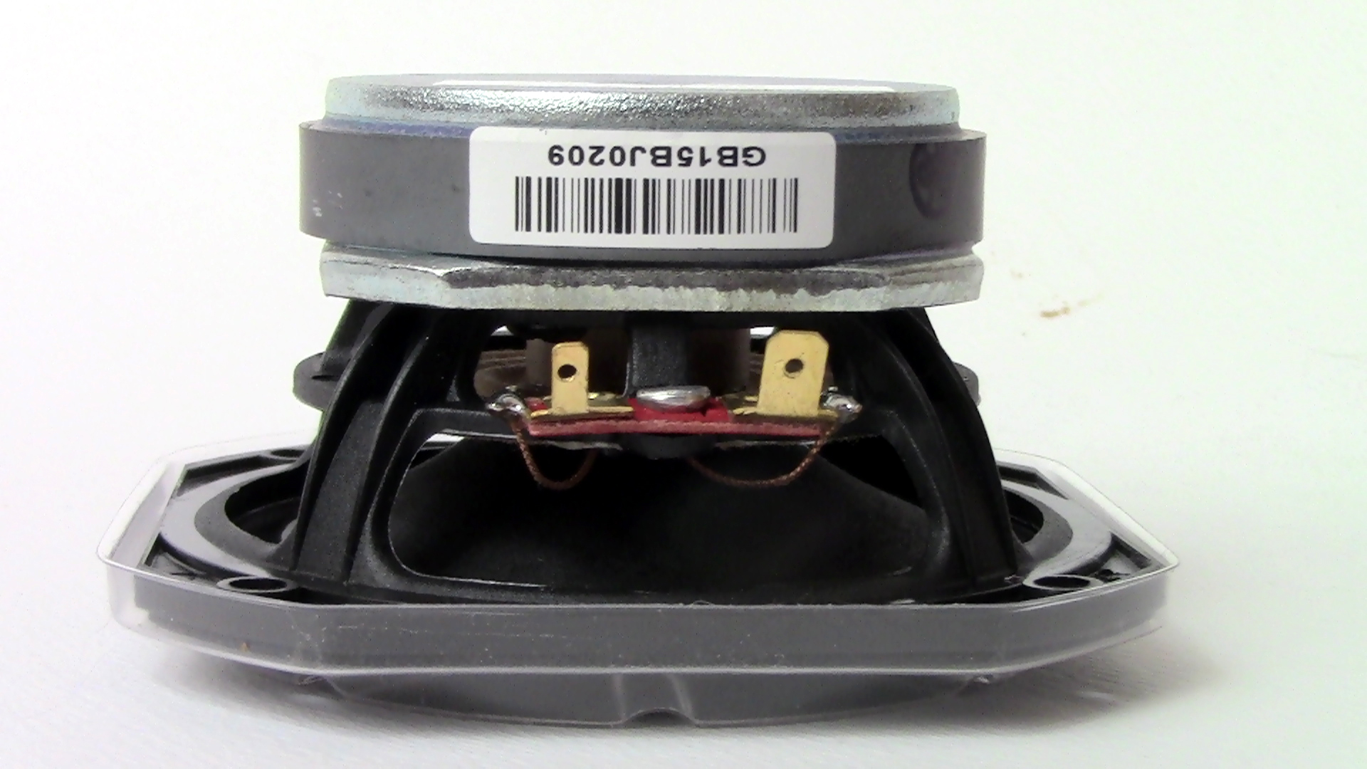

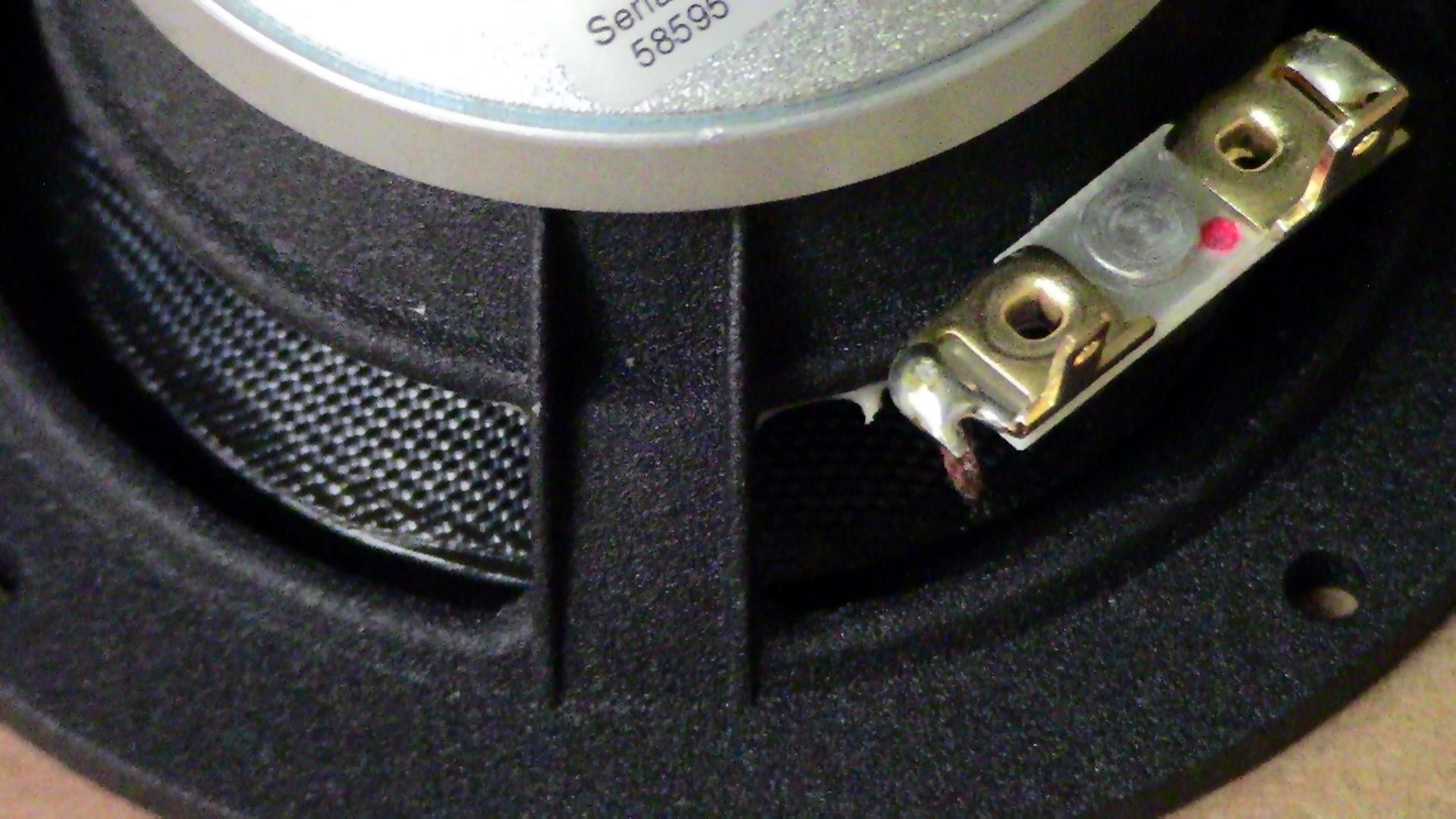

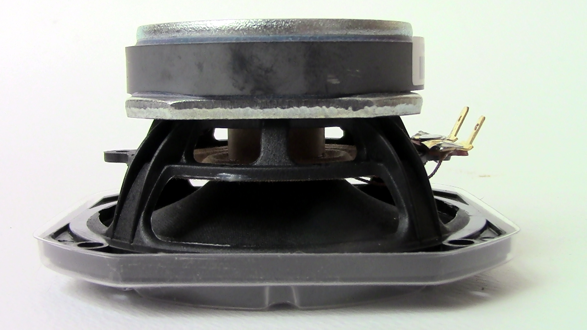

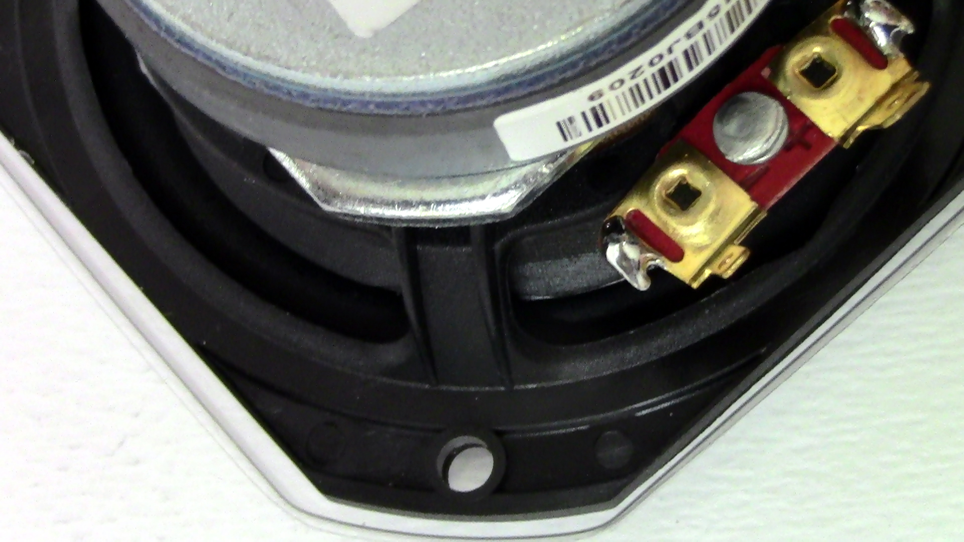

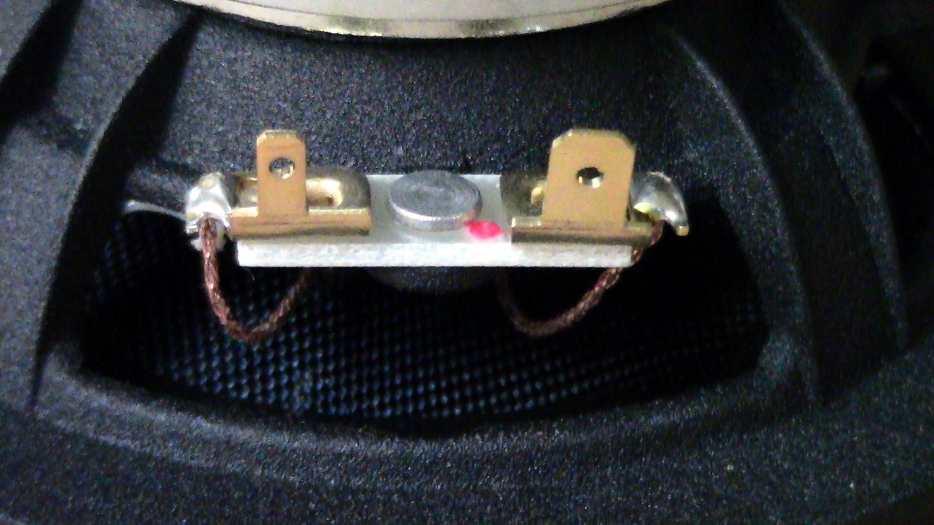

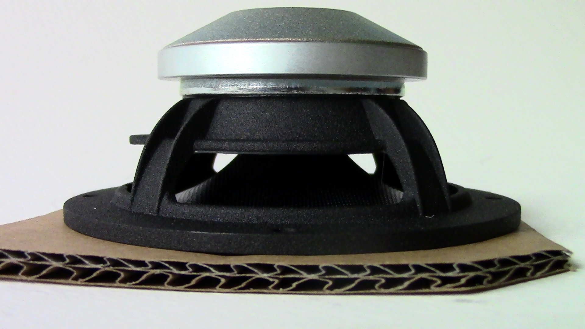

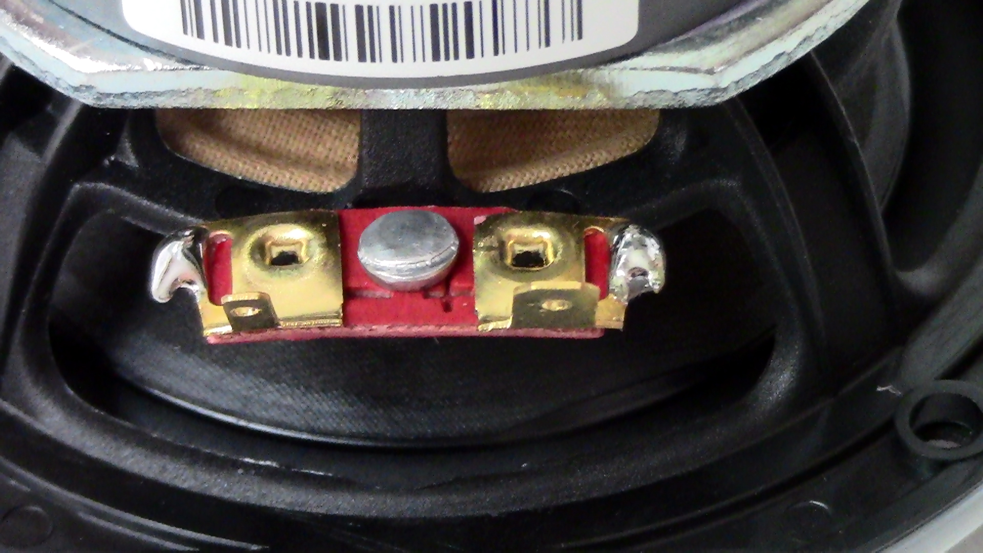

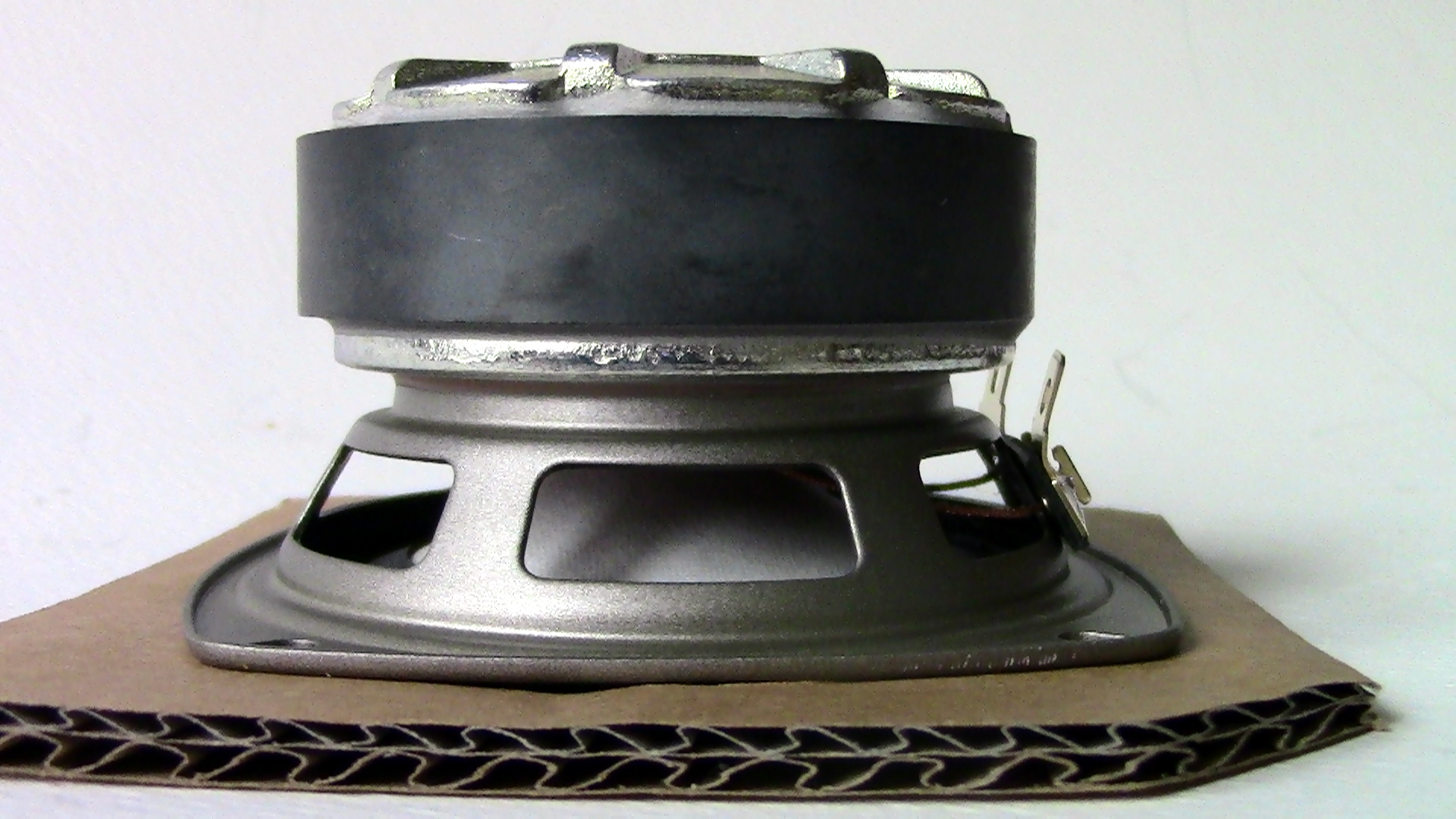

Terminals and profiles
The terminals are gold plated on both drivers, which is always a nice touch.
When looking at the side profile of these drivers, this is when You can see the amazing design work in the 10F, not that the TC9 is a slouch, because it is not. Yet, in theory, the 10F does allow a less obstructed back wave air flow. We will see over time, how well this works in practice. As I am considering the Fostex FF85 also, (last photo), You can see that the TC9 is more "stealth" compared to the FF85. So this is going to be interesting, as my adventure continues...
At some point, I will be comparing these drivers as point sources. When I get to that, I will link You to my thread.
Either way, I am building a TC9 array. Good thing too, because my "Cheap and Cheerfuls" are falling apart :(, so I need a "sensible" upgrade. :D
