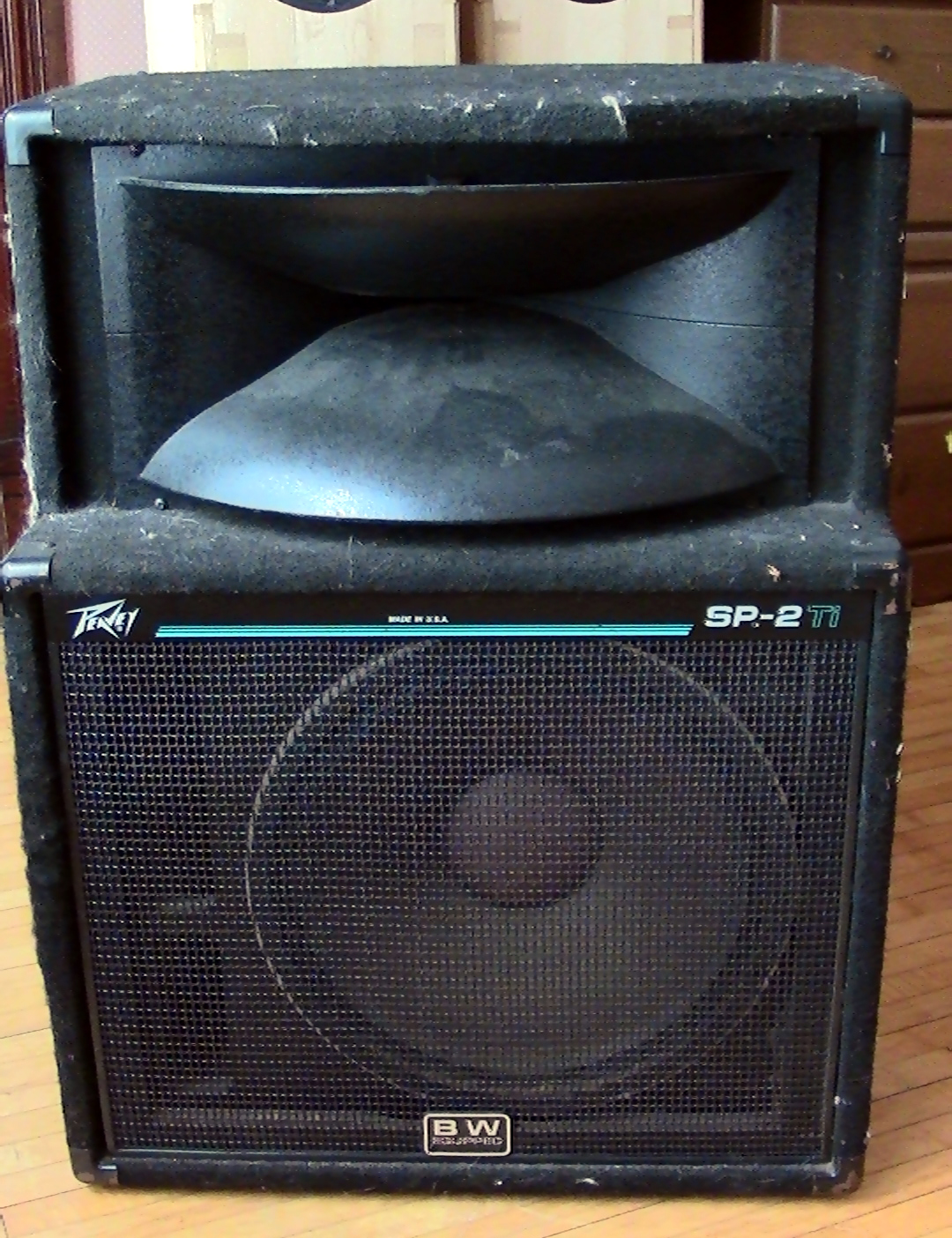

I got these Peavey SP-2s last spring to play with - first photo.
The passive cross-overs are broke, and I can not be bothered to repair them, so I have not had a chance to hook them up yet. But they do have direct inputs for an active cross-over, so once I get my First One going, I will be able to hook them up actively, using JRiver's DSP. I can even time align the unaligned horn. So we will see how a horn system tuned to my room will sound compared to: first my cheap and cheerfuls, and eventually, my TC9's, which I will give a name to when it comes. Something that has something to do with finding greatness with-in our means. :D

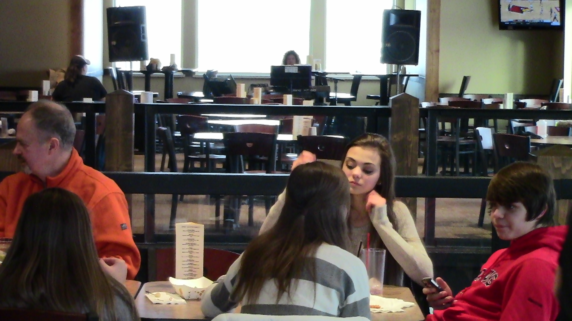

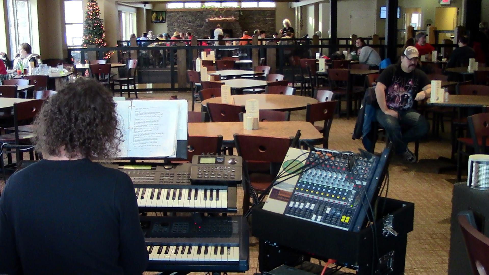

The last three photos are of the venue that I spoke of in post #1843. No, that is not me in the photos, but one of my musician friends. Also, I forgot to mention the speakers in the show: Yamaha club series with the 15" mids on top and sonic 18" woofers (local Wisconsin company) on the bottom.

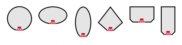

In regards to your build: I realize You went with the lamination technique because of the diffusion chambers you wanted to create. Is there another advantage to this construction technique sonically? I have a different technique planned, but I am interested in learning more about why You chose this technique. You are more then welcome to link me to the answer, as I am dead certain in is in this thread somewhere. ;)
And what about the shape?
I have these shapes in mind (see drawing):
In a single driver application, the first one, followed by the either of the last two would be better for cabinet defractions. But this is an array, so I am thinking they all would work well. What I want to dig into is whether to go wide or narrow, gradual radius or small, or big bevels verses small bevels... I know wider cabinets help with bass reinforcement, but that is not as important for these arrays. I like the circle the best, followed by the diamond. I am thinking mostly in terms of outside cabinet performance, as I will be including some type of diffusion chambers inside also.
