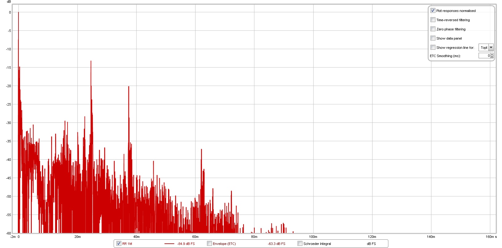

I use speakers aimed away from me to the outside and let them scatter to what they reflect off of. That makes them more diffuse and even have some tail. Have you seen Linkwitz page on his ambient speakers? He's using a Dolby Pro Logic II to extract the ambient information. I just hustle the L-R and R-L and insert a bit of L+R, all band limited (not in that picture) delayed and attenuated driven from a separate amp. I'll think about it what it would take in your case. I did also think about adding reverb, but figured this will do for now.
Linkwitz link: Surround stereo system
I do use convolution to get the FR right in basic shape. But the impulses are left scattered from the reflections which is what I was after. I can test and listen to reflections only as they are fake. They have to be somewhat convincing, right? Yours seemed remarkably clean, not that diffuse at all. Even in the TDA plot.
Surround loudspeaker This?
If so, interesting concept. But on this link anyway, he really doesn't explain or show the ambient effects the tube causes.
As you can see (attached graph), my specular Kickers dont offer much in the way of diffusion or extended decay. This is the area I am currently exploring.
This one: Surround stereo system
Here's my graph:
Don't mind the SPL value of the peak, it's not set like that, this was for timing purposes only.
I tried aiming the speakers a few ways, first firing them up (way too strong reflection from my ceiling), but settled on firing them sideways. I think they don't go low enough to make good use of a reverb. I did briefly try a reverb tail from a hall with convolution. Though it was way too much, I think it could be quite interesting to play with. I did notice some differences with the perception of drums that was very cool.
I have also played with the timing and not done there yet. I first had them at 20 ms for quite a while. When moved to 24 ms I did notice a positive difference. The room felt a lot bigger and more open.
As I introduce the phantom center (L+R) ambient effect separately I have it timed a little earlier, but lower in level. It's quite remarkable how much that still can have an effect on tonality. Needed to work on the EQ to keep it the way I like it and keep it low enough in level not to disturb the clearness in the center. The sides are way more forgiving. But you can actually correct some tonality should you want to. Make it less like a small room and more open. Probably not an issue in your room though. I still have reflections messing with me at higher level than you have and a way longer tail. But still I like what this does, but it's not easy to get right. One day I was very pleased, played a lot of stuff only to find the next day with fresh ears I was surprised to find it messed up the clean center vocals. By a pretty large amount!
Little steps... I know I can do better!
You can pretty much steer the stage with these channels up to a certain extend. But it's easy to overdo it too. I tried to keep it natural.
If you go this way with ambient drivers, aim to get them lower than I did, aim for 60 to ~3500 Hz. Mine pretty much stops somewhere between 100 - 200
Hz. I couldn't use bigger drivers, I needed to hide them in the living room. You can do whatever you please :).
Playing surround on them was pretty cool though. Much better than I had envisioned. Some movies definitely pump you up for certain scenes.
