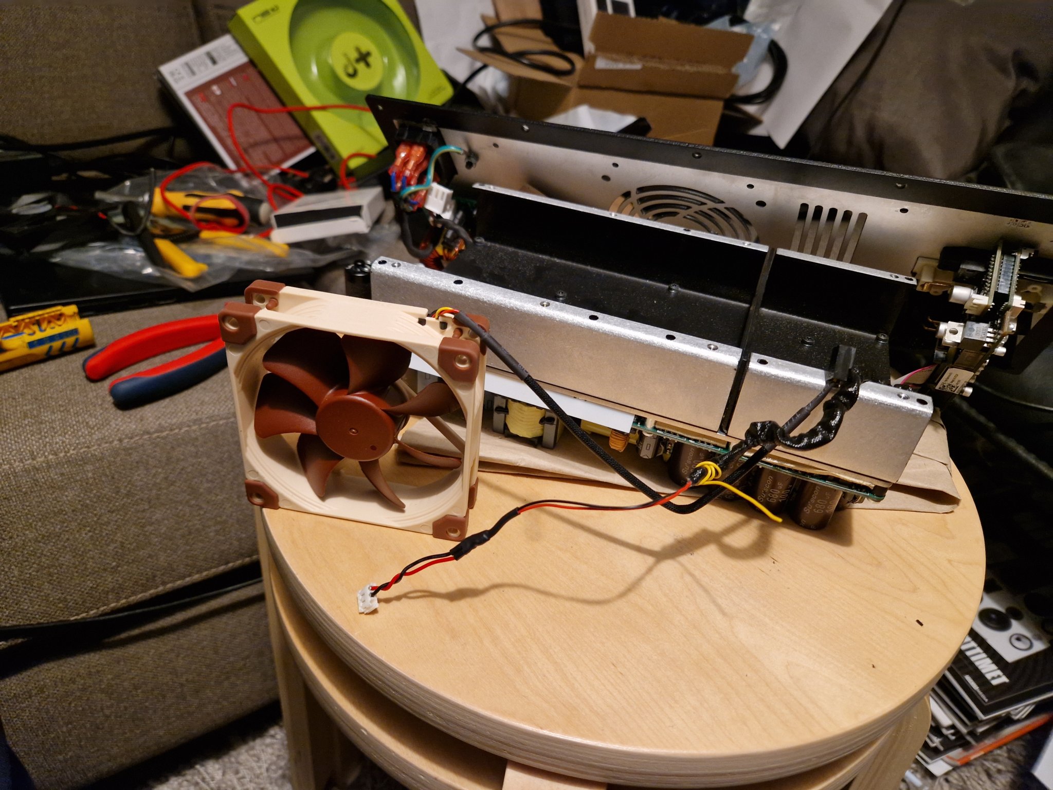

2 wire connection did not prevent PWM control of fan speed. Generally 3-rd wire on PC fans is used for fan error detection and 4-th wire is used for actual speed feedback.
Right. There are both PWM and standard voltage versions of these fans, and the PWM versions can also be driven with a standard voltage output. I would prefer to get non-PWM-model. I doubt that these are PWM driven.
I have done fan replacement to Crown XLS1500 amp and it works fine.
Maybe more difficult part is the disassembly, has anyone done that? And does 25mm thick fan fit?
Reactions: IamJF
Yes the fan i have is non pwn, these fans dont like to be voltage driven also.
They use always 12v and the pwn controller set the speed for them.

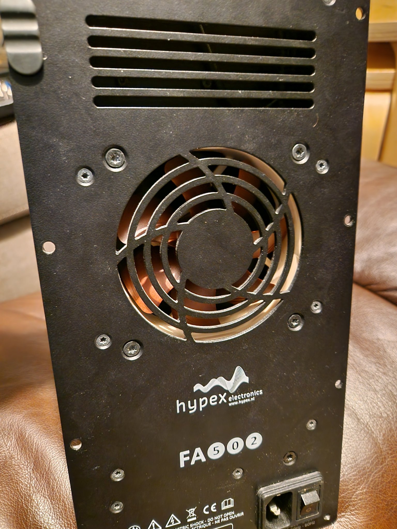

A 25x90mm fan will fit the oem fan is also 25x90mm, i look for what i need before i order the 90mm fan.
Assembly is not hard you need to remove the amp section wat is above the fan with the screws on the backside.
Then you can easy replace the fan the mounting holes are the same with a 90mm fan.
Look with first use the fan will spin in the good direction thats all, the airflow must go inside the amp not to ouside.
NF-A9 FLX from Noctua is very powerfull and silent, has very high airflow for that size of fan.

I did it. Yey. Seems to work fine, at least it spins when I switch the amp on and off.
I cut the original cable in half, soldered it together to a extension cable, and applied heat shrink tubing over it. This had to be done with the cable pulled through the conduit.
Original fan model is Jamicon JF0925B1H--R.
Reactions: Palmspar and IamJF
Just finished another one, and it works great! At half a meter away, I can hear the fan noise at night, but it's completely inaudible from my listening position. The amp seems to be running perfectly with the new fan, as it is on at about the same rate as before. Happy with the results.
