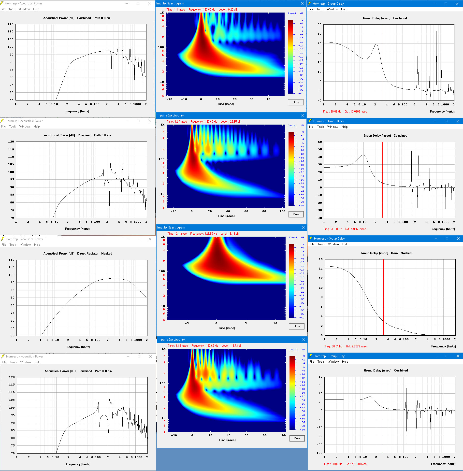

~420liter tuned to fs/24hz, 15hz/octave below desired cutoff, Sealed, and 17hz tuning.
Hi camplo, i guess the reason you provided 4 examples is to show the continuum available in the tradeoff between group delay vs freq response.
If i look at your first example (fs/24hz) vs the last (fs/17hz), the tradeoff seems resonable and worth exploring. About a 1dB drop in response at 30Hz for the 17Hz tuning, in exchange for almost cutting group delay in half 30Hz, 7ms vs 13ms...(scales are way different on delay graphs??)

HornResp won't allow you to control scaling...I know. I can't say exactly what my programming was and its a miracle I remembered, the next wake up, what the tunings were, to a graph I created at 6am post 24hrs. its the 2x 18h+ driver, s1 5000, s2 5000, s3 660, s4 660, l12 72.60 l23 .1, l34 109.2...this is about the same box I used for the graphs. Slide the length of the port to raise tuning.
I did scrutinize excursion. At 30hz, excursion is un bother by the tunings below it. 24hz tuning was not influential enough to 30hz, that 15hz made no major difference at 30hz, as well....which is kinda what was catching my eye to begin with. I'm always staring at 30hz because thats my design cutoff.
2.1MM at 30hz/100db with one driver. I'm modelling for 2.
Also, view the -30db timings in those graphs. 50hz-40hz is an interesting area. If you imagined sound as color...imagine a trail of lingering fading colors blurring the true colors of the view. Sounds kinda like mushrooms....the room is worse behaved, but lets not have this tendency be a large part of direct energy.

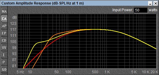

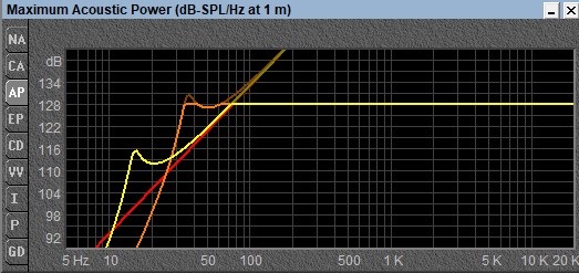

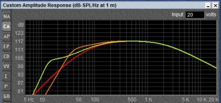

Here are some simulations of the TD18, red is a fairly small sealed box with a Q of 0.7, orange is an EBS alignment tuned to 33Hz, bigger box than sealed, and yellow is 420 litres tuned to 15Hz. When plotted on the same graph it is easier to see the difference.
attachment.php
The big box can go lower but at reduced maximum level. By changing the volume and tuning the rolloff can be adjusted anywhere in between something like sealed and drop off a cliff vented.
If maximum output to 30Hz is desired then standard EBS gets you there.

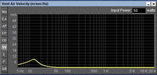

The speed in the simulation I ran was quite low 10 m/s peak at 15Hz 50W input, but the port that produced it was 160mm by 575mm flared both ends. Speed could be traded for port length.

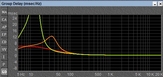

Here is the group delay graph, I didn't post it before because it seemed pointless. The more you push the venting the more group delay you get.
As for the spectrogram BassBox does not have one just turn the group delay chart around and imagine the colours 😉
The "fingers" are reflections that hornresp calculates, in anything other than a bare box they won't be there anyway. You can also turn it off in hornresp with the mask / unmask reflections control.
The main point was to overlay the responses on the same graph for easy comparison.

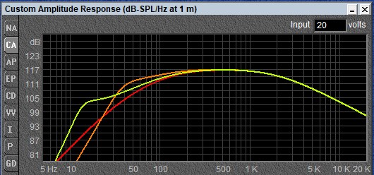

I can't be entirely sure, when I changed from watts to volts it showed about 21V now changing back and forth between 50W and 20V it stays the same.
For clarity this is the graph at 20V, slightly lower than before.
