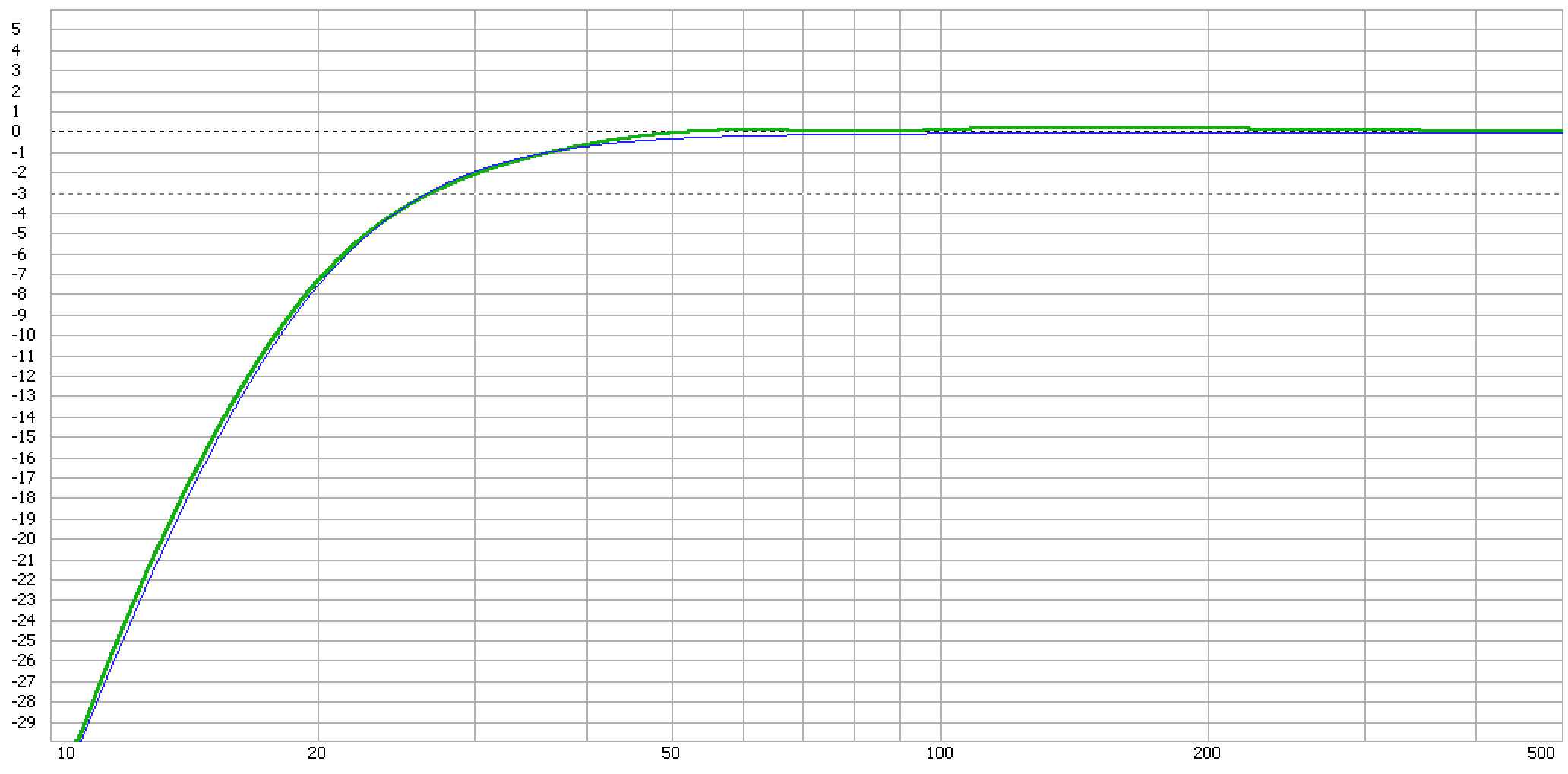

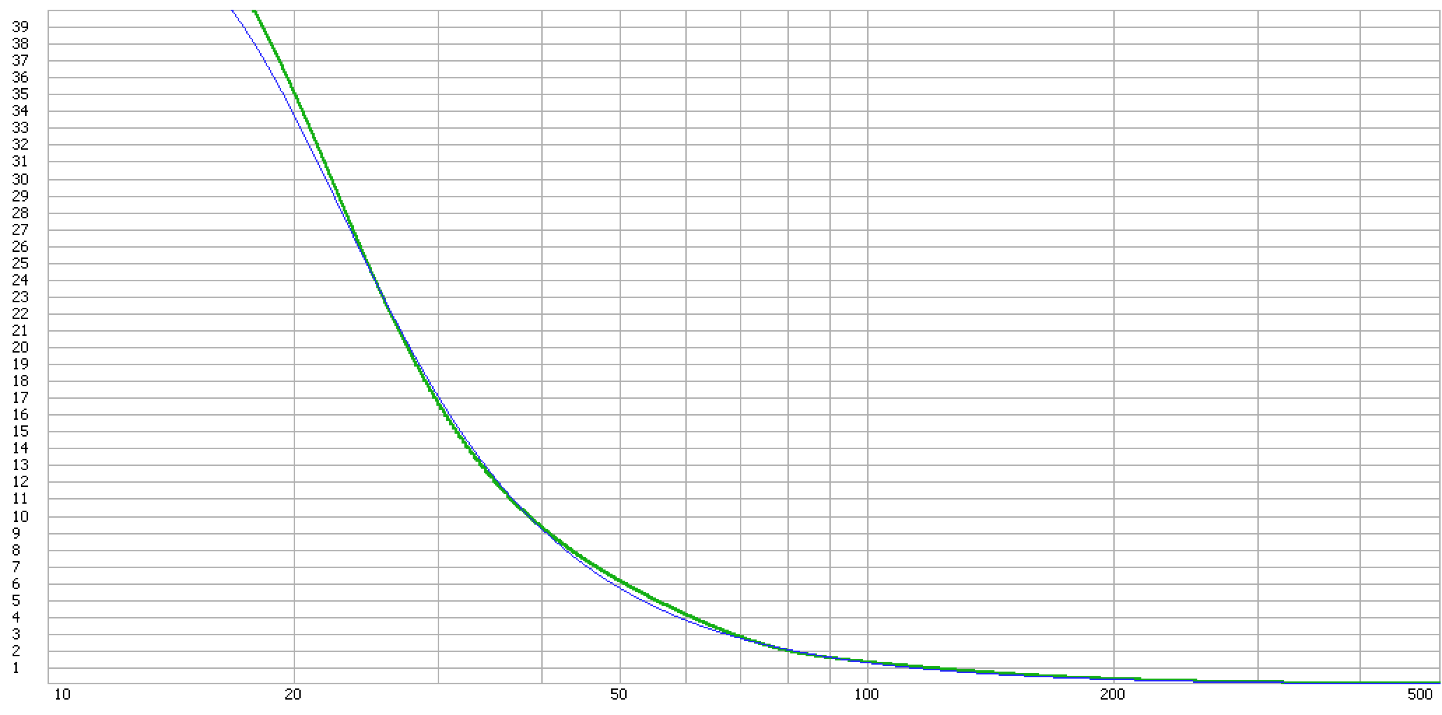

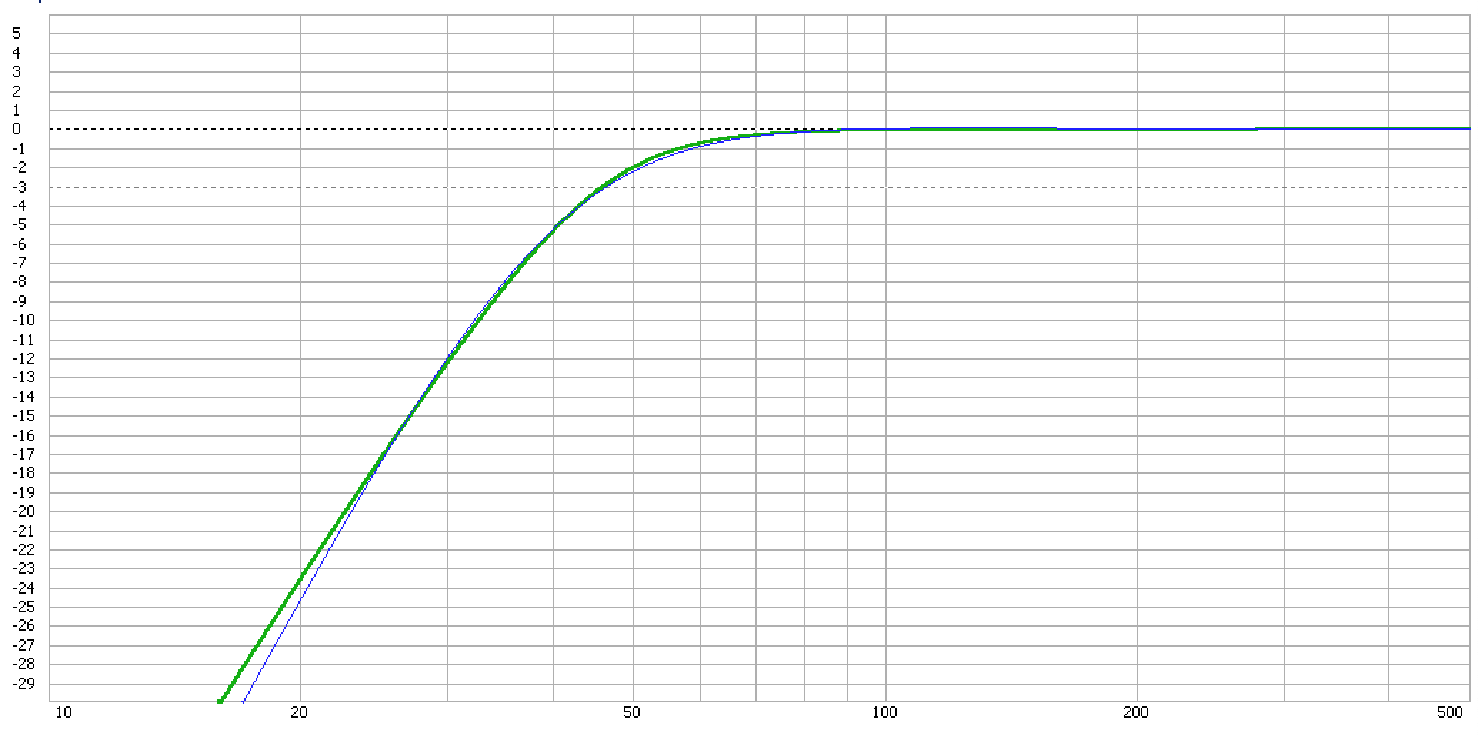

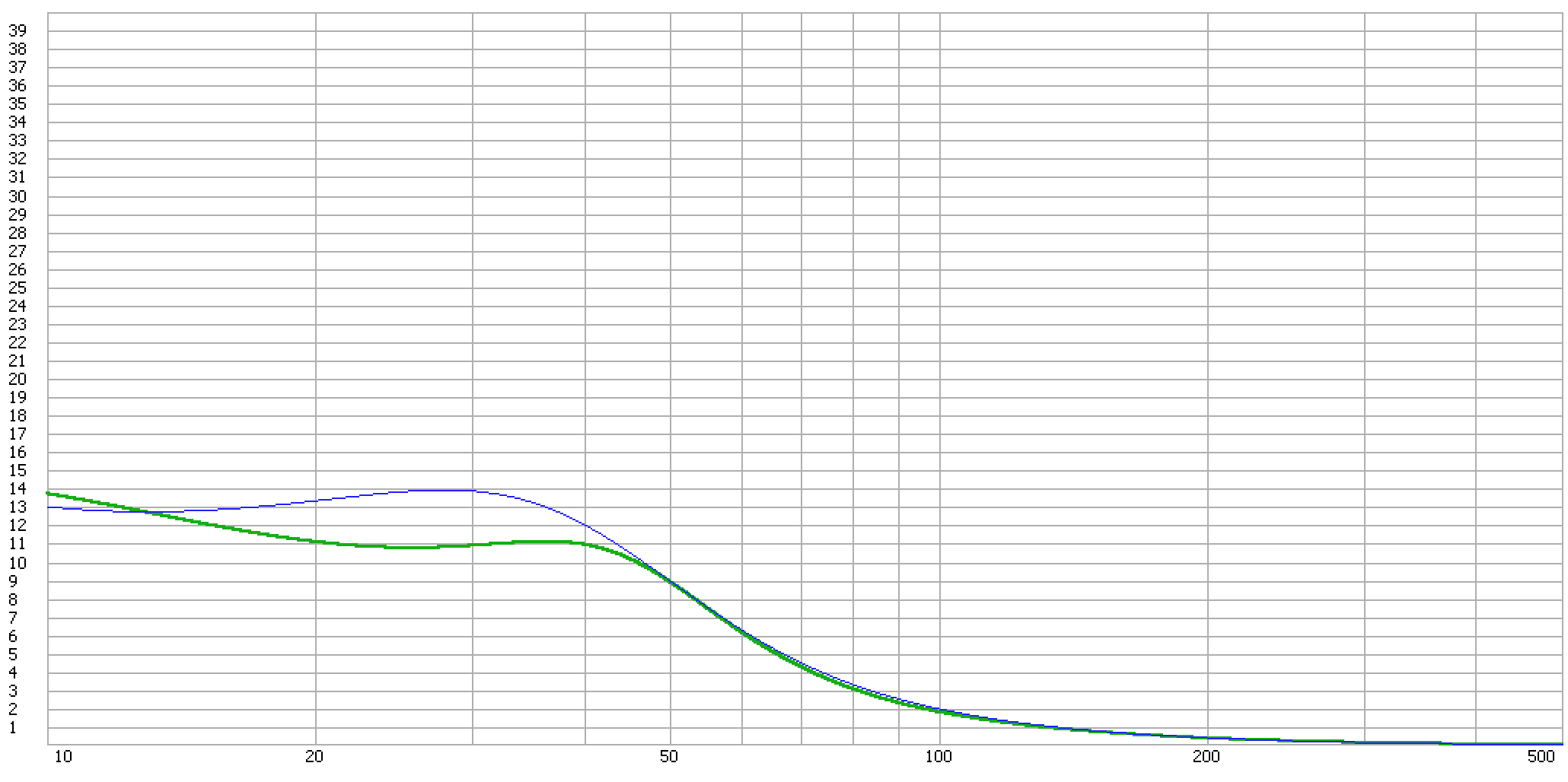

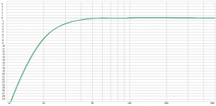

See the two graphs here, one vented (green), one closed (blue). It's really hard to get them exactly close, but I think it's quite good. The closed one has a LT to extend the response, and an additional high pass to match it up. Very much as you would actually do for a closed box sub. Next check the group delay. It's also not perfect, but very close. If you look at the frequency response, you can see that the area's where it differs are actually exactly there.
For reference, this is a RCF LF18X401. 98L vented @39Hz, vs 61L closed. Obviously, when you look at maxSPL >30 Hz the vented system wins, however at 20Hz the closed system as 10dB more headroom.
You can change that of course by lowering the tuning frequency. Let's say to 20Hz. This will skew the response, but will give you about 6dB more headroom vs closed at 20Hz. If you "only" need 110dB/1m at 20Hz, you can EQ it flat just fine and use it at full power 😀
Let's do the exercise and see if we can align the two boxes at this config. Graphs attached.. Group delay is virtually identical.

LT means Linkwitz transform, a low shelf with a notch, helps change the rolloff Q to a different value. The values are not really important he's trying to show that the time and frequency responses are linked. Make a sealed roll off like a vented and the group delay ends up being very similar.
I do that on my line array, extend the low end and roll it off at 24dB per octave. Sealed box with a response like a vented but no over excursion below tuning and without the extra boost in efficiency from the port.
Exactly.. it doesn't really matter what kind of fancy filtering is used (in the IIR domain at least). Group delay and Frequency response are directly coupled. Woofer system A (woofer, box + EQ) having the same response as woofer system B will also have the same group delay. I'm betting the decay will be pretty much the same af well.

Yes, one can equalize sealed and vented so their frequency responses are identical. And this seems to imply their phase responses would also be identical. But this isn't true because vented box isn't minimum phase - there are two sources of the sound it produces.
