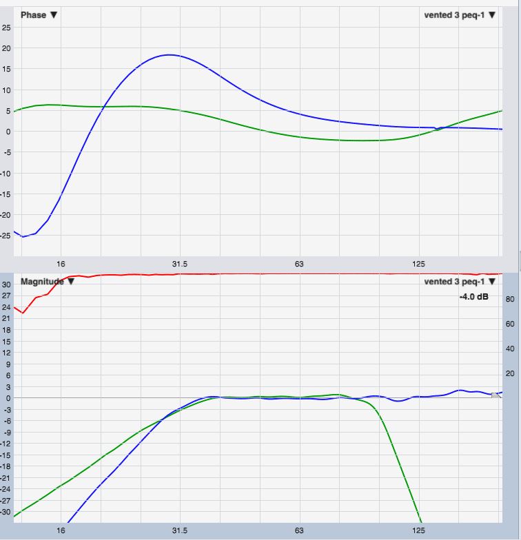

Anyway, below are some old measurements of the 18n862 in the vented and sealed boxes.
Green is the sealed with LT in place, along with 3PEQs
Blue is vented, notes say it too had 3 PEQs .
I can see I missed some apples to apples with freq response..as sealed doesn't roll-off as fast on the bottom as the vented.
And why I had a low pass in place for the sealed and not for the vented I dunno. Guess cause all I cared about was how the bottom ends compared.
The top box says Phase, but it should read Group Delay. Smaart has needed to fix that when toggling from phase view, ..for years..

Negative group delay? Im pretty sure the vented group delay should rise not fall if there is no additional filtering applied
The negative delay on the sealed says the timing reference Smaart choose was off a little. That's what I get for having the low-pass filter in place....that gave nothing concrete to time to.

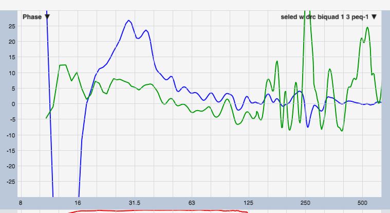

Here's another picture of the Group Delay with some smoothing removed.
Any data below 20Hz on the vented I would be suspicious of...not enough response to provide good coherence/confidence.

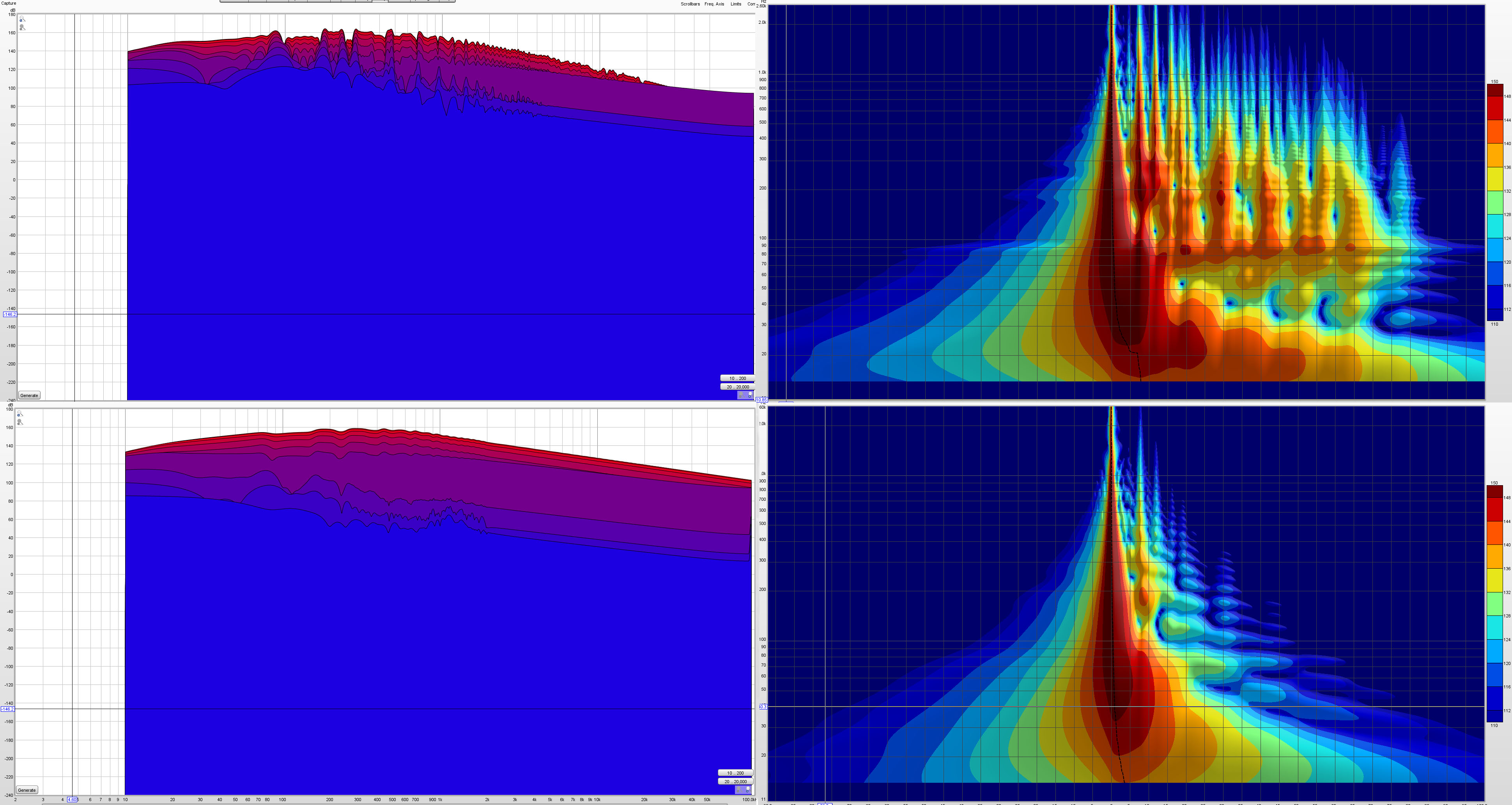

I ruled them out because I couldn't model the decay...and now that I can see it. I'm still building a sealed. It is interesting to see how well behaved a TL is with dampening. Heres a 289ish liter MLTL moderately stuffed (100/100) and unstuffed.

I'd say that only one of those is a well behaved vented cabinet.

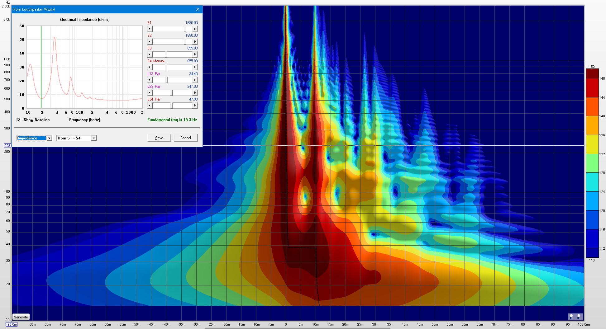

Here is a MLTL that I was so confused about because at the time I was trying to judge how resonant my designs were based off of impedance readings, and though there is a connection, the two systems are not one, in reference to dampening driver vs dampening the enclosure. Here I have dampened the front portion (little under 1/2) of the line, so much, that it has dampened the driver significantly. The impedance shows a peak of ~50ohms and for this 18" and that sensitivity would be awesome if it weren't for the fact that the rest of the line is completely empty.

That was my point you compared matched magnitudes above rolloff, to compare sealed to vented as regards group delay you need to match the rolloff slope, a 12dB filter at about 30Hz would probably get close.
I've never seen any simulation where the group delay on the low end is lower than above that. In your case It actually dips below the fairly steady level at around 200Hz. I don't think this is what group delay does. As I've said before, I think it should rise, not fall. The graph is probably not alles "group delay" for a reason 😉 So then what the hell is it?
