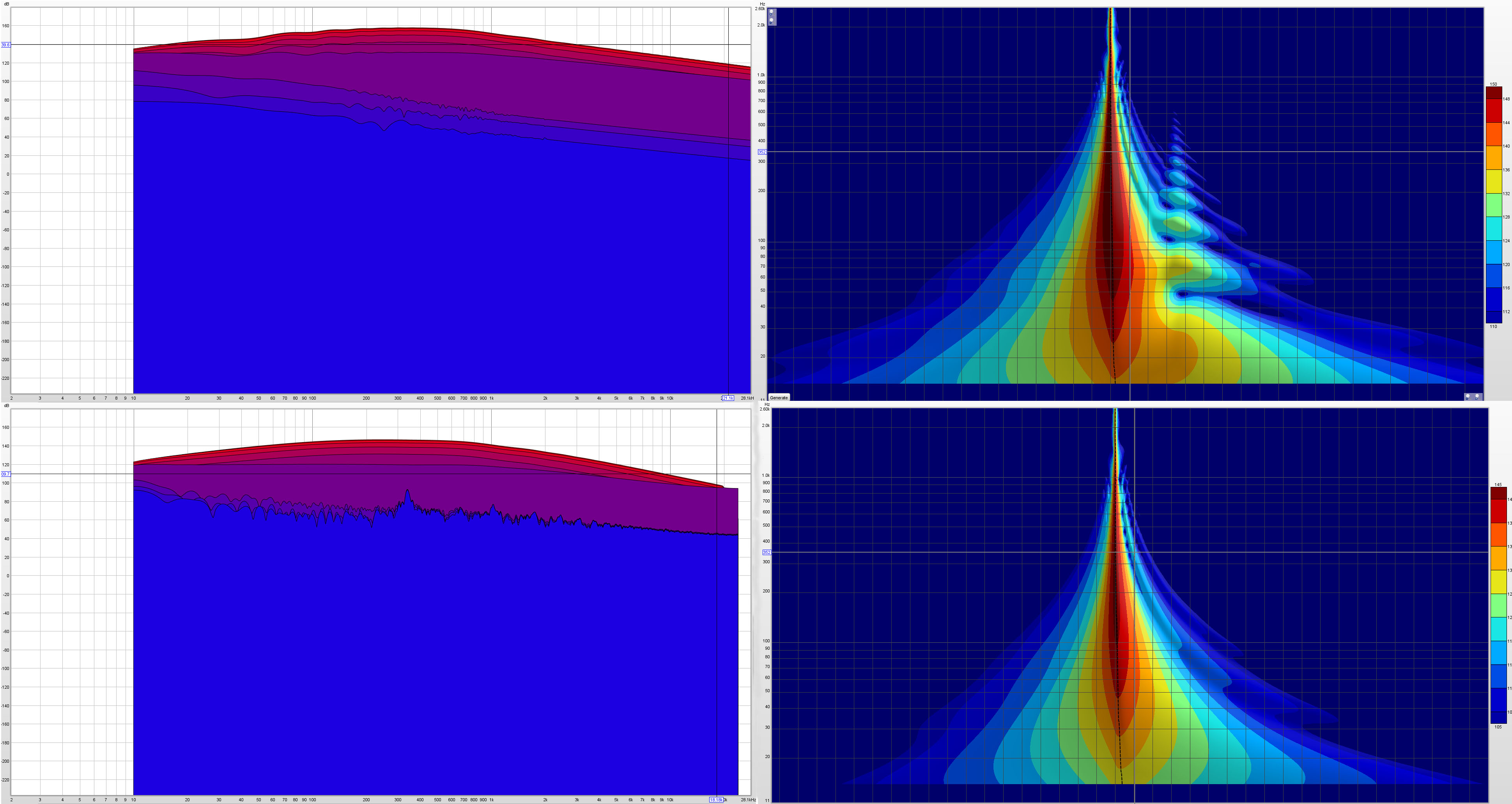

I've put the same driver, bms 18n862 in both a sealed box, and vented box tuned for 31Hz f3.
Then i matched the sealed to the vented response via linkwitz transform(LT) using minidsp.
The sealed sub with the transform easily had the lower measured group delay at 31Hz. Which in my mind stands to reason, because a LT is essentially an out-of-band magnitude flattening, which also flattens phase.
However, once the LT got swamped by the sealed's natural roll-off and its response turned sharply south, group delay shot up even faster than the vented's.
(Hopefully neither of the boxes gets asked to go much lower than f-3.)
Should add it took maybe two sealed with LT, to match the SPL of one vented. And excursion below tuning was about an equal issue to solve for both.

So how closely were these matched? Only a LT will not give you the same response obviously. As can be seen from my example, only a little deviation can make quite a big difference in group delay already.
Is this what was measured? How did that relate to the simulation? It really sounds like it does not match up with the simulation. In that case, one of the two is wrong.. or something else was measured. In the last case, we should find out what that was. Hence me asking
