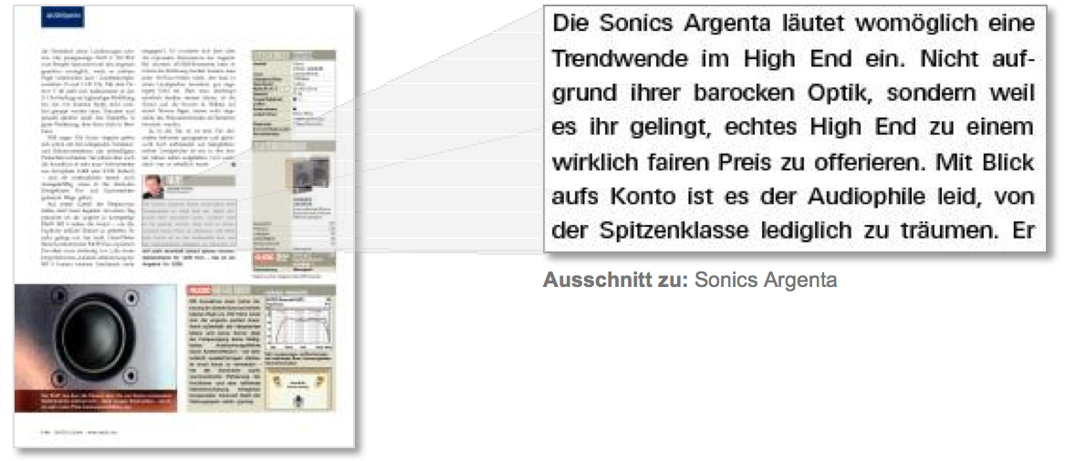

The Argenta had a very flat response, also off axis.
The drivers where really in phase over a wide range.
Some people said they where a bit sharp and thin so i made the Argenta Edition.
I think that had the SEAS ER Reedcone.
I brought it to Audio for another test.
They did not like it as much as the original one.
Not as crispy etc. and so it goes ....
We professionals often face a firewall of revievers so it can happen that a model that you really like does not get the attention it deserves and sometimes it is the other way around.
They freak out over a model that is not so important for the designer.
