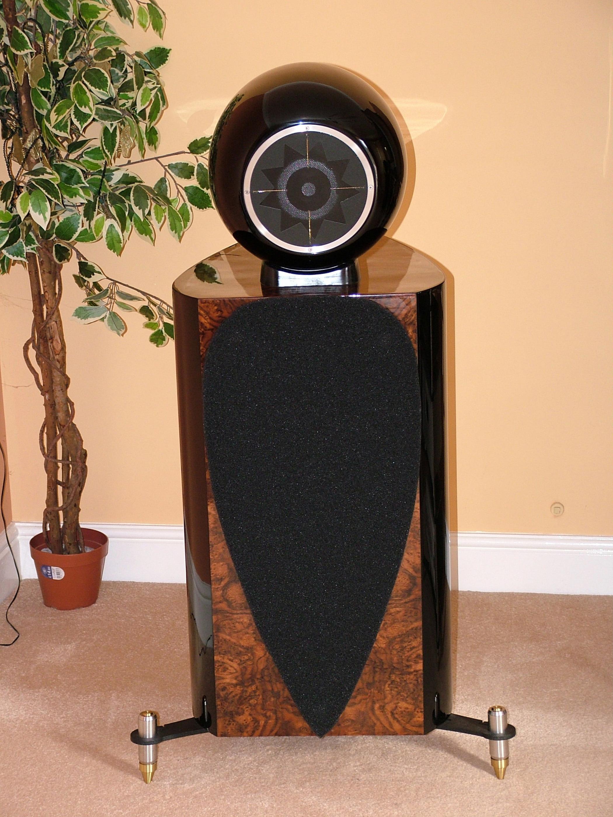

I was talking to my brother in law on holiday, and he told me his stereo setup was Audio Physic Medea speakers with Manger units designed by yourself. He apparently flew out to meet you a few years back. These are not exactly it but give the idea:
Yours are 3 mangers and 3 bass units AFAIK.
He also uses Manger units for his 5.1 home cinema. They are the spookiest speakers I have ever heard. No colouration at all, which was weird to listen to. We are not used to speakers like that. :scratch1:
Manger himself crossed it too low and not steep enough.
Also the two side firing ones increase the area of radiation.
I did not invent the side firing ones but i used them in another way, in the time domain and also mechanical.
The damping of the head was very specific.
I created an internal resonator so that the side firing ones pushed the front membrane forward at specific frequencies, also known as the " Manger hole".
Manger did not like that name at all of cause.
Manger being a sceptic also did not trust in " audiophile " parts like high voltage P-P caps and of cause we listened to wiring and such.
The cabinet was very special, like a funnel.
My bass tuning was very different.
Manger went for a Qt much under 0.5 so his monitors went deep but did not have any punch to talk about.

The Manger driver
The rarest of animals. Only 115 pair where ever made.
The 3 dimensional sound is scary.
I studied the Manger transducer for 15 years before i created it.
Solved the problem with dynamic range.

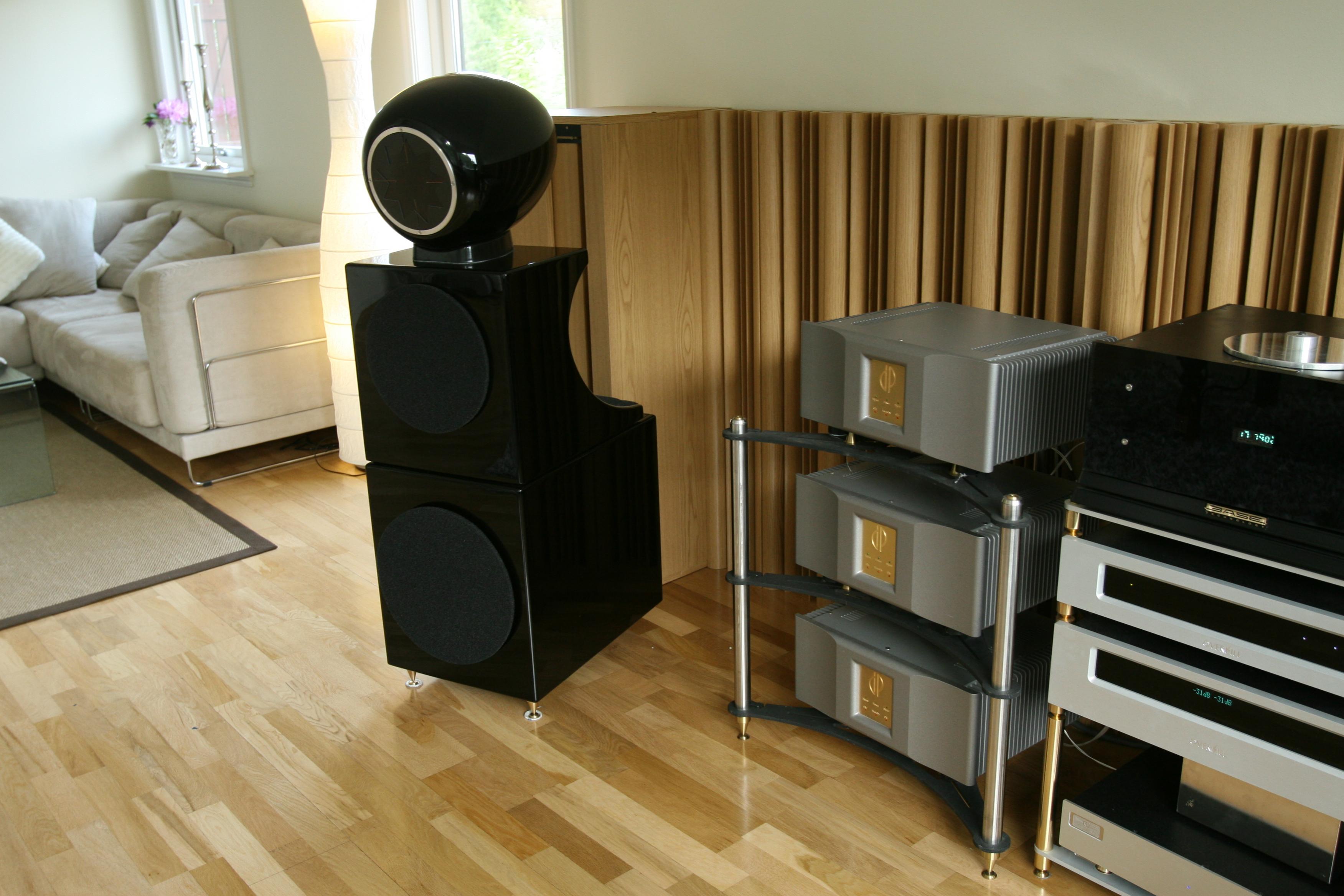

The two way Ovation and three way Finale are attached...
Daniela and Joseph are lovely people, really hard working and dedicated.

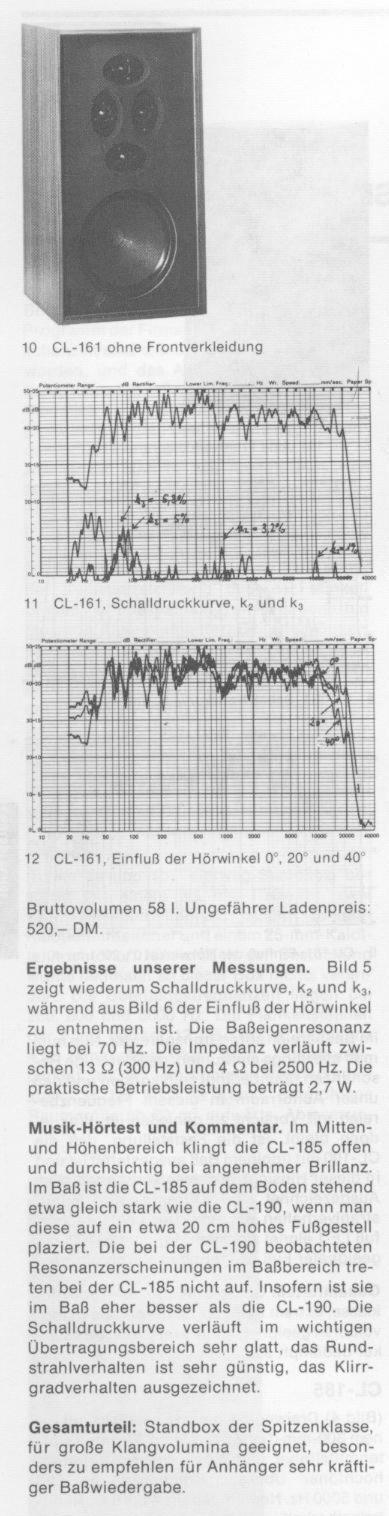

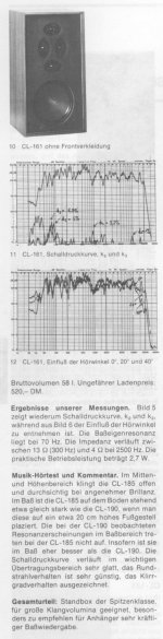

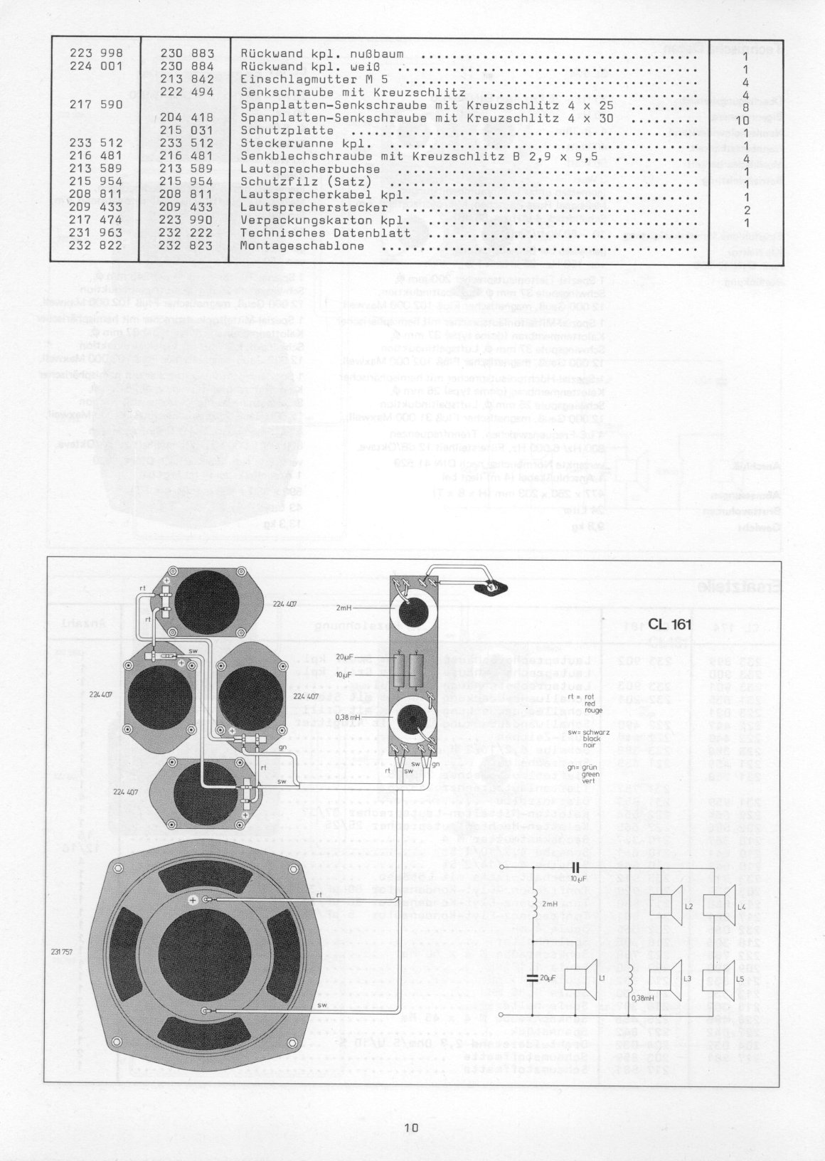

When considering german "Dual" brand's models from the 70's, IMO Model "CL 161" is even more interesting and unique from a technical point of view.
Attached pictures show wiring and front baffle. A rather simple model of course ...

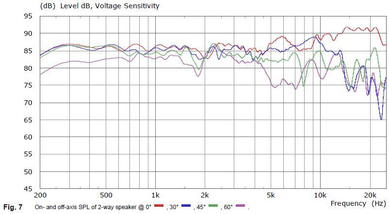

Some data concerning bending wave designs e.g. from Manger, Naim ("BMR") and German Physicks ("DDD")
Manger:
http://portal.tugraz.at/portal/page...ige BA PA DA/DA_Hiebel_Biegewellenwandler.pdf
See chapter 8 for a small collection of measurements also made independently from manufacturer.
Naim "BMR", based on "New Transducers Limited" now "HiWave" patents:
See 1st attachment for frequency response under angles.

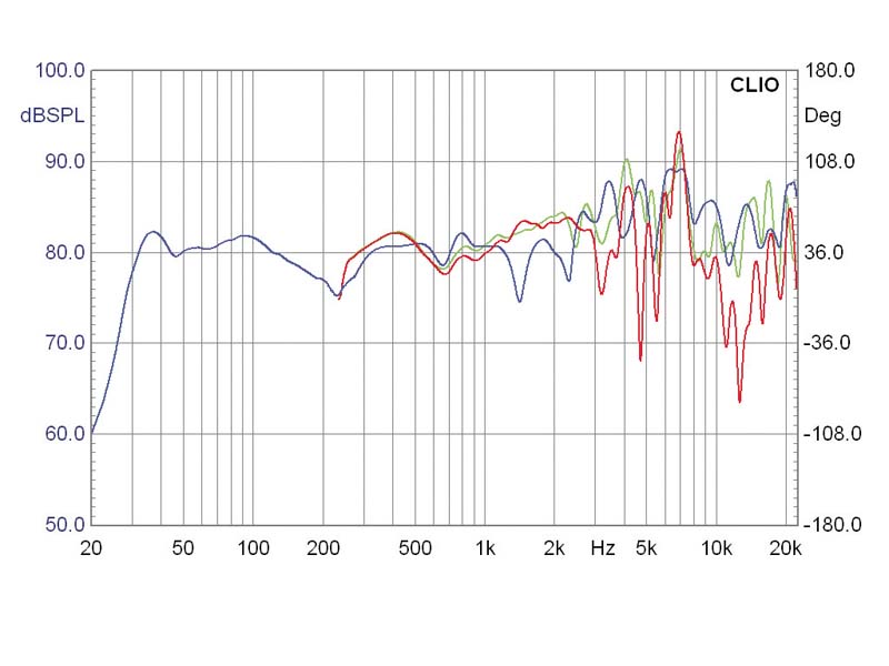

German Physicks "DDD", based on Walsh approach:
See 2nd attachment for frequency response under angles >400Hz.
Those angles are "on axis" and "vertical angles" 25cm and 50cm "above the transducer", unfortunately those "professional journalists" do not report even the distance. Also they assume the radiation to be radially symmetric (by the looks of the driver i suppose ...), without having even tested their assumption.
http://www.hifitest.de/test/lautsprecher_stereo/german_physiks-hrs_120_2971-seite3
