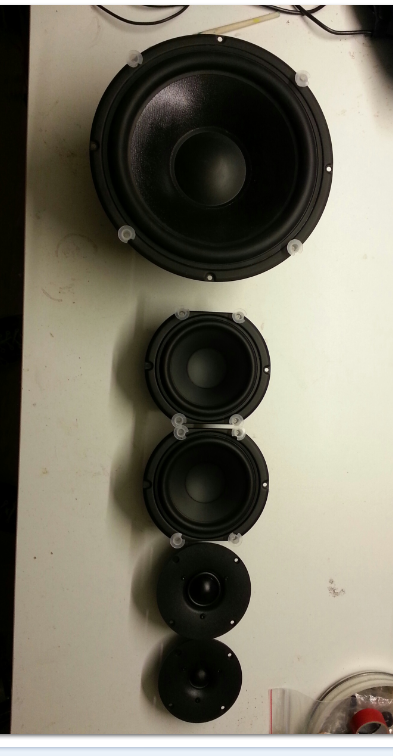

Now i am thinking about the cabinet.
For the woofer a closed cabinet of ca. 70 liters is ideal.
It will then have a butterworth response.
The DUAL CL190 has a rather flat and wide cabinet.
I thought that there is only a little step when i go to this :
Google-Ergebnis für http://i234.photobucket.com/albums/ee133/rsfmotoman/BoAcA400_3971.jpg
I heard that speaker over 20 years ago and it sounded great.
That cabinet shape also has the advantage of very little baffle step and it does not need a stand.
So what i will build is a mix of german and american vintage.
I have now all drivers in house.
I think this is an impressive asortment by any means, and even not that expensive.
I am contemplating two layouts :
One is the more modern inline of the midranges, the other is the traditional side by side.
I am gavitating towards the side by side.
It looks more compact to me.
-unless you are pushing that lower tweeter *really* low (with a relatively low low-pass for the mid.s), it's not something I'd do (..and I don't know why it as done originally). At the very least that first meter is going to have a strange polar pattern.. but if the standard listening distance is 3+ meters then it may not be much of an issue.
If you had used the peerless 1.5" cone mid-tweet in a x4 "line" it would have been more viable IMO. 😱
-speaking of Peerless, have you seen their new "preliminary" drivers (in their "Silver" line)? Might have been interesting to use them in a design like this.

..a 900Hz to 1kHz crossover

For those who aren't aware, Zaph has the lower tweeter (without ferrofluid) tested on his Blog:
Zaph|Audio
http://www.zaphaudio.com/temp/Wavecor-TW030WA05-01-FR.gif
http://www.zaphaudio.com/temp/Wavecor-TW030WA05-01-HD.gif
http://www.zaphaudio.com/temp/Wavecor-TW030WA05-01-IMP-2.gif
http://www.zaphaudio.com/temp/Wavecor-TW030WA05-01-CSD.gif
The harmonic distortion of the ferrofluid version at lower freq.s should be even better.
