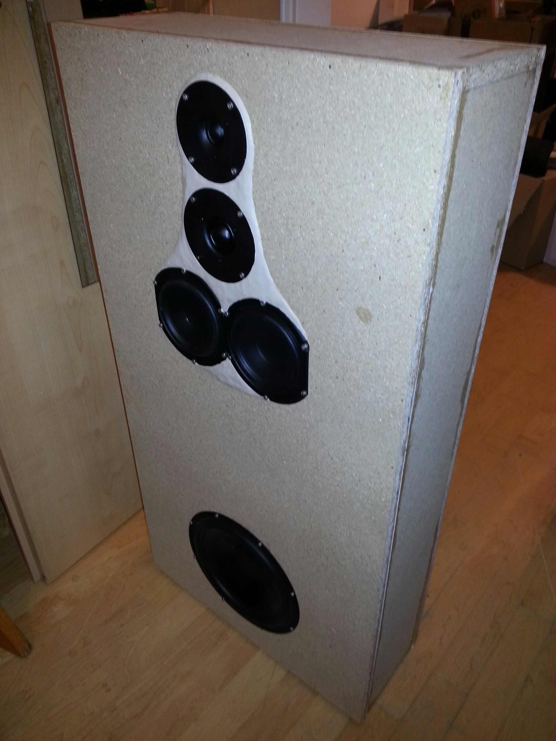

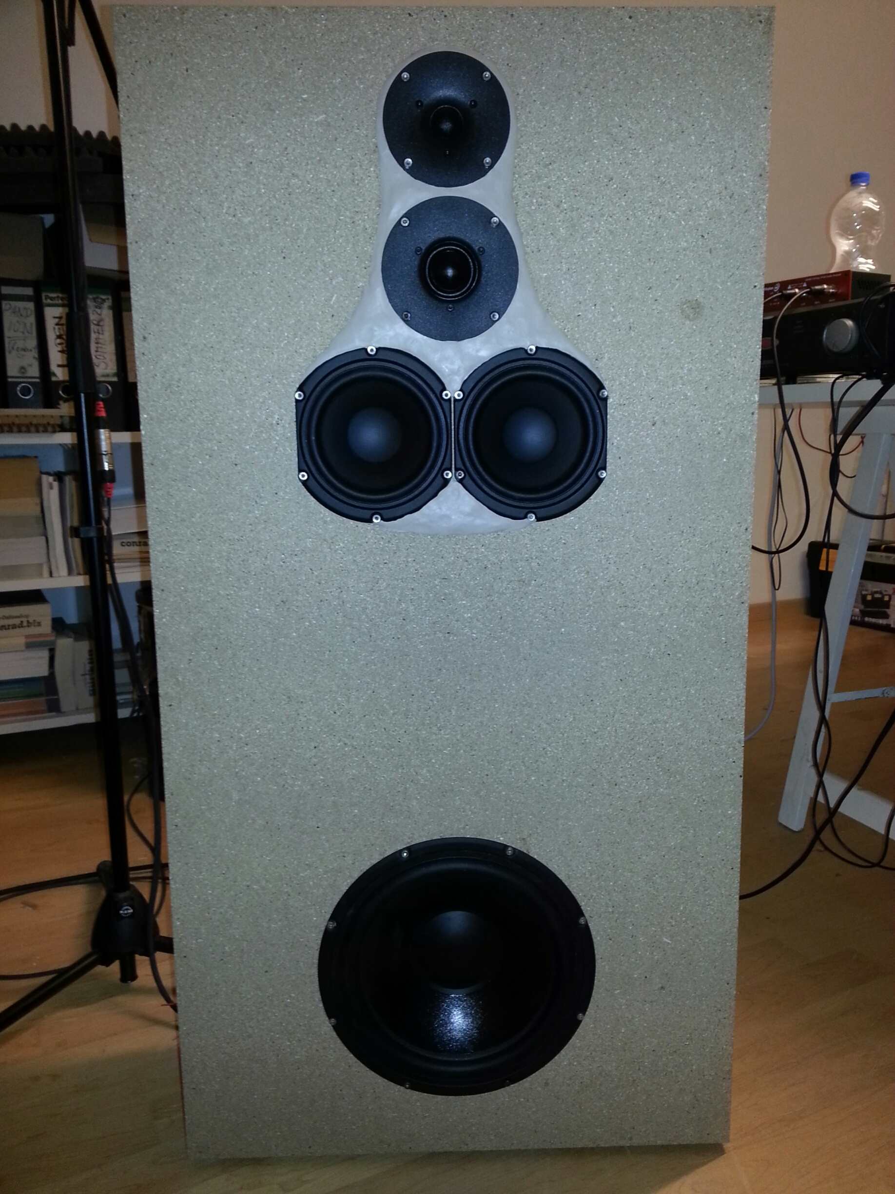

It's shaping up to be a great design.
The combination of a lower tweeter and dual midrange should give very low distortion and dynamic capacity. It's the kind of speaker that I see and I'm immediately curious to audition.
Arranging the mids side-by-side could create an inconsistency in the horizontal directivity pattern. I don't expect it to have a significant impact on the sound but that's up to you to decide. The "monkey coffin" speaker boxes tend to have edge reflection issues. I suppose you have already considered large rounds on the corners and felt around the tweeters.
I did some quick modeling in the Edge..
-at a meter's distance the horizontal change is relatively small within about +/- 45 degrees up to a little less than 3 kHz.
-even at a half-meter it's still showing little deviation to about 1.8 kHz.
At 1 kHz or less (crossover freq.), it shouldn't be a problem with an appropriate crossover filter.
Because you listen to the entire "field", the gradient as pressure drops with distance will likely sound a bit different than a vertical orientation of the drivers. (..and that's been my subjective experience.)
To cross the woofer at 100Hz is too low i think. First very big coils will be needed and second i will try to avoid the Allison Effect. That is a hole in the frequency response at ca. 300Hz. It happens because there is a double path to the ear ( microphone ).
One is direct from the driver and one is refected from the floor.
So it will aprox. be 300Hz, 1kHz, 5kHz.

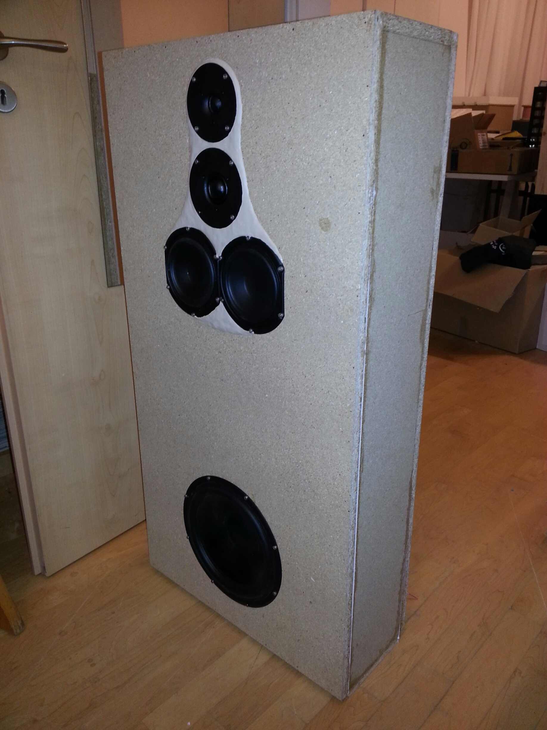

There are two reasons for a double tweeter arrangement :
First the bigger Wavecore is beaming at higher frequencies.
Second the bigger wavecor is working in the most sensitive region of the ear so we have very little moving mass there.
0.4g instead of say 15g in a conventional midrange.
I also expect less doppler and intermodulation distortion from a 4 way.

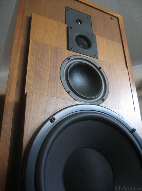

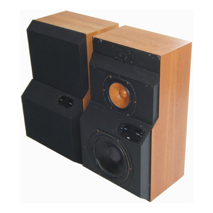

Maybe i phase aligne the drivers like this :Pin by Holger Barske on Audio Krempel I like | Pinterest

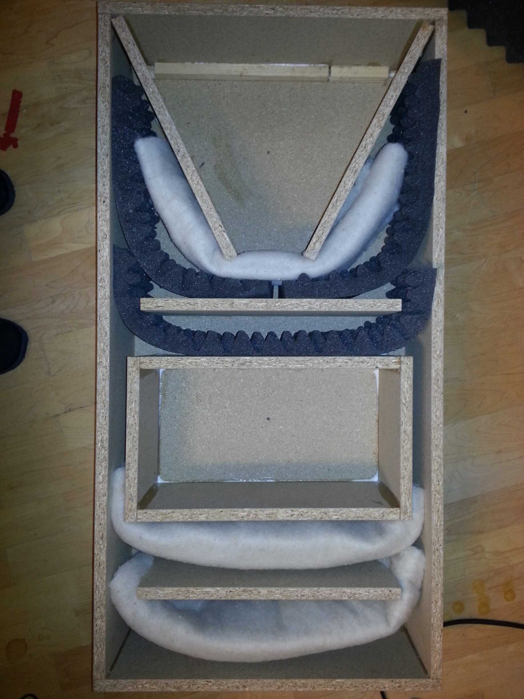

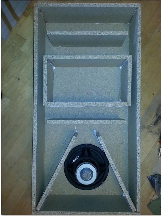

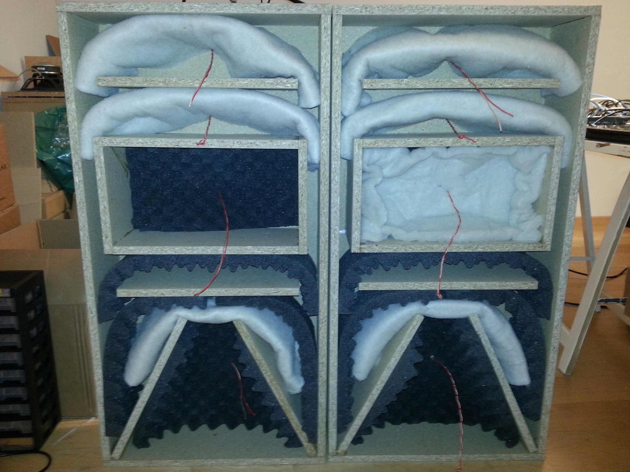

The boxes are damped and one box got the drivers. I can make a crossover now.

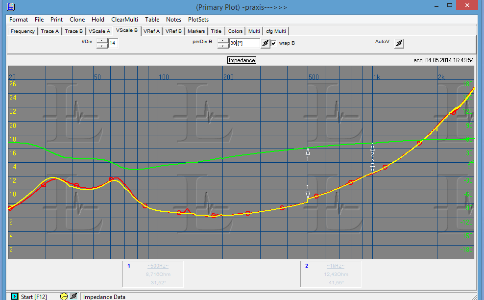

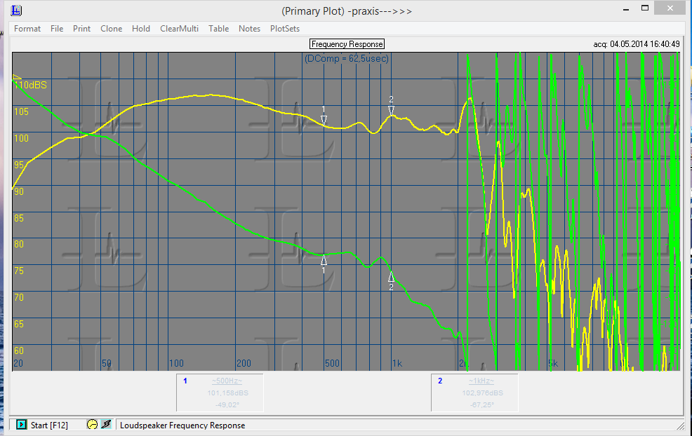

I measured the woofer. Instead of one main resonance there are actually two well damped peaks. That must be the cambers inside. The good thing is that under 50Hz there is still energy down to 32Hz although as a shelf. Also the phase angle of the impedance in the bass is very low so this woofer is easy to drive.
I did multi chamber systems like that in the 80th so i knew that something similar will happen.
- The Quintessentially German Loudspeaker of the 70th. Modern Interpretation.
